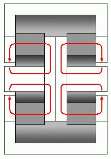

Get a a pair of identical drivers and make sure the rear polepieces are nice and smooth so they make good contact. Then you have to put a steel (ideally tubular) polepiece from the periphery of the one front polepiece all the way to the other.
The idea is that both the magnet systems are in parallel but the voice coils are driven opposite phase so while one magnet is having it's field pushed one way the other magnet is getting the opposite treatment. The external polepiece transfers this rude behaviour across from one side to the other and hopefully the nett effect is zero.
(See my addition to your drawing)
Interesting idea, but I'm not so sure it will work as you hope. Though the drivers are back-to-back and their top plates are bridged with a magnetic pathway, still there is only a little magnetic coupling between the two circuits--they'll operate largely independently. Perhaps there would be some benefit, but even though the two motors could share some flux, each energized VC will still be trying to reverse its local B field.
OTOH, maybe it would work better than I'm imagining....
Not sure if we are talking about the same thing because I don't really know what a B field is. 😕 If both the voice coils are moving outward or inward at the same time then I imagine what you say would be so, but if they are both moving to the left or both moving to the right as in an isobaric setup then I still get this warm cozy feeling about the whole thing. 😎Bill F. said:Perhaps there would be some benefit, but even though the two motors could share some flux, each energized VC will still be trying to reverse its local B field.
Sorry for the jargon... The B field is the flux across the gap, the B component in the force equation F=BLi.
I think I see what you're shooting for here, but I fear that no matter how the VCs are energized, the two magnetic circuits will still tend to operate independently without much mutual benefit.
As I perceive it, the bridge between the two circuits is a largely unused magnetic pathway. Only weak leakage flux typically projects from the outer perimeter of the top plate, and linking two top plates of like polarity will result in no real flux flow, even when considering the coil fields. The coil fields will still try to reverse flux through their local magnets.
I think it's the use of two local circuits that's the weakness. The cornerstone of the Differential Drive and Flux Fulcrum concepts is to pit two coils against each other in a single magnetic pathway, so the net effect on the magnet's flux contribution is zero.
However, I do think your design is clever thinking, and I allow that I may not be giving it proper consideration...

Bill F. said:I also have another design that incorporates coil inductance cancellation, if you can picture that. 🙂
It would be interesting to compare this with a standard topology driver in terms of Barkhausen phenomena.
Is this what is used in the Manger (www.manger-msw.com)? If you go to the English version an then to the "research" menu, there is a talk Daniela Manger has given to the ASA. From this is this excerpt:
"The presented bending wave transducer, which is protected as Manger Sound Transducer,
has an electrodynamic motor working with two voice coils on one layer. Mechanical in serial
operation and electrical in parallel it is possible compensating for emf which is generated by
the voice coil movement. The inductivity of the voice coil is 18µH, about 1000 times smaller
than a conventional voice coil inductivity. The total weight of the voice coil is only 0.4 g. By
this specifications the influence of the motor is only resistive in the interesting frequency
range."
It looks a lot like the Adire XLB^2 motor, with to voice coils situated at the top and bottom edges of the gap. However, the ridges that concentrate the field to the top and bottom in the Adire concept are missing. Also, the winding sense and wiring may be diffent in the Manger. I have yet to find the time to understand how it cancels the VC inductance. I have downloaded the German patent applications from the early 70s, but have not had time for a careful reading yet.
I don't think that it actually cancels anything. But the following physical/mathematical properties of coils may be in use:
If you parallel two coils of same Inductance you end up with half the inductance.
If you half the amount of windings you end up with a quarter of the original inductance.
If you do both at once (which I assume Manger is doing) you will end up with 1/8 of the original inductance.
Regards
Charles

Looking at the physical size of the pole piece, and even considering the short winding height, it seems like a 2-3 orders of magnitude reduction was achieved, so there must be something else.

Does anybody have a drawing of the JBL differential drive magnet structure? I have googled and only found an article devoid of figures. Apparently, the use two gaps of opposing flux, which would seem to make for a very interesting return system design.

The Manger design is essentially - reverse of XBL - 2 and a far easier approach
as machining the ridges in the xbl - 2 motor structure with 1008 soft steel - involves cnc lathe machining
(though possible as oem any extreme design here in India even in small numbers anyone interested contact me ! includes hydrogen annealing )
it is the same principle of either a +ve or a -ve excursion from rest position will result the coil entering the same magnet field area - keeping the ratio of BL at rest position to the limit of x- max same / therefore the astounding graphs of BL linearity - in the klippel tests of these drivers !

Hi
Ciclotron -
nice idea - another approach to an active / semi active - inductance linearity set up is
the Alumunim shorting ring - embedded in the motor structure is shorted by a wire (soldered to it - taken out of the back plate of the motor stucture) - and grounded to the - ve terminal of the driver

Ciclotron -
If I was any good at dismantling and re-assembling a loudspeaker, an experiment I would love to try is - count the number of turns of wire on the voice coil and then wind this same amount of turns in antiphase on the centre polepiece right down away from the voice coil. Then put this winding in *series*with the voice coil.
Suranjan Das Gupta
