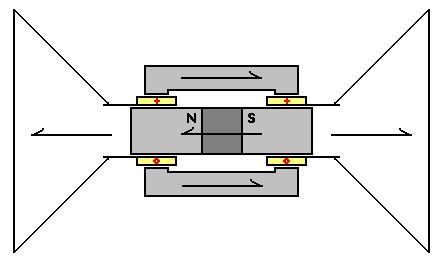

Here's another exception from the musty files of my transducer-design archives: a siamese-twinned bipolar driver topology I originally called Flux Fulcrum.
Two horizontally opposed VCs/cones share a twin-gap motor. Their net field deflections cancel, and you don't lose any efficiency.
I also have another design that incorporates coil inductance cancellation, if you can picture that.
It would be interesting to compare this with a standard topology driver in terms of Barkhausen phenomena.

Oh Bill ya Big teaser!Bill F. said:...I don't think you'll have much luck finding a Flux Fulcrum out there... AFAIK, it's my own original design, and I never manufactured any. Sorry if I wasn't clear in my prev. post.
I think as this design as has 2 cones it would have a a good LF output, I try and make one to see what happens, how the hell do i join 2 cones to one bobbin with 2 windings in a open magnetic system?
That would be an interesting design for dipole applications...
Well, you'd have to put it in a Linkwitz Phoenix-style baffle to make it into a dipole...
It is necessarily a push-push bipolar radiator. If you swap phases on half of it to make it a dipolar radiator, you lose the whole Flux Fulcrum effect. You'd basically have an open ended Differential Drive topology.
As a bipole, at least it'll have no baffle step.
I don't have a patent or anything, so Godspeed!
I always pictured it working best with a larger front-mount ring on one end and a smaller rear-mount face on the other, so you feed the driver through a larger hole on the front of the cabinet and butt it up to a smaller hole on the rear.
Shouldn't be too difficult to create the motor. Just have to figure out the easiest way to suspend the pole in the gaps--maybe make it in two halves and bolt it together.

Ah, didn't realize at first glance that the cones weren't directly coupled and were in phase instead of out of phase.
Well... if bipolar is your thing I suppose this would be nice. Though subs don't generally benefit quite as much from the SOTA low distortion driver technologies (well, the numbers benefit just as much if not more than midranges, but the audibility of improvements is diminished in that frequency range), this would at least make an interesting opposed force dual sub driver mounting.
Or is it a single sub... ?
Yeah, I agree the Flux Fulcrum would likely be over the top for a sub. I don't know for sure, but I suspect Barkhausen noise would manifest somewhere above mid-bass, if only because our hearing is more acute there.
I actually conceived this bipole driver to be mid/wide-range. Bipole mids can be a slick answer to several monopole shortfalls like baffle step and falling power response. Some also claim unsubtle improvements in diverse points of enclosure radiation, imaging, etc. from the newtonian force cancellation of solidly coupled bipolar drivers.
But if you're not into bipoles, there's always the counter-current trick, but it'll cost you about 3dB. Still, it's certainly the easiest way to do a Barkhausen A/B comparo.

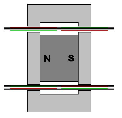

I just realized my previously posted pic is a flawed early concept drawing of my Flux Fulcrum design. It's been a while since I came up with this concept, and I briefly forgot the conclusion to my own thought experiment! Though the driver previously pictured would operate with opposing newtonian forces, obviously it would tend to deform the B field just like any other common driver since the coils are wound in the same direction--Duh!
So please disregard the previous pic and consider the one below instead--it's what I meant to post before. It's a bipolar motor that functions like two superimposed Differential Drive motors. Part of my design goal was also to achieve rising motive force with excursion by harnessing the attractive forces between concentric coils wound in the same direction. This might be matched with a suspension of corresponding rising rate to net a constant signal/excursion ratio.
Another obvious point I failed to remember in my earlier posts is that the Differential Drive topology (JBL is a licensee) accomplishes inductance cancellation by driving two antiphase series coils. So IMO it would theoretically exhibit substantially less Barkhausen distortion than a garden variety motor of identical specs.
Because of their reduced flux modulation, I have also wondered if balanced topologies like countercurrent, DD, Flux Fulcrum (and perhaps current-source-energized field coils, though not balanced) exhibit noticeably less dynamic compression of the leading edge of heavy transients--likely much more audible than Barkhausen distortion.

Bill F. said:Ok, I feel more than a little dumb.
So please disregard the previous pic and consider the one below instead--it's what I meant to post before. It's a bipolar motor that functions like two superimposed Differential Drive motors. .
Dont i feel silly, i showed your design to my friend Henk Vos and he told me this would not work, I put the points made by you to him and got upset with me! He is an old gent with a short fuse! and i was in the blast zone, looks like i have to apologies now, oh God Bill, you better by me a drink one day !, I had a feeling i was wrong but my big mouth just kept on yapping, I understand the whole concept now! round 2, and if i come back with a bloody nose again you owe me 2 drinks Bill,
Sorry to pull you into my web of absentminded deceit, 'dise!
I hope you're able to mend the rift with your ol' pal, but he may not like this version, either--it's pretty "out there."
P.S.--the previous version would indeed function, just not with the balancing fields as advertised.

I lay awake in bed last night thinking about this and came to the same conclusion! I think it would still work though if instead you phased the drive to the two coils so the cones worked as an isobaric pair. Not clamshell method but butt-to-butt method but with no butt.Bill F. said:Though the driver previously pictured would operate with opposing newtonian forces, obviously it would tend to deform the B field just like any other common driver since the coils are wound in the same direction--Duh!
Not only that, I think I know a way where you could try this out using a pair of conventional unmodified drivers and a small amount of external polepiece trickery. I'll get busy and draw a picture...
Here we go! Get a a pair of identical drivers and make sure the rear polepieces are nice and smooth so they make good contact. Then you have to put a steel (ideally tubular) polepiece from the periphery of the one front polepiece all the way to the other.
The idea is that both the magnet systems are in parallel but the voice coils are driven opposite phase so while one magnet is having it's field pushed one way the other magnet is getting the opposite treatment. The external polepiece transfers this rude behaviour across from one side to the other and hopefully the nett effect is zero.
