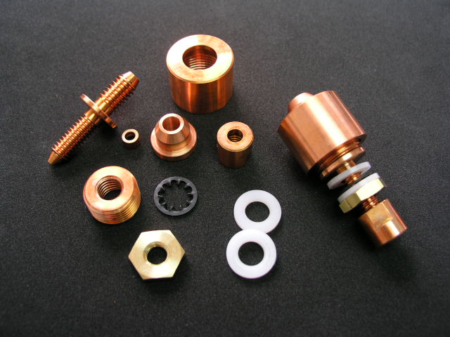

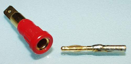

DIY tube sockets
On the picture below You can see on the left a socket and on the right the correspending plug. Both are of the same type basicly - just of different size. Those kind of sockets are avaiable in various sizes (4mm, 2mm, 1,3mm and down to 1mm & even somewhat smaller and without the plastic insulation piece) and also with this kind of spring arrangement as from the plug shown on the right - only reversed constructed and inside the socket.
They are avaiable for about 50 (Euro) cents from every better electronic component provider and IMO are excellently suited for DIYing reliable tube sockets.
Material mostly is gold plated brass or other hard copper alloy sometimes.
With a piece of Teflon or whatever heat resistant (drillable) socket material of Your choice and a drill press as "tom1356" mentioned (those sockets are designed to press in as they are corrugated (?) on the outside) it should be not too difficult to do.
Never done this with a tube socket but DIYed sockets for a (also DIY) 12V low-voltage 50W (4A) halogen lamp as contacts of the readily avaiable ("high-quality") ceramic sockets for that purpose failed repeatedly (they simply burned away) after a week or so (and the lamps have died also very quickly). With my DIY sockets that problems have dissappeared immediately and I have no problems since 2 years anymore (and there is still the first!! lamp after that installation).
Well, halogen lamps is not tubes but at least this shows it would be possible to make DIY contacts which can resist high temperature while conducting quite some current (heaters) and which can be very reliable.
