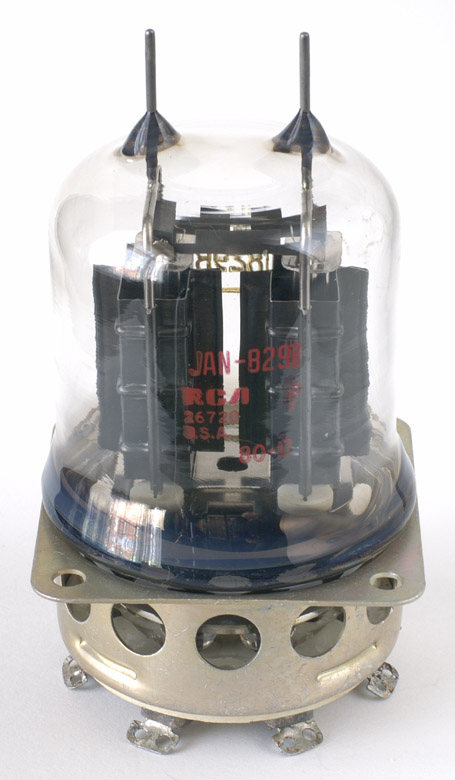

hi all,
i think the most important is the contact pins that can best contact or not. I agree that china made is not ggod. If U want I make a choose, i will choose NOS EF Johnson ceramic one or expensive Japan made telfon/The high stardard telfon & the pin use solid copper to raw the sharp with 24K gold plate. the pins was a cone sharp.
I feel that this is good but $$$$$$$.
thanks
Thomas :bigeyes: :bigeyes: :dead: :confused: :clown: :scratch: :idea: :goodbad:
I occasionally use ceramics, but mainly use old NOS bakelite sockets, simply because I have them available. I've never had a problem with the quality of the contacts, but one rider I would say that if you are using these type of sockets in experimental circuits using octals or loctals in which you constantly change the tubes, they are physically more likely to break down.
I used to have some old computer panels from an early tube computer, and these had double triode type tubes soldered directly into the panels to improve electrical contacts.
hi bournville,
I think U say the old tube computer is the old we or hp old computer or the old telephone building or cinema use. Certainly they were very good.
i give U see one item for PX25 use. Its made by in company call Emerson Radio & photograph corp.
Its prefect contact. i & my friend like it most.
As U said U use NOS socket. They were best, I feel that the quatity is better than the new one.
thanks
Thomas

EC8010,
While the ceramic is nice, those pins are the absolute worst! The clips that make the tension are so prone to breaking or falling off, that you night as well use alligator clips.
And who of us doesn't like to swap tubes every so often to hear differences or just to customize the sound with the music or mood?
All others,
My personal favorites... not for nostalgia... are the Amphenol brand bakelites... brown in color, not black, especially for the four pin 300Bs. Again, that is because of construction quality, strength and pin quality. There is a brand I got from Angela Instruments called QQ. They are very decent also.
The only ceramics I have gotten worth the 3 bucks each are from Uncle Ned (Triode Electronics) with gold pins. I would love to use ceramics all over because of their high voltage dielectric quality, but if they would only make decent pins...
Every other ceramic socket I had tried had horrible pins.

I think we may be entering personal opinion territory here. I like the look of those contacts, and I am told by those whose opinions I respect, that not using those contacts causes problems when the valve is used for its intended purpose as a 2m (144MHz) transmitter. So far, I've only had contact problems on nasty old phenolic-based B9A sockets. (I don't mean NOS sockets, but the ones on 30 year-old kit.)
