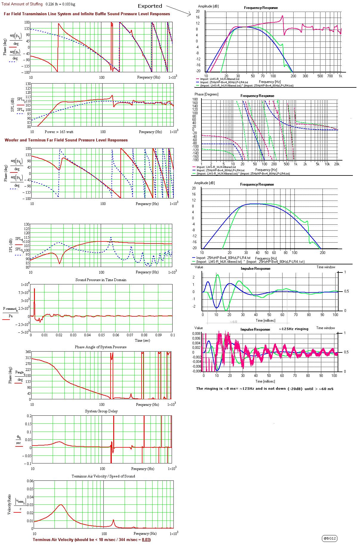

FWIW:Here's a real bad CAR? BR example to be avoided that show severe ringing if not the entire box and the port partly(effectively ~47")are stuffed.
I didn't posted this to a thread a few weeks ago as there was to many wacky comments on why a very similar box didn't perform well..

Isn't that ringing occuring way above the passband that car audio subwoofers are normally used in? They're typically cut off @80 Hz, if not lower.
You're right In a car the ringing is near blameless levels and would in most noisy cabins be masked but if in a quiet room with a picky listener, (Me of course 😱):
The ringing would be recognized as when XO:d at ~80 Hz(I prefer lower) this ringing is ~20 mS to long (~43 mS = ~15m) is where I set my 'Distance cue arrays to JND and I do not like attention(amplitudes at higher levels but less than ~105 dB) from a sub that pops out and tilts my central phantom spread more than necessarily.
Remember that the ringing(coloring) would be outside of BER 1,thus extremely easy to be heard when long in lime.
b🙂
PS: Submitting a picture using IMO absolute minimal damping ( A ~100g batten behind the driver magnet on the internal rear wall side:

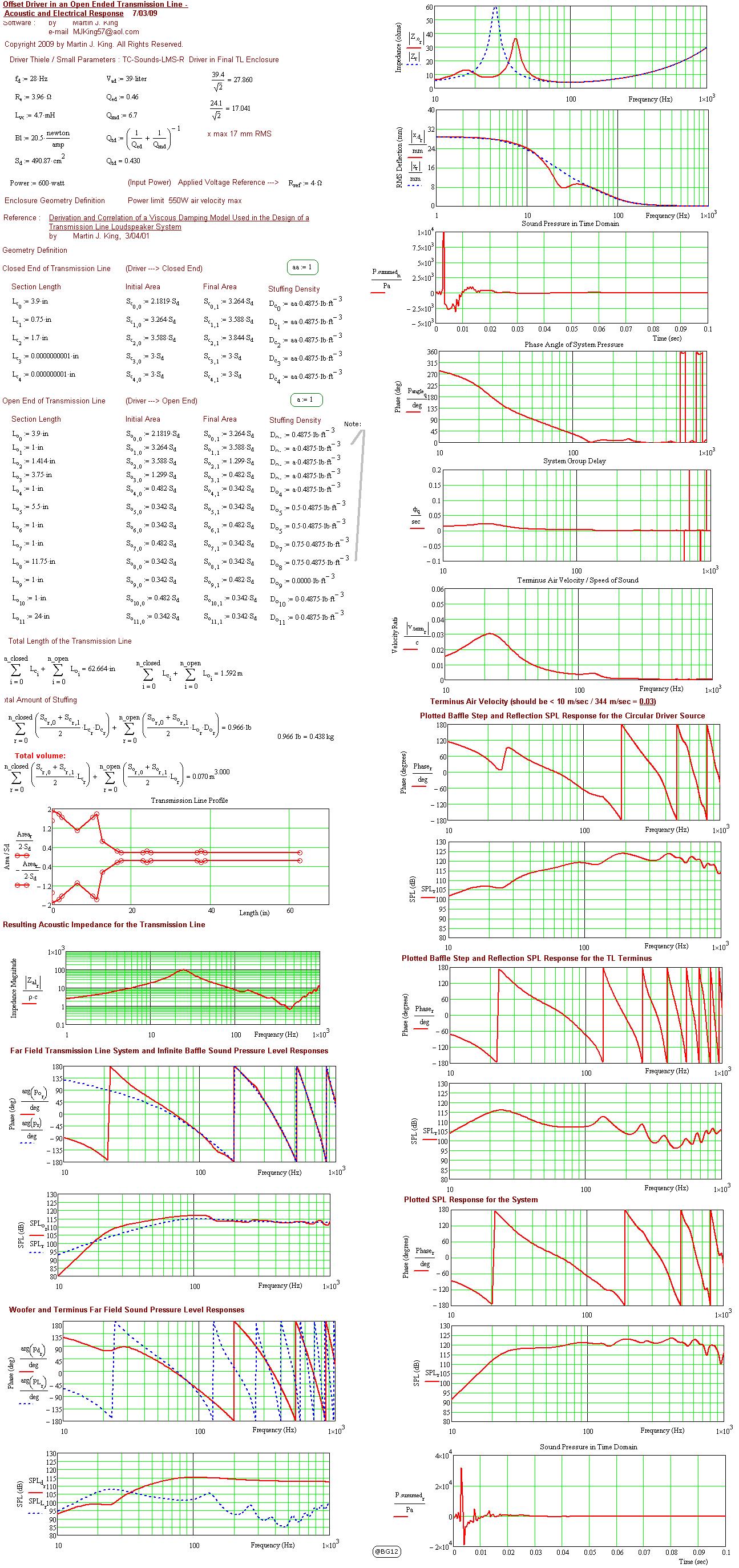

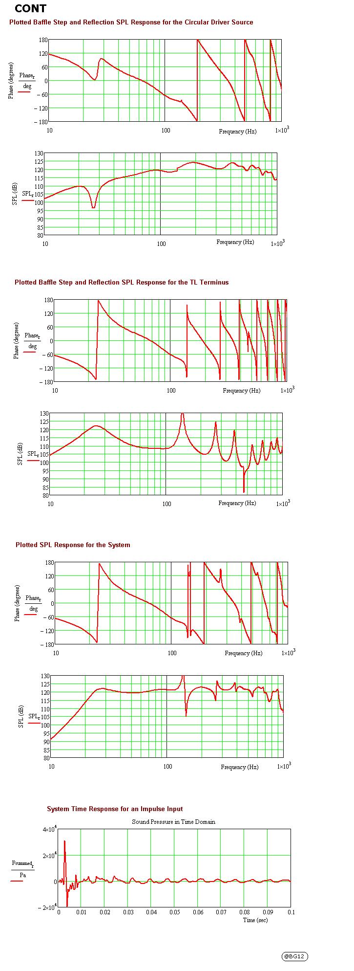

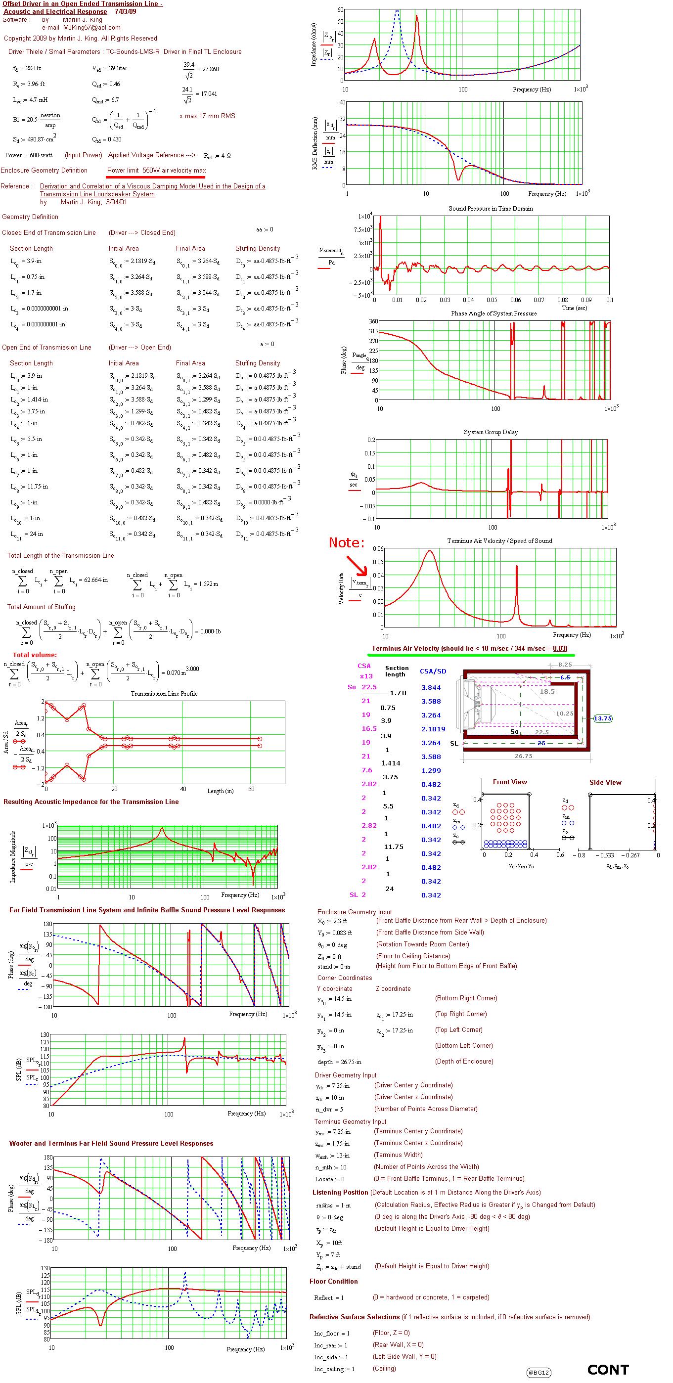

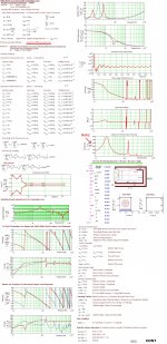

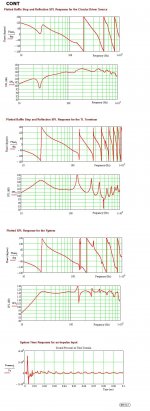

Bjorno
What software did you use to generate this printout?
Thanks!
Bjorno
Thanks!
Hi, In that picture: All calculations are using Mathcad and the simulations are MJK:s quarter-wave Transmission-Line programs.Visit:
