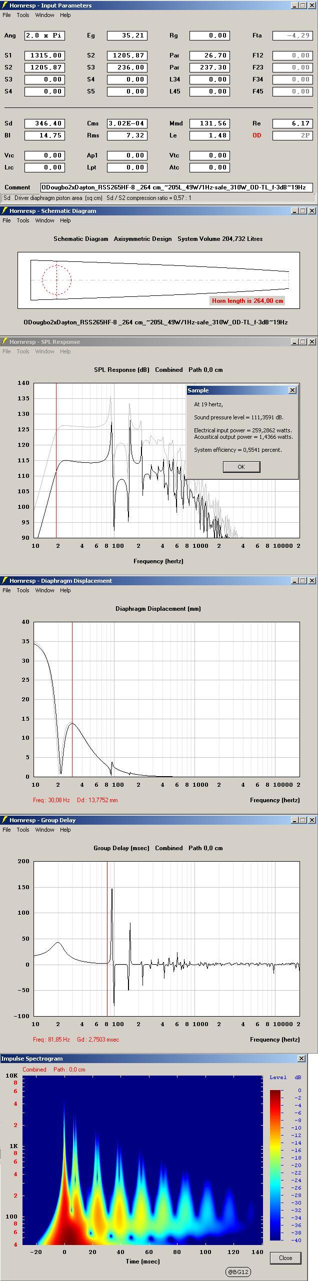

If you single fold the T-TQWT you should stuff..'your/this design'.. evenly(constant density) using a weight of ~ 0.8 lb damping material, but if you intend to add more folds:
Use lesser stuffing= ~0.6 lb and taper the density 'linear' towards the terminating end where the density is ~ half of what you started with.
Have a look at the profound effect when adding stuffing material:
Submitting a MJK simulation which you can study, i.e. an actual T-TQWT will inherit ~ the FR and Phase above ~80 Hz.
XO at ~90 Hz(LR2-LR4) if targeting a 80 Hz XO or use the Mains somewhat overlapping the sub (Sub XO set at ~80 Hz), I prefer the latter method.

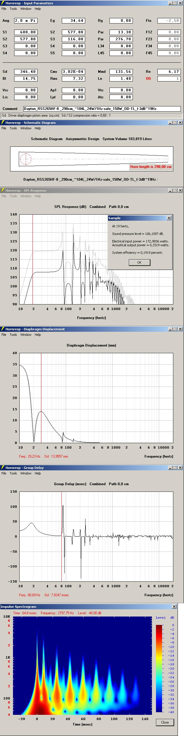

20.100? No problems 😀 :

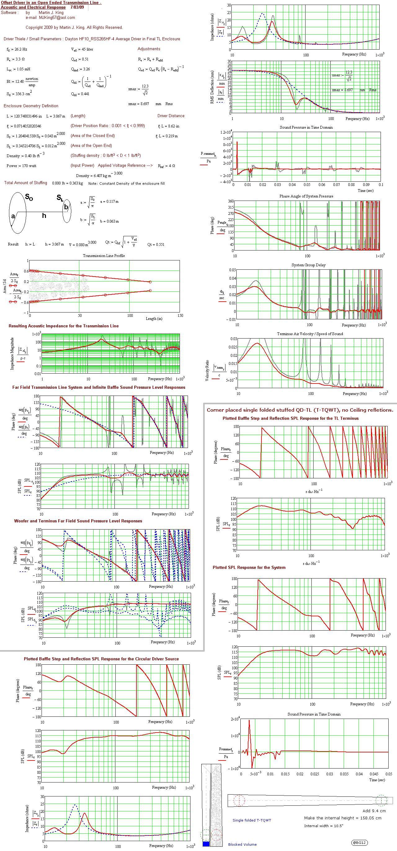

Have no idea..box program? for what? No Rookie guff box program can handle a TL or a T-TQWT and is totally useless whenever there is quarter-waves involved and tapered enclosures where the drivers/terminating ports are placed in offset.
I designed an TL using dual 8 Ohm drivers that would use an internal height of ~52":

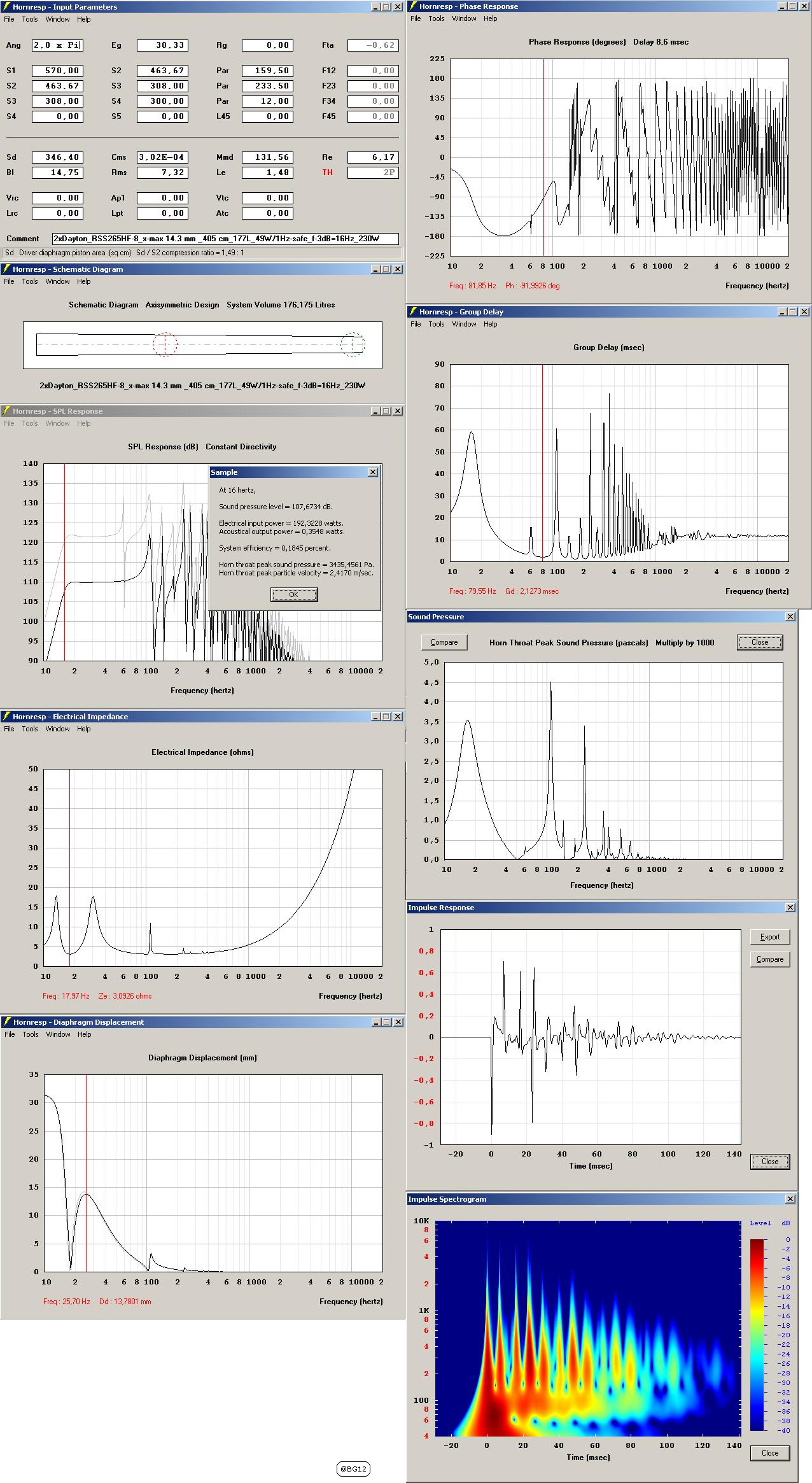

I calculated with an internal width of 10.5" for the dual OD_T-TQWT in post#33 and also for #35.
Submitting: IMO:A better OD-TL than in post #35:

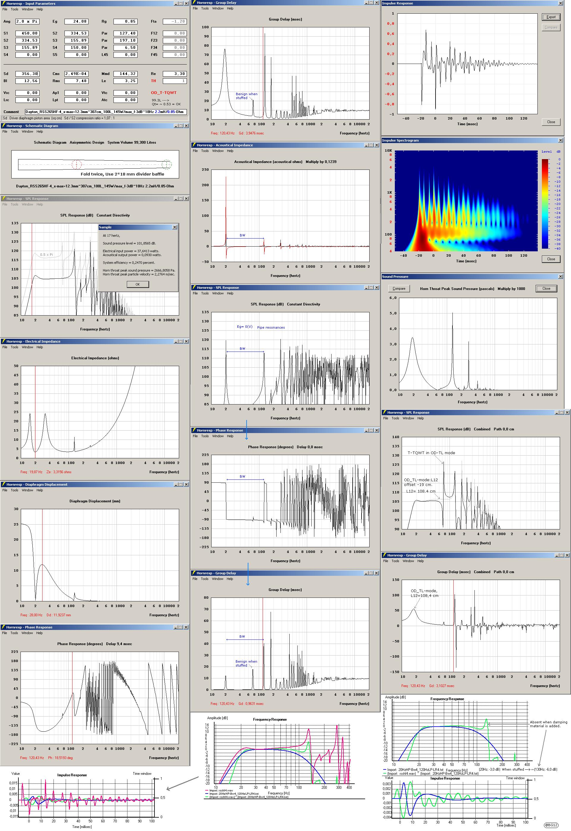

Yes, Thats a good example. You can also move the terminus(port) to the driver side but this implies an extra fold as the driver would move down a bit and the new port location would be close to the driver front-side.
A TL is very forgiving when it comes to dimensioning: If the line length or CSA:s are off an inch or two,it wont matter as the exactly amount of stuffing material can be used to tune the TL for the target 'fb'.
