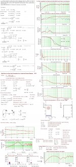

I don't have access to Bass Box Pro anymore. Something like this look good for this driver?

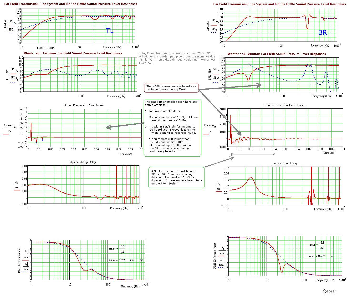

IMO, The closed box is OK but the ported box would have port severe issues.
A TL would be a much better performer when placed at floor level, near a room corner.
b🙂
Placement is dead center of the back wall... about a foot off the wall. I'm a fan of seaed boxes but I kinda want this guy to go a bit lower than the sealed box can do. If I make the sealed box bigger will the F3 drop?
I doubt it would be audible. My 10" HT sub is vented at a lower Fb with a smaller diameter, but flared, vent, and you really have to crank it, and be playing ONLY a tone at or near Fb, to hear any noise. Previously I had it tuned to 30 Hz with the same diameter flared vent. Again, no noticeable issues with music.

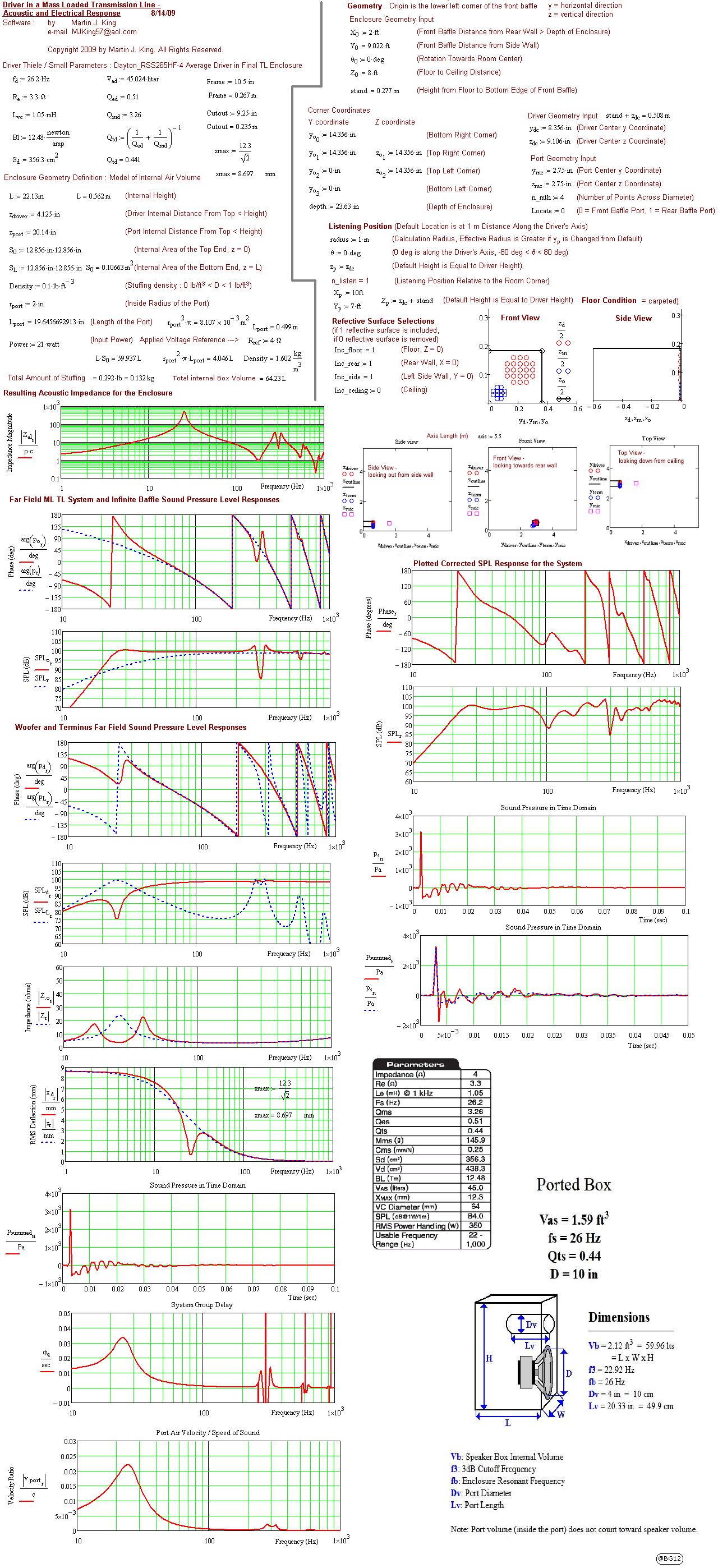

Hi Brian,
I guess your BR is a different animal as tuned lower but this one, with the suggested 1:5 port diam./length would IMO sound bad... like many commercial subs or tube-like long ported car-subs Ive heard (when the Car-engine is off) with a distinctive port resonance artifact that only disappears at a low SPL volume.
I find this very annoying but don't mind when distortions 2:nd and 3:rd artefact's appears, with the volume knob turned up( If to loud just turn the volume down when sounding too harsh), and falls within within BER 1, i.e. musically fused.
When port resonances appears outside the passband in Critical Band BER2 or in ~BER 3 at a too high level its always heard separated, ..annoying, IME even at lower listening SPL with Music but may for HT use be blameless.
Here is a simple test anyone can do using a good closed sub box (f3< 40 Hz) XO = 12dB/octave min at 80Hz.. to 120..145Hz 24dB/octave:
Add a 2-3 dB third octave bump(or even a deeper dip) at 60-70 Hz. Play a Recording you are familiar with.
I never hear any difference..if the listening level is at a reasonable SPL. Sound coloration can only be heard when the Peak (dip) is made broadband . If switching over to a design with resonances:
The hear-ability is IME very different when in additional adding a resonance(s) to the in-band bump(s) >~90-100 Hz away(above the limit for a Critical BW):
The ringing tendency remains even if trying to use a steep LPF XO, IME all speakers showing quarter wave resonances can only be cured with aid of adding damping material.
Sound coloring in resonant un-stuffed enclosures is soon occurring as music is dynamic in nature.
The impact from the resonance can pop in and out depending on the probability of energy level of the resonance frequency or caused from other nearby frequencies that are triggering the same phenomenas.
The effect of simple FR amplitude anomalies is much lesser than from pipe resonance(s) and especially when the resonance amplitude decay time is long..as always are for long ports with no sufficient stuffing in the airways path.
To be effective the damping material must reach into the pipe and not only in the main box volume or to be as well damped as TL:s/T-TQWT:s or T-QWP:s are immediately provide an energy sink for sustaining resonances.
Note: The culprit is not the tone itself that if below a certain level would always disappear if having in the enclosure a decay-time-duration
<= the source signal decay).
b 🙂

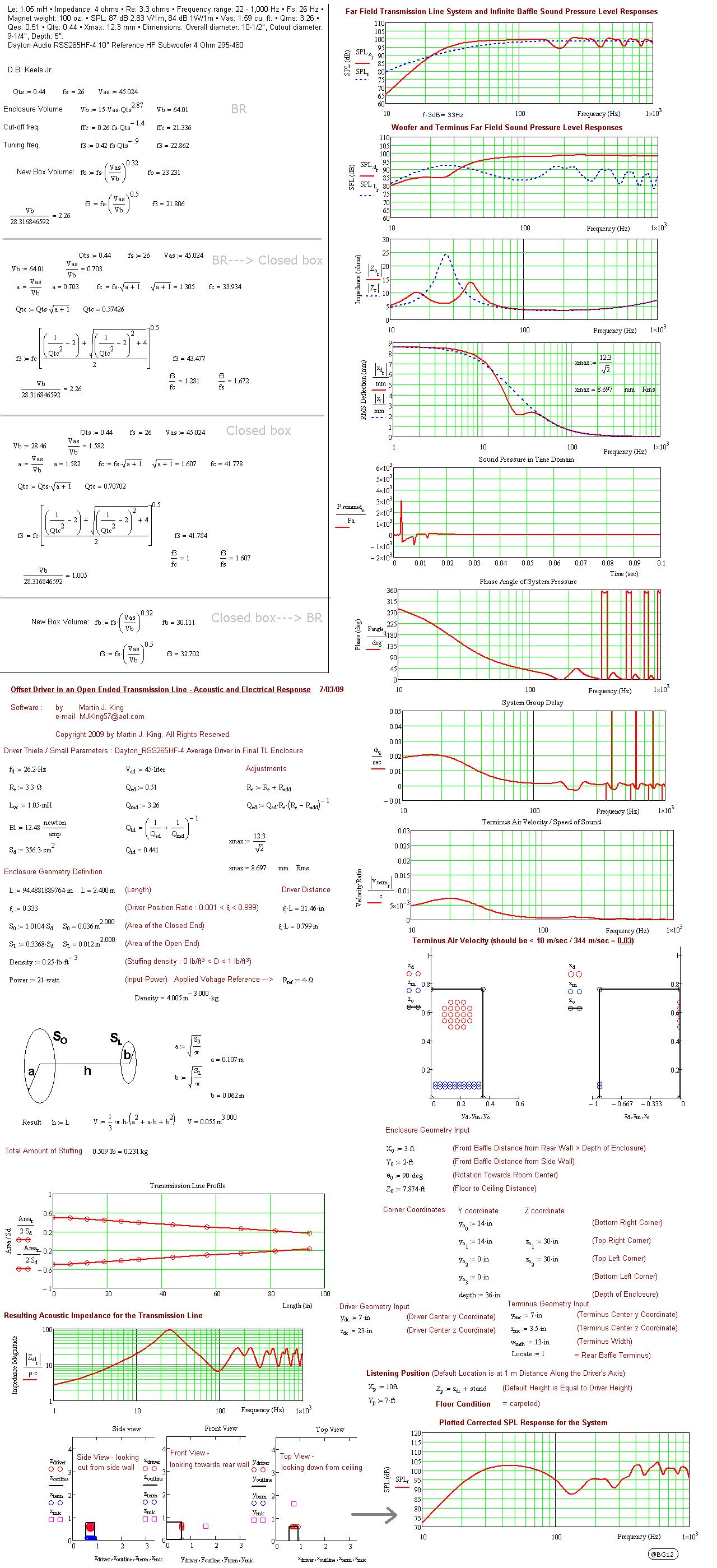

PS: Adding simulations to back up my arguments..The OP suggested BR is not a design I would suggest to anyone to build.

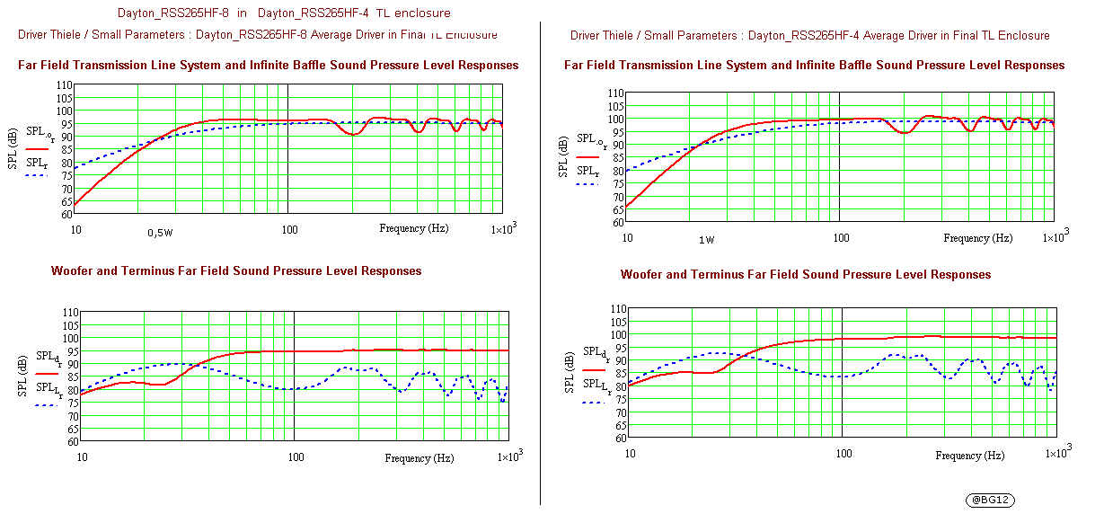

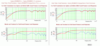

Hi ODougbo,
I guess perfect. Submitting a quick sim where the RSS265HF-8 is compared with the RSS265HF-4 using the enclosure in post#9.
b🙂

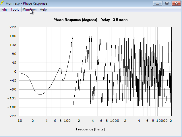

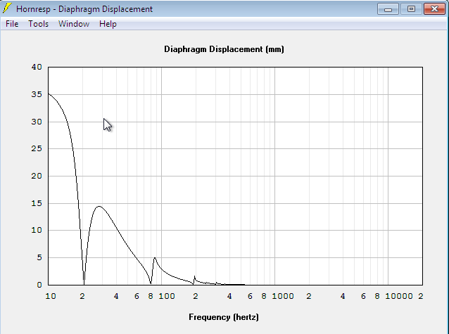

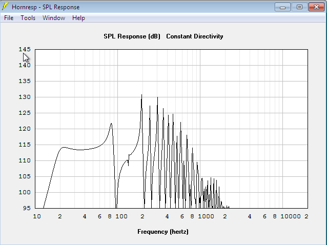

Well, I'm certainly not an engineering type, but I have downloaded myself a copy of Hornresp. I bought myself a pair of RSS265HF-4 10" Reference HF drivers a little while ago thinking I would put them both in sealed boxes to smooth out room modes and then build myself a big t-tqwt to cover the bottom octave. I'll probably still do that, but I couldn't help downloading hornresp, just to test the water. Anyways, this is the first t-tqwt I've ever tried designing so I'm sure there are some issues... still looks promising though. 20Hz-80Hz @ 114db without exceeding x-max. 200 watts. I'm open to criticisms from any real engineering types...

Is that a down-firing port?
That response looks impressive! might have to take a look into this myself...
But what about the phase response? how does that look? If I look at the frequency response I suspect some major phase wrapping with very steep angles..
Edit: Typo, yet again..
