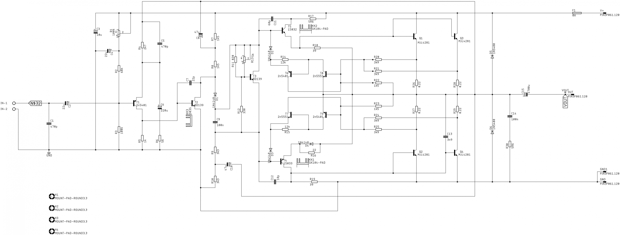

Bailey 30W, which can be upped to 50W using 2N3055/MJ2955 outputs, or higher power (MJ802/4502 even). would suggest not using TIP3055/2955 nor MJE3055T/2955T at this power level unless parallelled.
Similar to TGM8 but - fully complementary output, no Miller compensation. Wireless World 1968.
Distortion may be improved using KSA1381 rather than a BD140 in the pre-driver stage (which is a transconductance not voltage amplifier - should be TAS not VAS!) BD139-140 drivers ideal. Cascode can reduce distortion significantly with BD140 but does need a Miller "nudge" or alternative to stabilise.

TDA1521 works fine from single rail, provided you don't mind cap-coupling your speaker, though its output current is a little limited. TDA8947 will deliver up to 30+30W in BTL into 8R.
I compared MJR7 and H-ENG amp in LTSpice (power supply +60V, ideal/regulated)
H-ENG
Output idle current = 3mA (bipolar)
GAIN = 26.6dB
LG10k = 102dB
THD10k 39W/4R = 0.0008%
PSRR 100Hz = 111dB
NOISE 20-20k = 20uV
Clip +27Vp -27Vp
MJR7-Mk5
Output idle current = 100mA (mosfet)
GAIN = 25dB
LG10k = 69dB
PSRR 100Hz = 90dB
NOISE 20-20k = 40uV
Clip +23Vp -21Vp
H-ENG
GAIN = 26.6dB
LG10k = 102dB
PSRR 100Hz = 111dB
NOISE 20-20k = 20uV
Clip +27Vp -27Vp
MJR7-Mk5
GAIN = 25dB
LG10k = 69dB
PSRR 100Hz = 90dB
NOISE 20-20k = 40uV
Clip +23Vp -21Vp
