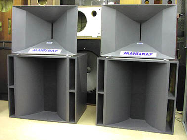

If you'r going for Altec . The 817 cabinet for mid bass.
The M94 Mantaray Horn with GPA 399 Driver.
That covers 200 to 15K perfectly.
You'l need a sub.
You might need a Bullet tweeter.

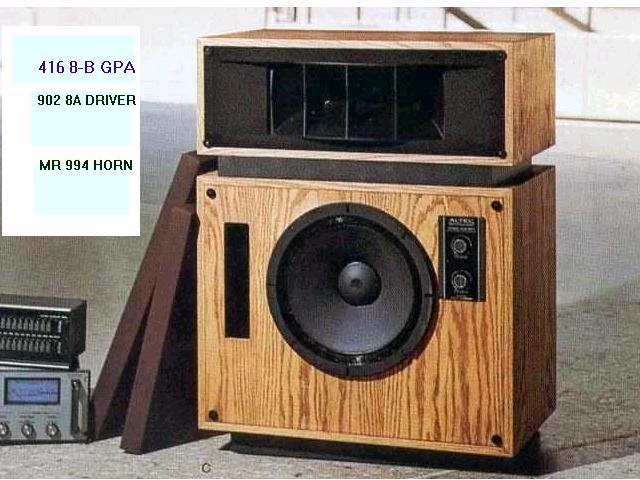

Considering the size of your room. I yould recommend Altec model 19.I had no idea of the size room you were talking about.
The components in model 19.
416-8 C or B woofer
511B horn multicell.
900 GPA DRIVER SERIES
xo N1200

The Altecs I just bought are 421-8LF’s.
The model 19 I see is a bass reflex – I could build a BR myself.
My apologies, I got the idea from your post of buying a pro midbass *horn but I forgot to say midbass *horn.
One with a flare about 60 – 90 Hz. What are the good options for that?
The 421 8lf will fit with Altec Bass Horn cabinet 816-A
FR response inside cabinet 50 to 1000HZ
101 DB 1w/M
distribution 40X 90 degree.
The 816-A is a single driver cabinet.
How many 421 do you have?
