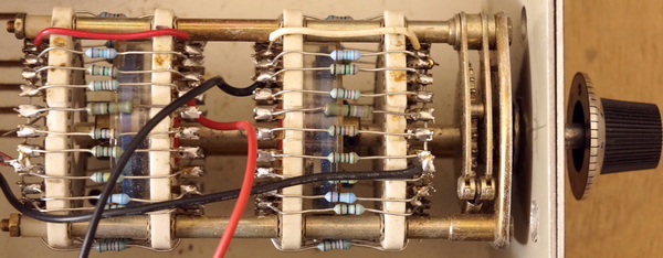

Potentiometers have become hugely expensive, apart from the old carbon types. What would members recommend for typical audio pre-amplifiers (eg: volume & tone controls, etc) ?
I would be looking for low noise, long life types. Are wire-wound pots 'over-kill' ? thanks for any comments/advice
When the load of the cursor has a high impedance, high quality pots are not needed.
I made a 30 positions stepped volume control using a rotary switch which was of the break before make sort. It does not act as a potentiometer but as an attenuator. The lower resistor (connected to ground) is of fixed value (around 300 Ohm) and there is only one resistor connected at a time in the upper section (bar a high value resistor around 1 MOhm from the input to the output). So there are only two resistors in the signal path. Electronically, it is probably the best circuit but the stepped interface is not as comfortable as a continuous good old rotary potentiometer having a nice attenuation law.High end microphone pre-amplifiers use:

I am very happy indeed with the 41-step series attenuators sold by Acoustic-Dimension in NL. Not exactly cheap but - to my ears - vastly superior to Alps pots (either blue or black).
this type of attenuator can become very noisy in an area close to transmission towers. It is a real antenna!
