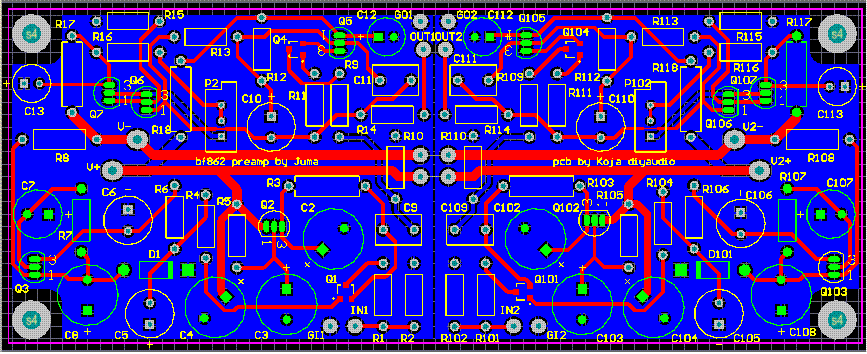

pcb for Juma's little preamp

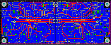

here comes the pcb for Juma's pre based on bf862 (I added the buffer too). the layout was subject to the following constraint: two pcbs will be stacked up on top of each other (for 4 channels total). this with only an inch long spacers and the top pcb will be flipped so they will be facing each other 🙄. this is why all the tall components like caps etc. are close to the edge so when mirrored they do not collide with those on the other pcb. it was not all that easy but looks Ok right now. I will be making manufacturing files and ordering soon. In the Fall I can probably tell you how they sound with an F5 and with an ACA, (have some speaker work to do first 😀).
I did the copper pour for the grounds, all one within a channel, no separate signal ground. I hope that's Ok?
also, Juma: Do you think the gain could be raised by 2-3 dBs? (which would allow use of 2x4 miniDSP with only 0.9Vrms outs). Currently it is 9dBs which mandates using a 2x8 XO which comes with 2Vrms outputs, and I am planning on bi-amping only. Thanks a lot!!

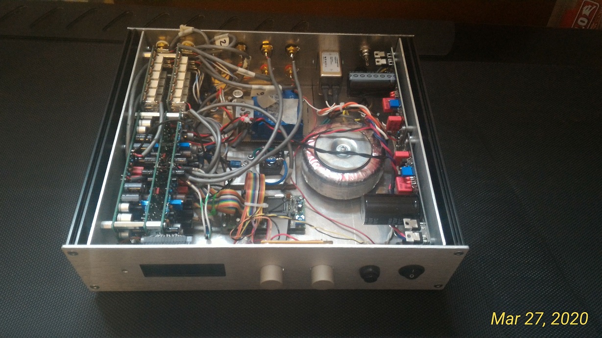

never got to post the pic of my 6 channel bf862 pre with Salas reg PS and Dantimax relay volume control. The only thing I overlooked was how many shielded wires one has to deal with in a multi-channel preamp. I started with 8 channels and then decided to save one 2-chan board as I did not really need it and the package was hard to manage. Just the number of shields to ground to chassis was overwhelming.
Question for Juma: I am thinking of making another 4-channels of this great preamp. I checked my stock for parts and I am short of one BC557C. the BC557 is no longer available in C rating so I got some BTF version. Is that significant if I substitute it in one channel? Thx.

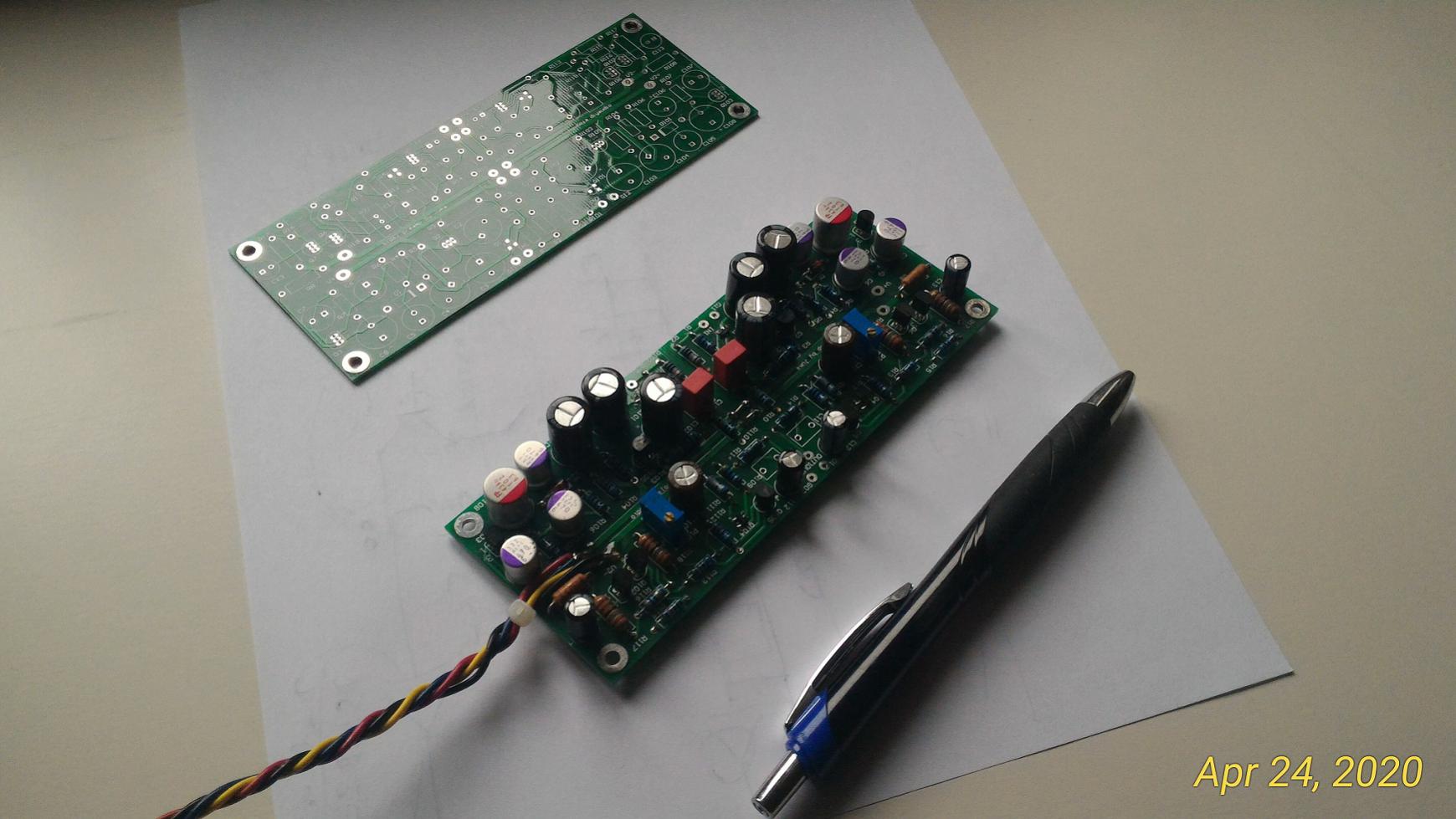

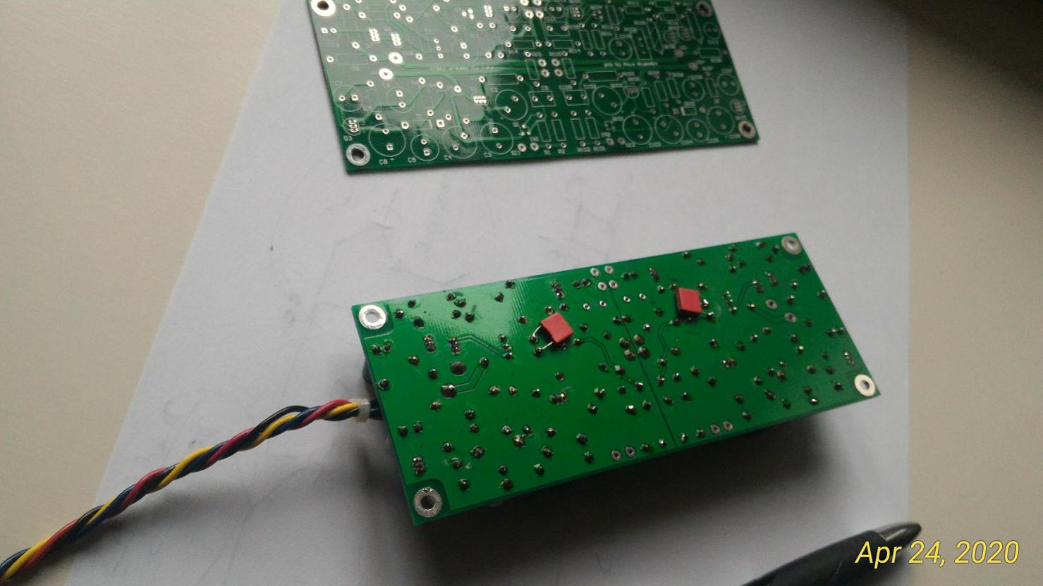

the circuit uses a bunch of Oscon caps, Elna silmic and film for low noise. the board requires some good soldering skills.
