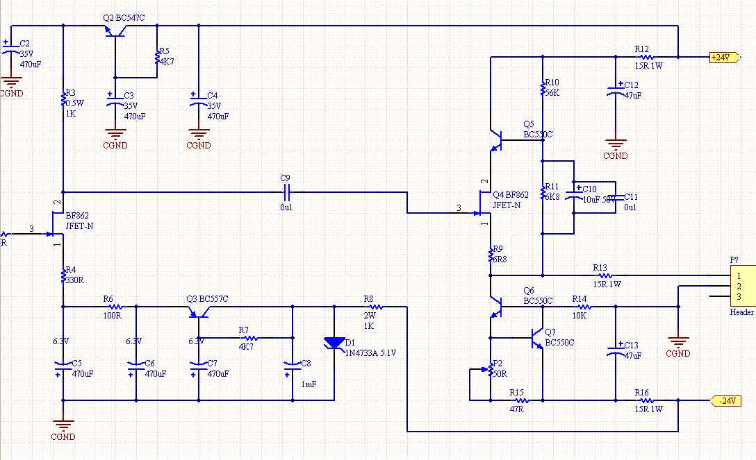

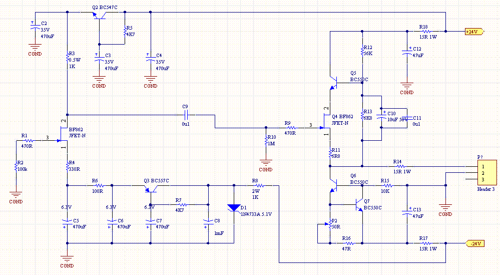

here comes the pcb for Juma's pre based on bf862 (I added the buffer too). the layout was subject to the following constraint: two pcbs will be stacked up on top of each other (for 4 channels total). this with only an inch long spacers and the top pcb will be flipped so they will be facing each other . this is why all the tall components like caps etc. are close to the edge so when mirrored they do not collide with those on the other pcb. it was not all that easy but looks Ok right now. I will be making manufacturing files and ordering soon. In the Fall I can probably tell you how they sound with an F5 and with an ACA, (have some speaker work to do first ).
I did the copper pour for the grounds, all one within a channel, no separate signal ground. I hope that's Ok?
also, Juma: Do you think the gain could be raised by 2-3 dBs? (which would allow use of 2x4 miniDSP with only 0.9Vrms outs). Currently it is 9dBs which mandates using a 2x8 XO which comes with 2Vrms outputs, and I am planning on bi-amping only. Thanks a lot!!

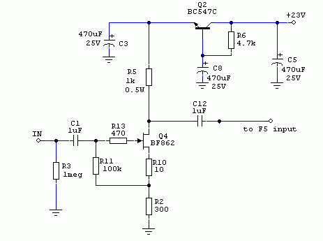

Sure, just change the source resistor to 200-220R and adjust the negative supply voltage (lower the zener diode's value) so that drain stays at about half of the positive supply voltage.
