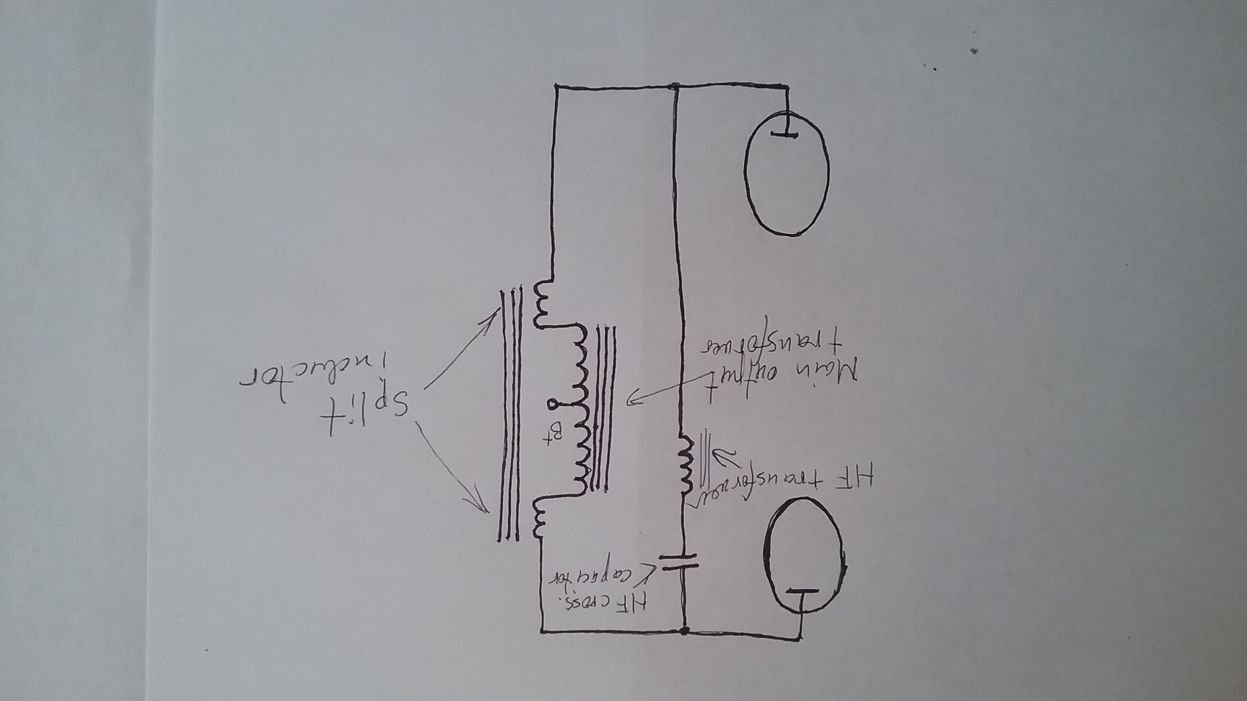

The principle of output level crossover, as opposed to speaker level one, has several advantages. The most important is the small size of crossover capacitor, so that highest quality capacitor can be used without considerable expense. Another advantage is simple design of output transformers. The main transformer can be optimized for mid frequencies; it may have high primary inductance to virtually eliminate saturation distortion, without concern for high frequency performance. It does not need interleaving; on contrary, it should be purposly designed to have certain leakage inductance, which will serve as crossover' s L element. HF transformer can be wound on very small highest permeability gapless core (supermalloy or nanocrystalline), also without interleaving. Due to winding proximity, frequency response will extend well beyond the audible range. As a bonus, winding your own, you can have highest quality transformers without outlay of thousands of dollars on exotic stuff.
No links, I did my own calculations. Here is an example.
In Rauland 2A3 parallel push-pull amplifier, the output load is 1.5 K. Original output transformer is not interleaved, it has primary inductance of 45 H and leakage inductance of 9 mH. For the crossover point of 1 kHz, total series inductance should be 25 mH (from the formula z=2piFL, so 16 mH inductor should be added (in this case split inductor because there are 2 secondary halves). High frequency transformer is wound on 30 mm Vitroperm 500 toroid core, it's primary is 2 H. HF transformer is connected across plates in series with 0.1 uF capacitor (1.5 k impedance at 1 kHz). Basically, capacitance and series inductance (the sum of leakage inductance and additional series inductor) should have impedance at the crossover frequency equal to stage's load impedance - for second order attenuation with -3dB at crossover point.
Sorry for the ugly sketch. Transformer secondaries are not shown.

PWK envisioned it as a 2 pole Butterworth, with LC network before the low frequency OPT (which would have the same iron core as a conventional one) and a CL network before the high frequency transformer (which would be smaller and optimized for its use, but not center-tapped). Neither transformer would contribute to the crossing over. (Crossovery?)
His original version used a bifilar choke in the LC and 2 equal capacitors of twice calculated value each in the CL. Not sure that's necessary, but is technically "correct".
