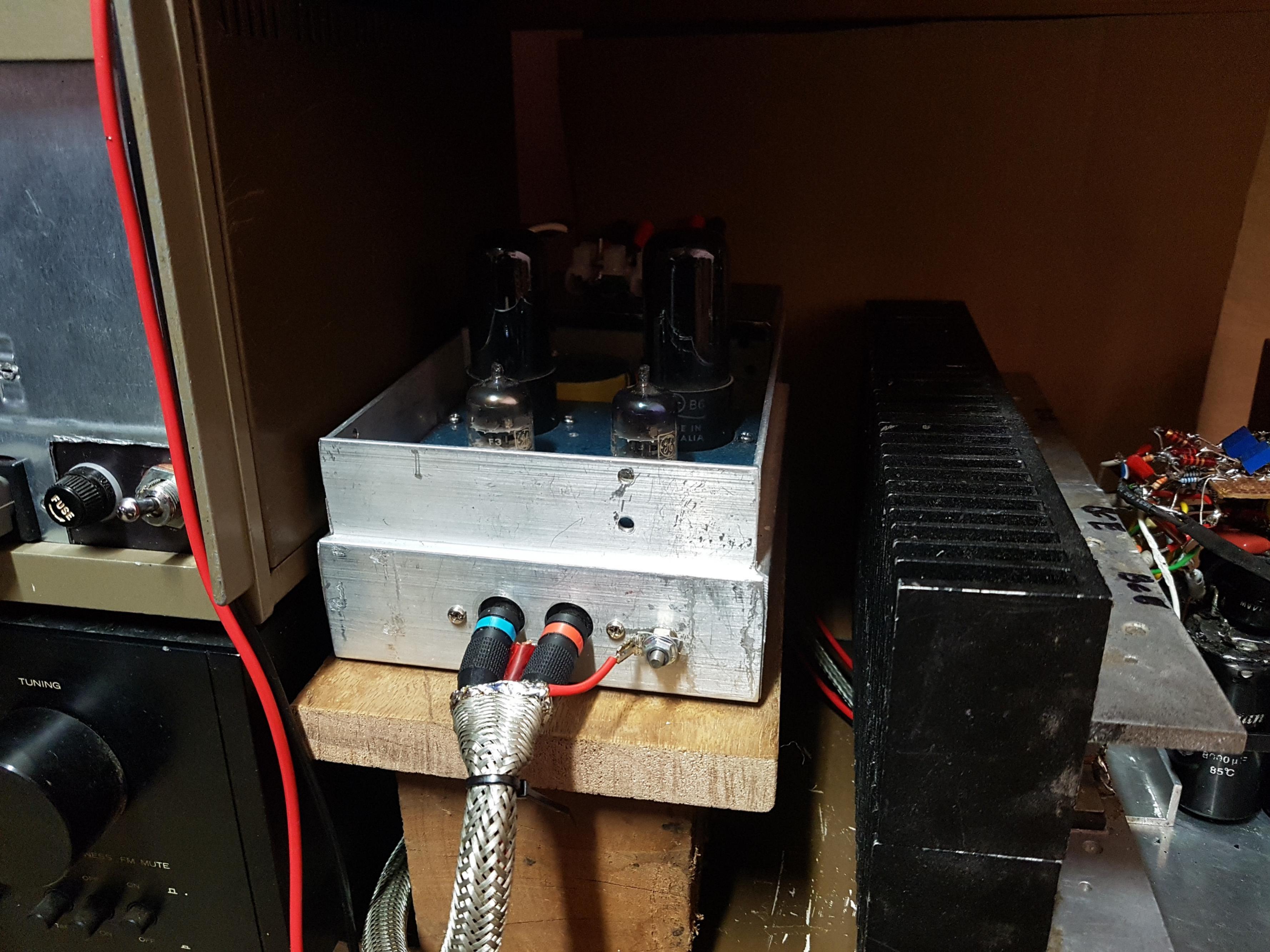

This one was fine until the mid 20's (kHz). I have this one photo (I could probably take more with internals if you like), you can just see the steel box attached to the back of the aluminium section. The transformers are similar in size to the 6V6s.

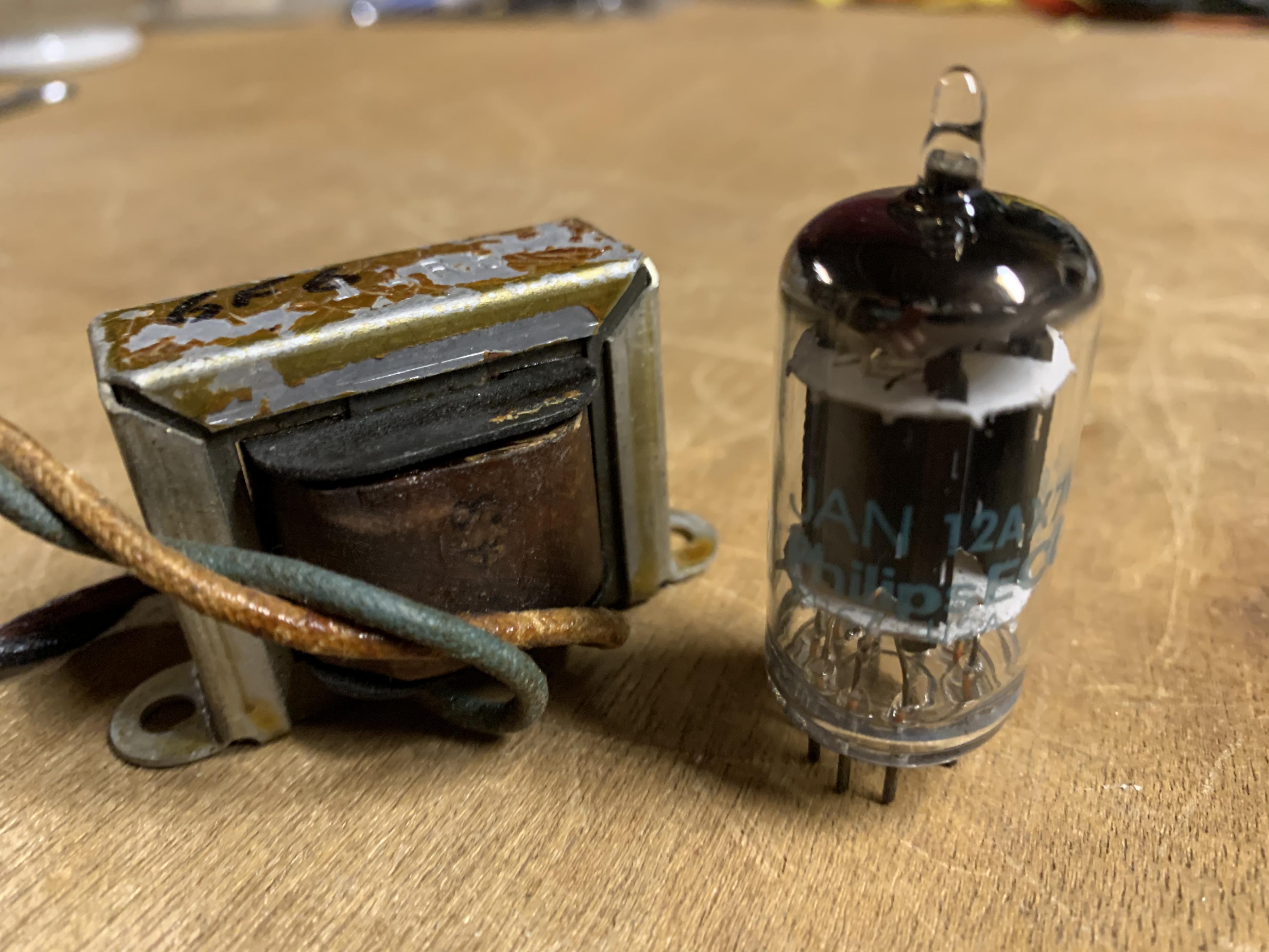

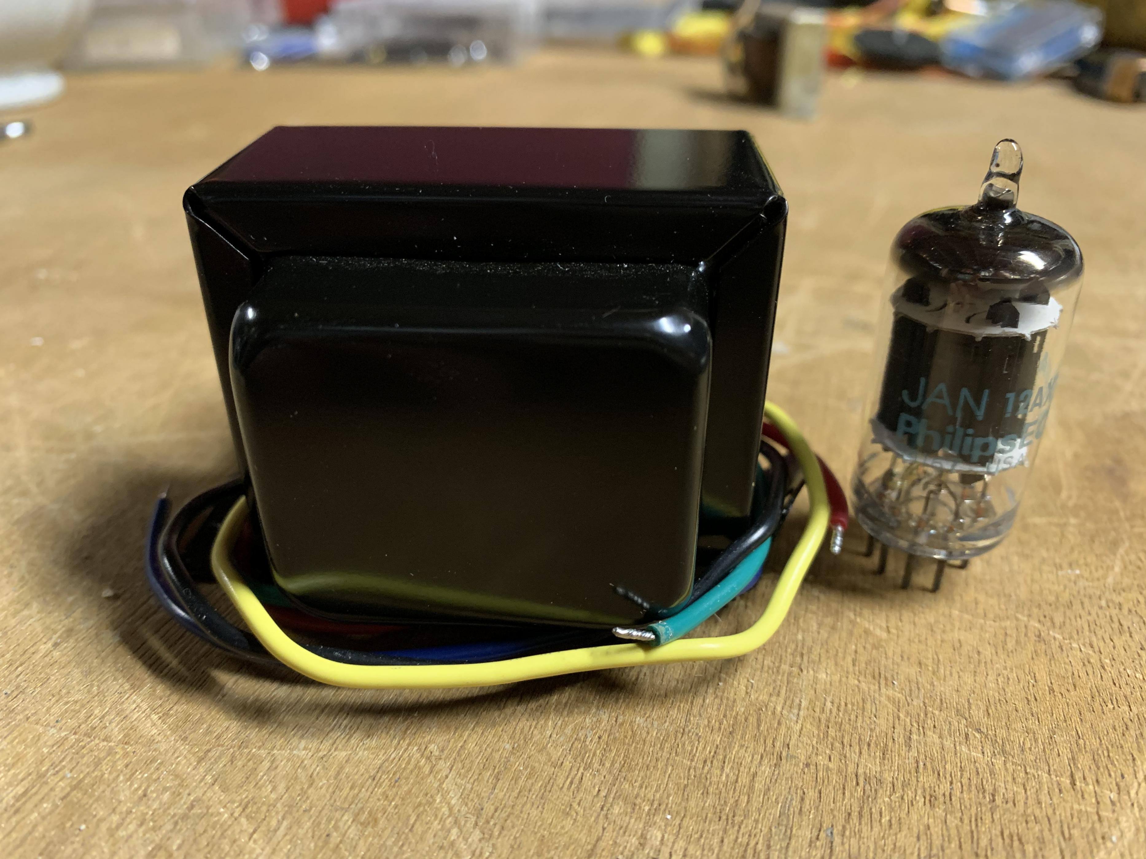

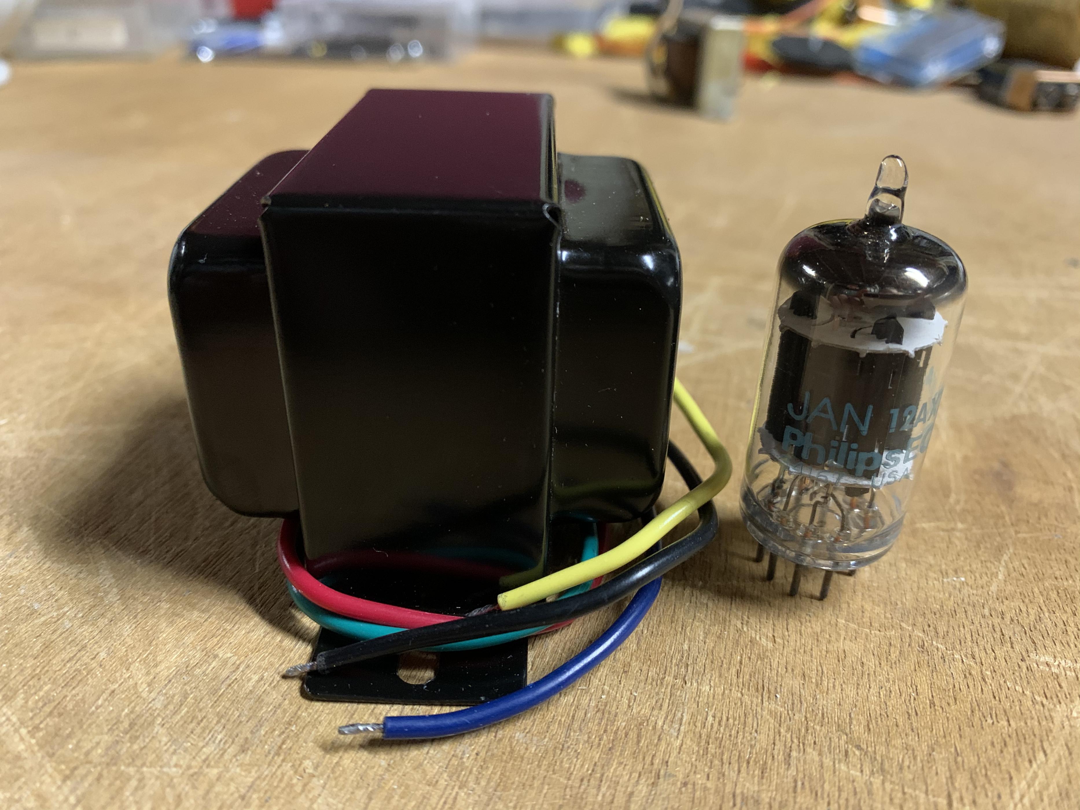

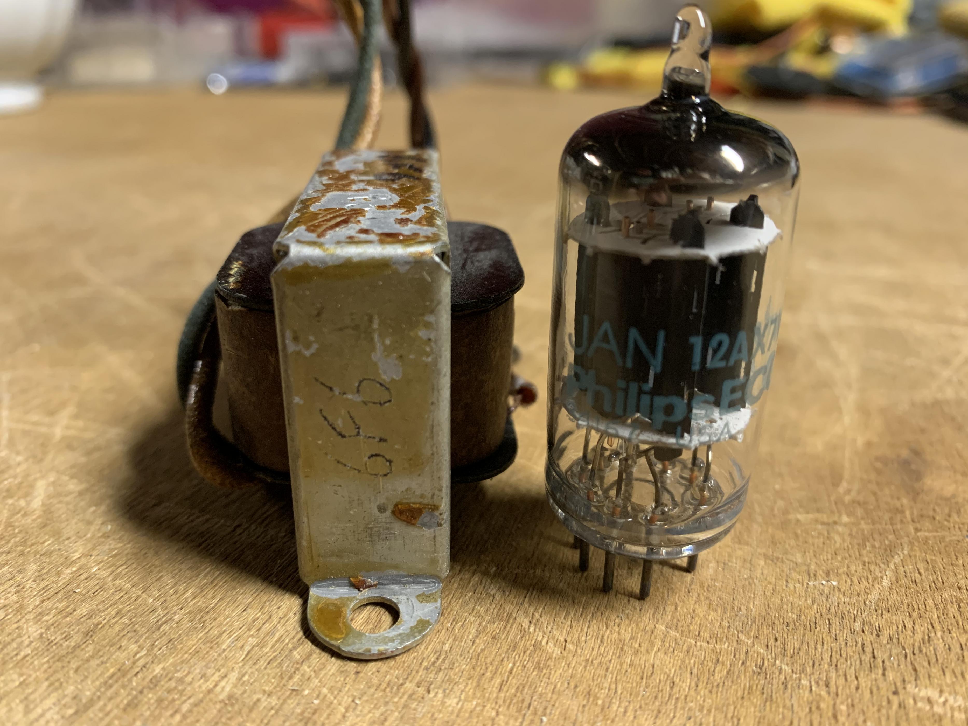

The OPTs arrived today. They are larger than I expected. Check out the attached photos of them next to a 12AX7 for scale. I also included a photo of a pair of OPTs that were in a 1950’s 6F6 amp. They are much smaller. I am wondering how important winding geometry is when an OPT is as small as the 6F6 one is? The 6F6 OPT has very little wire on it compared to any of the modern full range OPTs that I have at hand. It is much smaller than the OPTs that were just delivered. Is it possible that winding geometry is less of a factor with so little wire in such close proximity?

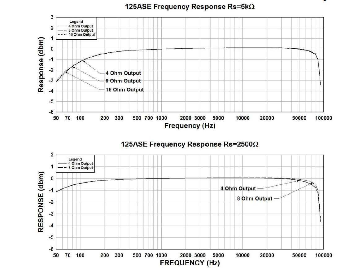

Hi Tizman,
Maybe I'm too late to recommend, but very small transformer like 125ASE from Hammond may work for your needs - low power, limited bass and very extended high range.
These measurements are from Hammond:
Thanks for your recommendation. I am using the 125CSE in my current treble amp, and it does sound very good in that role, but was looking for something really small that was also segmented/interleaved. Do you know what the winding geometry of the Hammond is? I couldn’t find any information online about it last time I looked, which was a while ago. I have this transformer on hand, AliExpress.com - Maintaining
