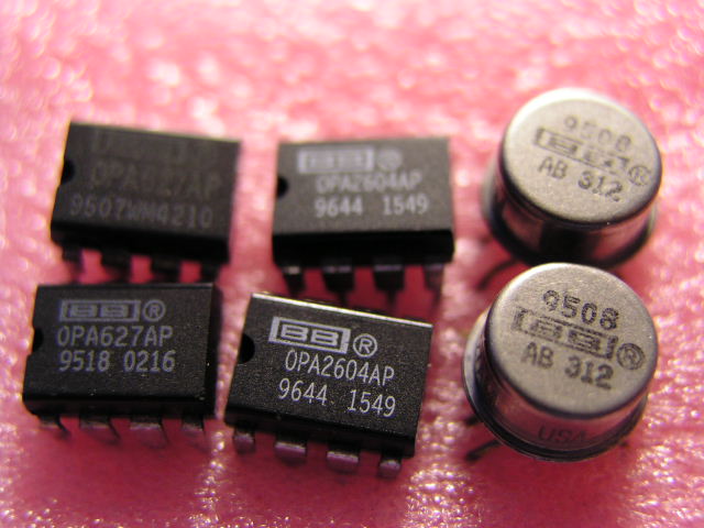

I was lucky because I can test the performance between AD844, 811 & OPA627 in same time. In my opinions & personal taste. I choose OPA627. so....... I decided used opa627or 2604 be the standard parts of my factory completed TDA1541a DAC (Non-oversampling VER.II). Besides, I test different rank of OPA627 that I can continous purchase & use in my DAC.
Test result: OPA627AM metal can made in USA is the best. secondary is BP, the rear is AP.
So................ OPA627AP or OPA2604AP will use in my DAC later.
OPA627BP & AM will be optional offer to diyers!!!!!!! Hope they will like it.
I was happy for that because..................... my friend offer a very good price to me. I can maintain Ver.II dac to diyer in good price.
pls see the photos.

Dear Elso Kwak,
I was PM to U already. Pls check.
BTW, is the metal can still seperate AM & BM????
I trust AM will be better because metal can is Made in USA. AP & BP is made in Taiwan. As the different periods of making about TDA1541a. I trust early in overseas will better. So way I collect Netherland & belgium factory made only.

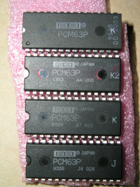

PCM 63P on my hand also be same. J,K,K2 was made in Japan.
Later is Made in Taiwan. Pls see the different between them.

Sorry Thomas, you still don't get it. The higher grade is the B-grade (beeeeeee). This is obvious from the datasheet.
Actually specs for metal can are exactly the same as for the DIL package.
Now if for some mysterious reason the metal can is better for audio the B-grade (metal can) will even be more better...
But I understand from you posting that you only offer the A-grade in the metal can, right?
The plastic DIL B-grade I am using are made in the Phlippines but the bag says Taiwan.
