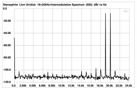

Those are the IMD measures of Linn 1.1 in 24 bit mode:
http://www.stereophile.com/images/archivesart/1203LINFIG7.jpg
And here are the same IMD measures, same frequencies 19k+20k, of 47Ai through i-link to modified 49TXi (it is the output of PROCESSOR already , not of the player itself):
http://www.angelfire.com/clone/gordon0/49TXi/imd.png
As we can see, we got -95dB at 1kHz and at 2kHz -102dB in Pioneer and -102dB at 1 kHz plus -97dB at 17 kHz in Linn - more or less the same. But look at the noise background floor! It is -140dB in Pioneer and -115dB in Linn, and we have to think about the additional noises when we will process the analog signal of Linn through the additional pre-pro (we got that pre-pro already for Pioneer). I am not talking about abilities of 47Ai (59AVi is even better) as DVD player and the difference in prices ... we don't need to compare designs and elements, if we have the measures, don't you think so?

Gordon, I don't really give much importance to specs, sometimes they're misleading.
Listening is what gives you (me) a real conclusion.
