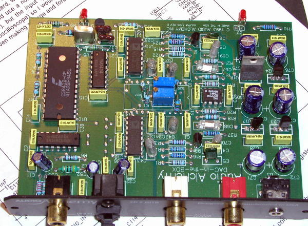

Hello all !!
I have just completed my DITB mods with the folowing:
1. Added 220uF Nichicon Muse FG in the incoming PS section.
2. Transferred the 0.1uF PP to the underside & added further 220uF Nichicon Muse FG to the incoming PS
3. Added 470uF Nichicon Muse FG to Dac analog PS with existing 0.1uF underside each 470uF.
4. Added 470uF Nichicon Muse FG to Opamp PS with existing 0.47uF underside each 470uF.
5. Replaced the OP-275 with OPA-2134PA.
Now - how does it sound ??
First impressions are that the color of tone changed for the better, much richer, nice low end and wonderful upper end without a hint of sibilance. But, I kind of feel there's a loss of airiness which was there earlier in my DITB. Also, imaging may have also taken a "slight beating" but am still not sure on this.
Can someone tell me what series PP caps are/may be necessary to bring about the best from this BB OPA-2134?
Thanks to all of you for helping me reach my goals!

" ... what ... may be necessary to bring about the best from this BB OPA2134? ..." ... or 4558 or 5532 or 5535 or 4560 or any op-amp, FET input or not.
It looks like you have already taken care of this as you already refered to several 0.1 and 0.01 uF caps in your mod ... just make sure they are plastic caps:
See: http://focus.ti.com/lit/ds/symlink/opa2134.pdf ... top of page 8 is a simple test circuit diagram. Note the presence of those 10nF (0.01 uF) caps on the power pins. This is becoming SOP for better quality audio op-amp designs and applications, adding plastic caps to the power rails (PP = polypropylene, polystyrene or MKT type). These should be "close coupled" to the op-amp power pins ... I install 'em so they look like they are making love = so close you can solder both connections with one pass, like the cap through holes are within 1/10" of the power pin holes ... These plastic caps are in parallel with the "standard" electrolytics usually placed on the circuit boards as additional power supply decoupling / filtering.
This applies to just about any single or multichannel op-amp or chip amp. The various quality op-amp makers, TI/Burr Brown, Analog, etc., are all adding plastic caps like this to their test circuits 'cause that way they get better specs. The "rule of thumb", if you need power filtration on your board, do so and add these plastic caps as well, if think you don't need 'em, add 'em anyway. Figure: for every 1uF of electro, add 0.001uF to 0.010uF of plastic ...
Bob Pease of Electronic Design Magazine has written several columns about exactly this and there as a bunch of Internet references as to which type of cap works best ... sometimes making reference to the fact that this makes all the "poor quality" electrolytic caps look good.

As I have 470uF of lytic, as per your thumb-rule, plastic should be 0.47 to 4.7uF. Currently, I have 0.47uF. Should I add another 0.47 to the existing one?
" ... 470uF of lytic ... plastic should be 0.47 to 4.7uF [?] ... I have 0.47uF. Should I add another 0.47 to the existing one? ..."
As the electrolytics get bigger, the plastic caps don't have to "keep up" ... and one 0.47 uF (470 nF) for each power rail should be sufficient ... unless you have more than one op-amp chip on your board, of course, then you can easily, reliabily "split the difference" ... 0.22 uF for each rail, each op-amp = total of 4 plastic caps on two op-amps, etc. 😀
That "rule of thumb" is pretty flexable. As long as the plastic caps are greater than about 0.047 uF, each, the higher frequencies will be "sharpened up" and the overall parallel capacitance need not be "compounded" ... It is a case where enough is enough and too much won't hurt, but gets to be ah, well, too much. ... I use 0.022 uF (22 nF) everywhere, I buy these by the handfull, about US$0.25 each. I try to get the yellow MKT types or the redish/orange poly types with ratings above 100 volts. Two X 0.022 uF is enough for any single op-amp, but 0.47 uF is not really "overkill".

Hi all
Am currently on OPA2134 but am I likely to get a better sound replacing with OPA2132?

Yes, you will get much better sound with 2132. I have tried both.
Hello CT
Thanks for your feedback. Which 2132 did you use - "PA" or "P" ??
Also, did you try OPA627/637 or any AD types. Please report your remarks as it will help me.

I have used both in two different SACD players (sony C555es and Denon 2900) but did not compare them directly.
I have used 627 in my headphone amps. They are fantastic. But I have not done a direct comparison with 2132.

two things I would do.
1.) measure the DC resistance at the output of the DITB.
2.) measure the output offset over a range of operating conditions.

1) Output R sits practically at 100 ohms.
2) negligible offset - not worth the cap - hence have left it flat open to DC.
Happy that way - helps with the Low Freq esp. after moving to 12V reg for the analog power.

I read about a different approach to improving the analogue-out of the DITB which involved changing forn the DAC chip(s) V (voltage) -out to its I (current) -out with a resistor load.
This is supposed to allow two benefits;
It bypasses the on-board opamp circuitry of the DAC chip and allows one to choose what voltage is fed to the op-amps, and hence the DITB's overall output.
One could drop the DAC's line-out from it's (IIRC) 2.4v to, say, 1.5v which would then make the standard 5v rails adequate for the purpose, which it isn't for 2.4v.
@ Aleksunder
Indeed - your method is the alternative one. In the DITB, the AD1860s dacs do the I/V themselves internally. Pulling out the "I" off the dac chips would work best if one was to use a top-notch transformer to couple to the output jacks. Simple, minimalist yet great sound is what I can surely predict BUT all depends on the transformer quality!
I've been very much delighted with the level of uplift this tiny DITB has provided me by using a completely re-done PSU that is at +/-15V DC 2.5 Amps. The PSU is extensively regulated right from using HEXFREDs rectifier diodes, top-notch electrolytics along with Multicap double bypass.
A similar sort of attention was also given to the DITB board & the end results are just awesome!! Can't believe its still that $200 dac from the mid '90s.
DITB owners' would be highly recommended to go either way, i.e. using the voltage out off the dac chips OR taking out the current off the dac chips and then to outputs. However, you still need a "stealth" PSU for best results.
