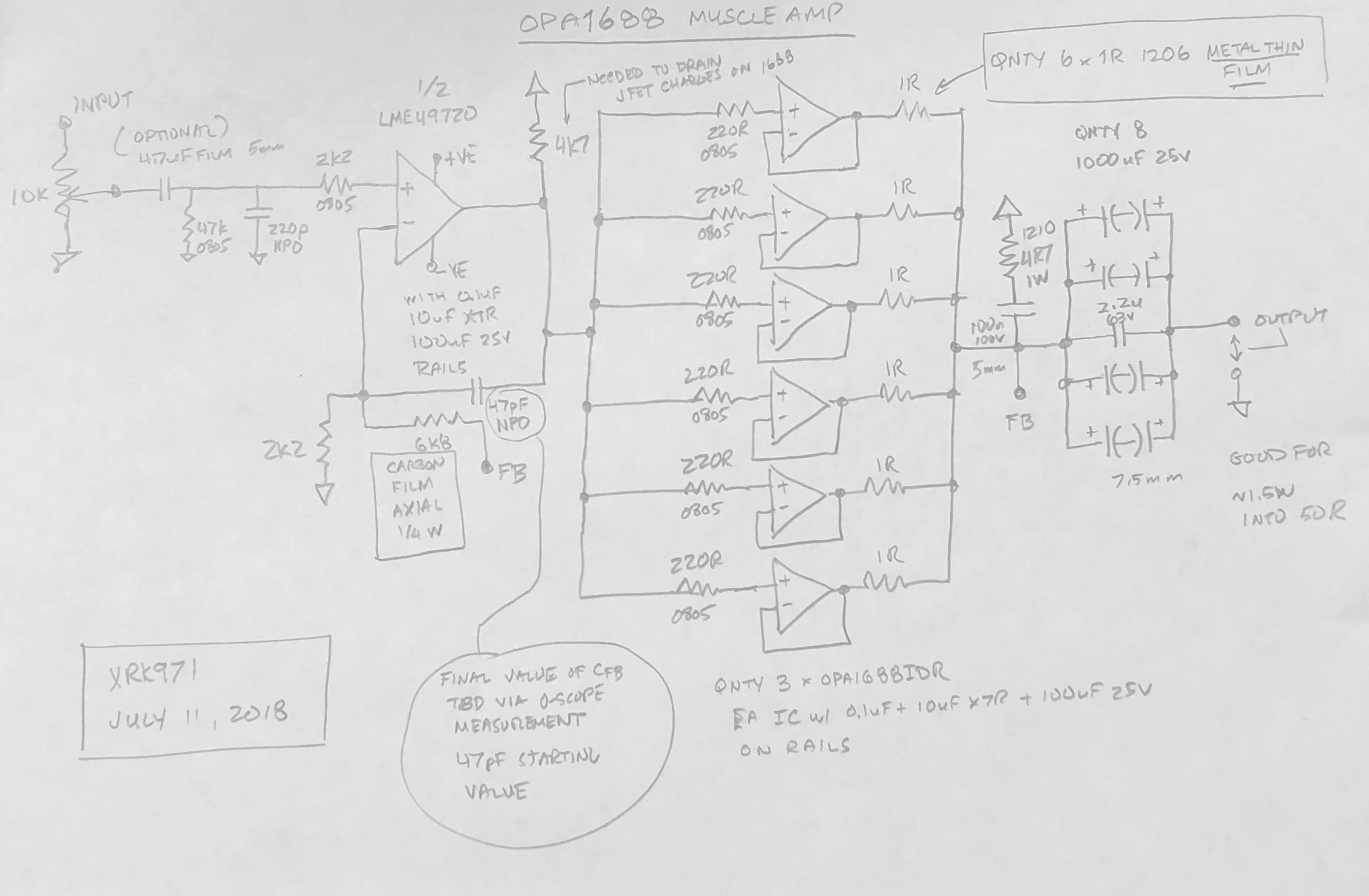

Add 0.1uF film and 4.7R Zobel to absorb any RF oscillation.
While this sledgehammer may absorb RF oscillation, it will also surely cause instability with most amplifiers. Not many that I know of can drive 0.1µF and remain stable, especially with only 4.7Ω of series resistance.
Isn't the point to have a stable amplifier, and not just flatten the oscillation out of the output jack?
The 0.1uF and 4R7 is usually placed in a Class AB amp with negative feedback to absorb oscillations that may arise from certain loads plugged into the amp. Certainly it is not the purpose to absorb on-going oscillations. The amp should be stable on its own. If you have this in place, it can save an amp from self destruct if an unstable load is plugged into it.
On the OPA1688, it does not present a problem, the amp as designed in the last schematic is stable and works very well as it has now been tested. The output coupling caps are 1100uF effective capacitance, and is driven just fine.

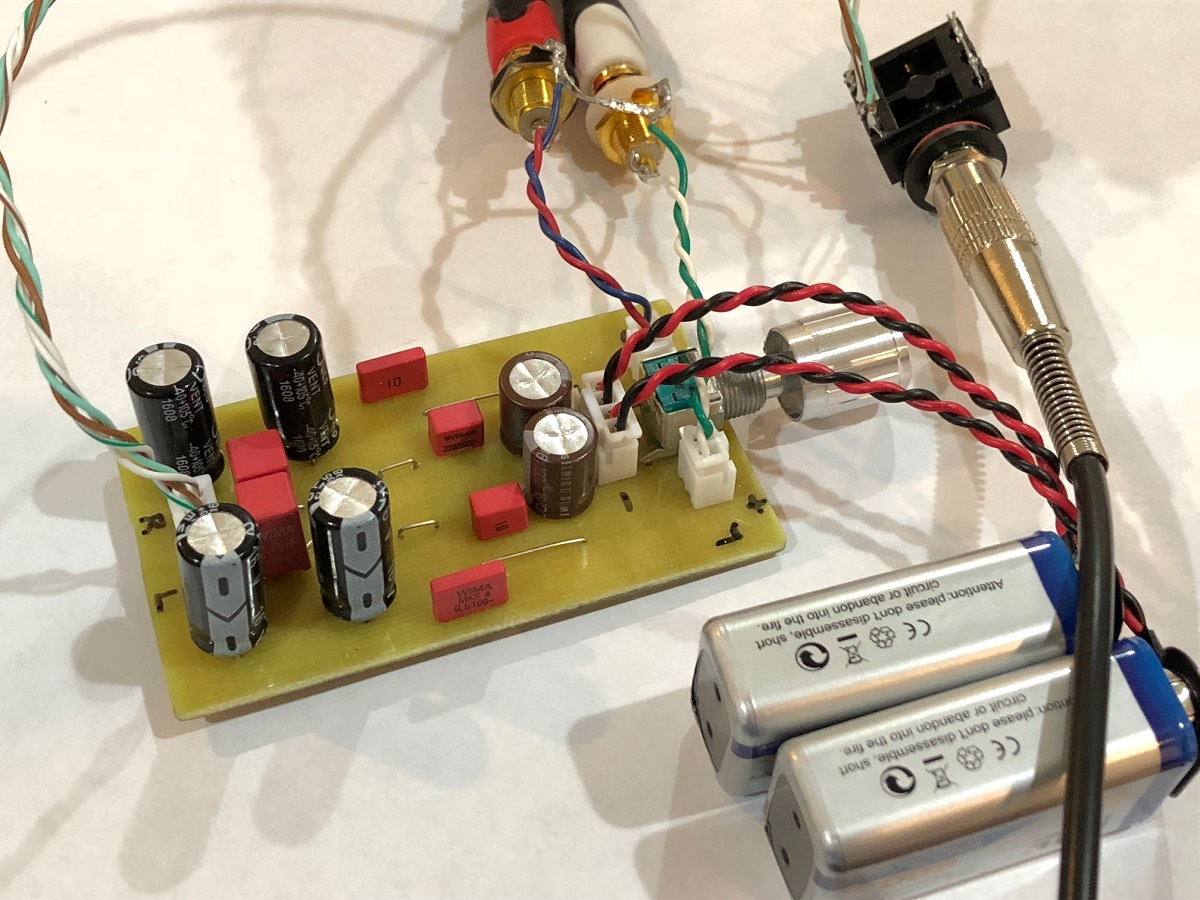

Here is the HPA connected to my Focusrite DAC and OB-1 headphones:

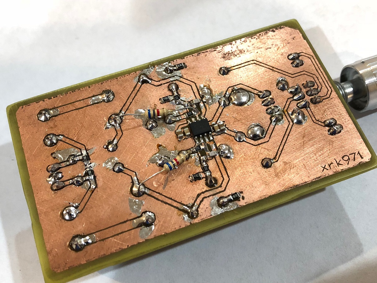

This is the underside showing the SMT components. It's a bit messy as I did some tests by pulling out the caps and running DC coupled all the way through (it works well this way too). I am using a carbon film axial feedback resistor and in conjunction with 2k2 gives 4.1x gain:
Monte McGuire is right, the zobel values aren't adequate for the opa1688. If you do a quick sim, you'll see that they create a bad peak a bit under 1Mhz. If you want a zobel, 47R+100n would be more adequate.
The 47pF feedback cap is oversized too, considering the gain and feedback resistors values. But that's less of a concern.

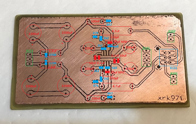

I will try to make changes . I made it on veroboard. It will be easier for me

@xrk971 which are those cute sockets from ?

The 47pF value is the factory spec sheet recommended circuit. It’s also the one used by Agdr in his Super Cmoy. I have 36pF, 33pF, and 15pF NP0 to try. Will need to put it on oscope to check. Btw, I ran it in all DC coupled front to back and offset was 1mV per factory spec. The output coupler caps are here as simple way to protect for the what-if scenario of 1 battery clip coming loose first, as a huge portion of the Super Cmoy and even the O2 power supply systems are simply there to protect the headphones in the event of a power rail imbalance. A lot of complexity solved by a few caps. My qualitative sound quality listening session showed no discernible difference with output caps in place.
I can change out the Zobel resistors easily - they are at the edge of the board. Actually with a hot air gun anything can be changed easily.
The connectors are 2.54mm pitch JST style male PCB mount and female crimped shells. You can buy them ready made as battery harnesses for small RC cars or quadcopters. Or just buy them bare and crimp yourself. You need a good crimper tool to make effective crimped joints as too unreliable and time consuming to make by hand.

A cool (and still simple) variant of the project would be to make a quad parallel version in order to drive a maximum of 300mA into a 50ohm load. Would probably require a true 2sided board made by a factory. The outputs of four unity gain OPA1688 operation as buffers could be summed with four x 1R load balancing resistors with feedback taken from summed output to a master voltage gain opamp. Could use a 5th OPA1688 for that if even an LME49720.
I think that’s good for 500mW into 50ohms or thereabouts.

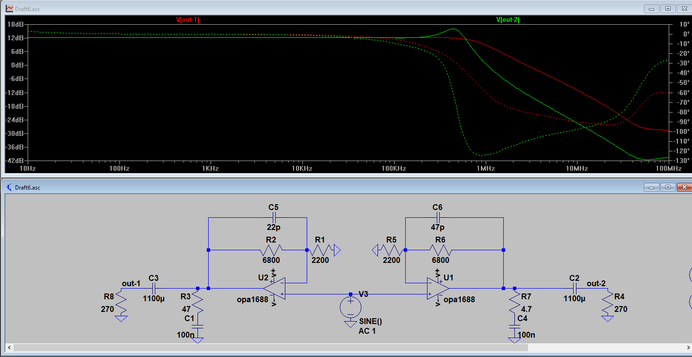

I'm not sure I'm buying into that whole flat phase to 300Khz theory but still : the 4.7r zobel messes up everything so bad that it doesn't matter what is its corner frequency. With 4.7r, you need a big feedback compensation cap to counteract the peak created by the zobel (I wouldn't use compensation caps under 47pf as long as you have that zobel btw, phase margin goes down the drain). The 47pF cap combined with the 4.7r+100n zobel is starting to roll off before a combination of 22pF comp cap with 47r+100n zobel. See the attached sim.
To give some perspective: without zobel and with a 8.2pf comp cap, your gain margin is 74°, with 47r+100n and a 22pf cap, 95°. And with 4.7+100n and 47pf.... 37°. All calculations made with the simulated load suggested by John Caldwell and the model from TI under ltspice (using the Tian probe).

Thanks for doing the sim. Can you share the LTspice .asc file? Or show me where to get the 1688 model. I could also use a LME49710/20 model.

OPA1688 model: http://www.ti.com/lit/zip/sbom950
LME49710 model: http://www.ti.com/lit/zip/snam001
The LM4562 will also work, and might be a different model, but somehow, I decided the LME49710 was a 'better' model and have been using it for a while.
