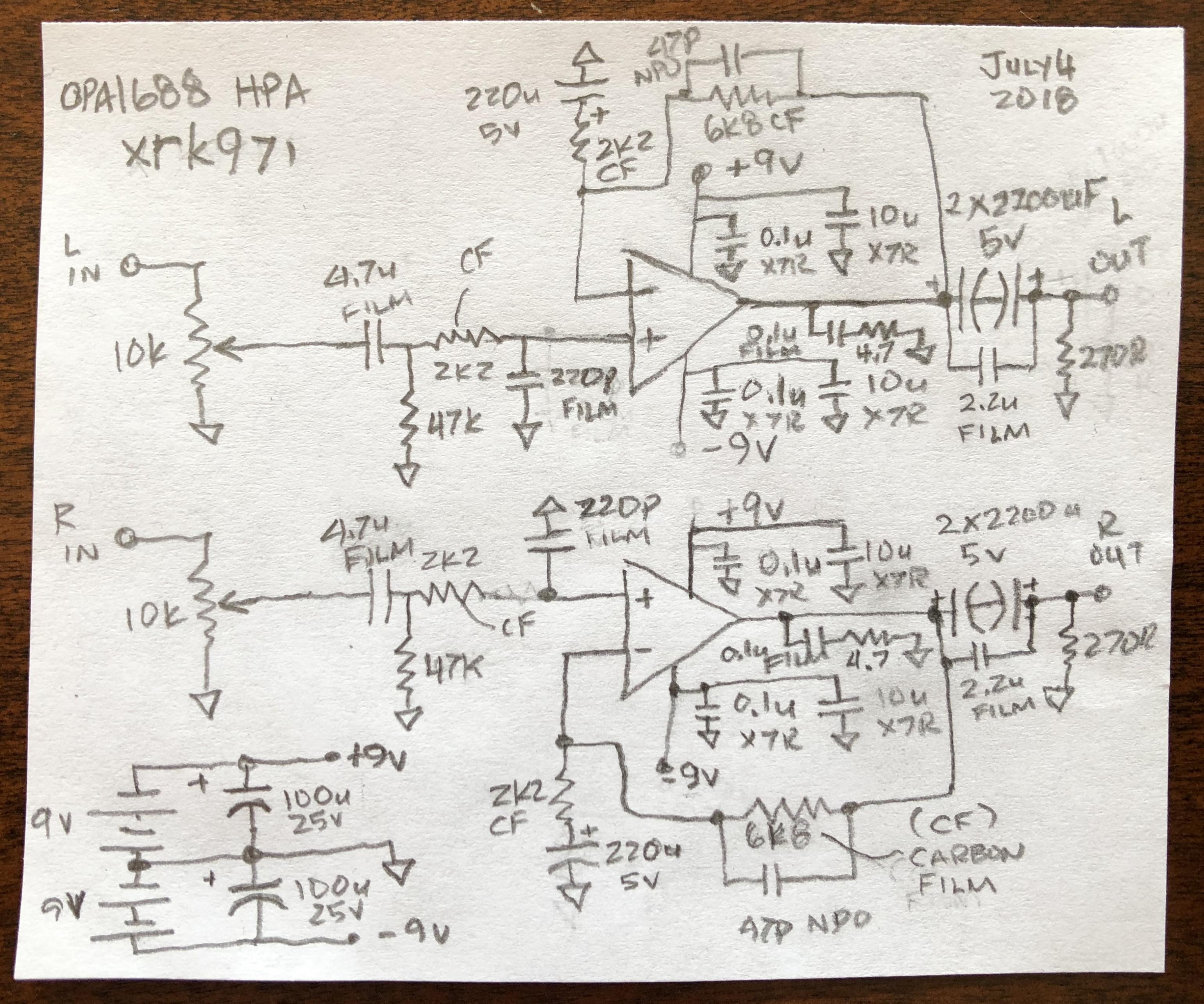

Are you getting close to building the schematic I presented? I’m curious how it will sound - I expect it should work quite well. I have used this opamp in several projects and it’s a real good one. I have a 1688 sitting in a breadboard ready for components to be added - I might whip one up if I have time.

I am building it on a veroboard. I am trying to find 4.7uf film capacitor . I will use 2.2uf film if I don't get any.

By the way it is working really well. I believe it will perform better with PCB.
But sound is flat to my taste . How can I improve bass slightly?(I don't like heavy bass)
Glad it’s working well for you. That’s my first amp designed on the back of an envelope! 🙂
If you like gentler bass, change the 220uF feedback shunt capacitor (connected 2k2 and GND) to 100uF and bypass it with 1uF MKP film cap.

I have just build everything like your design nothing changed.Glad it’s working well for you. That’s my first amp designed on the back of an envelope! 🙂

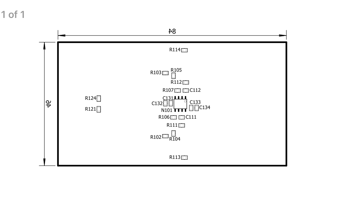

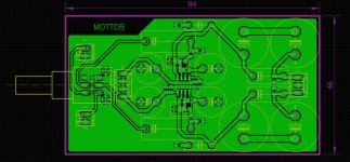

JPS64 to the Rescue!

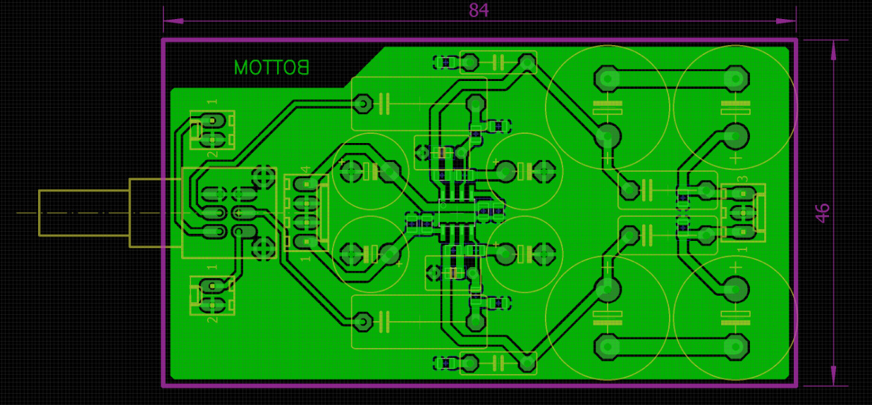

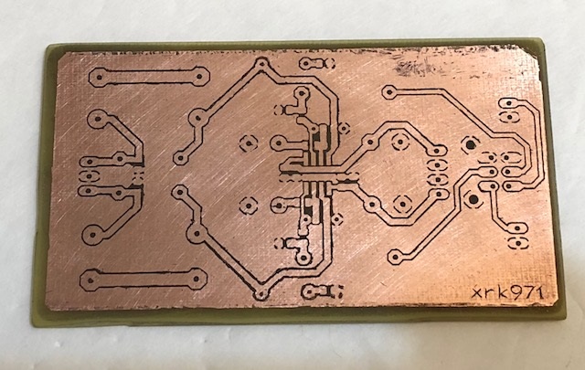

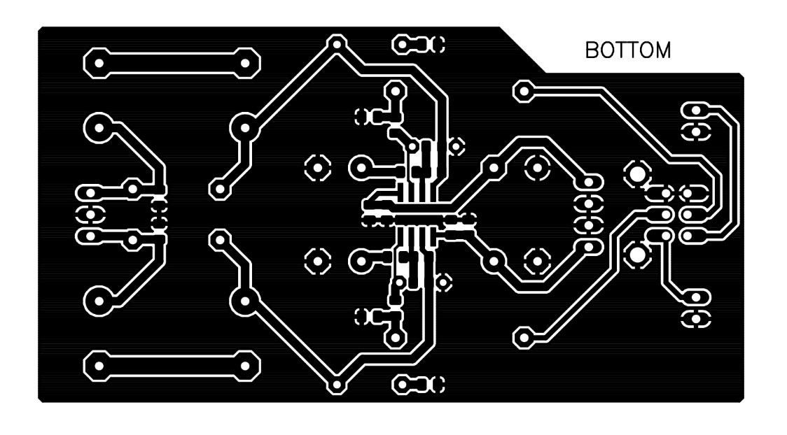

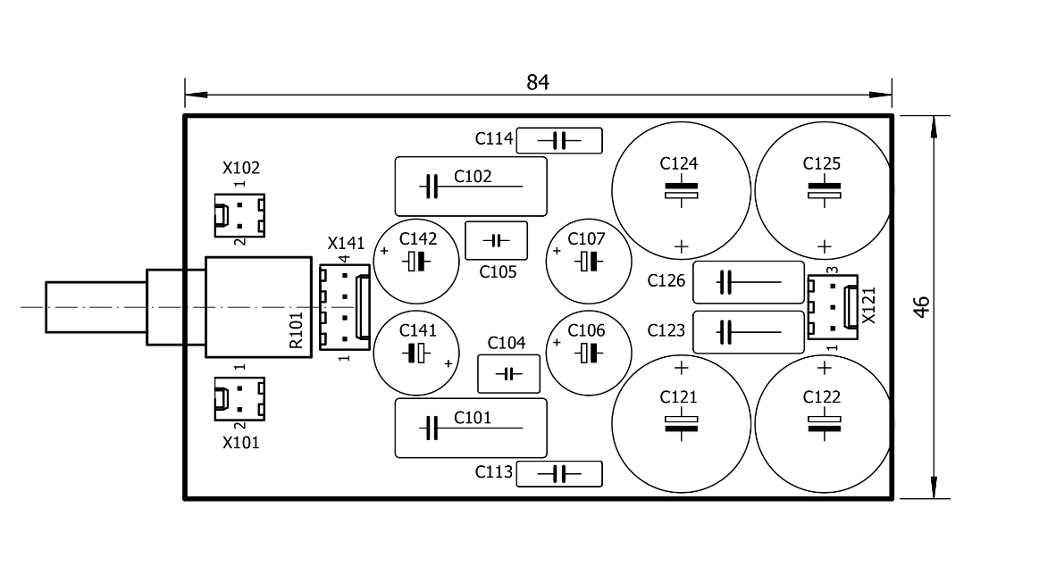

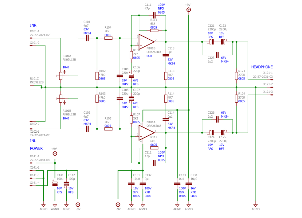

We are really lucky as I was making a hand layout and asked JPS64 to look at this and he was very generous to give us a pro layout in no time. This is specifically made for single layer home etching. The SMTs are on the bottom and through hole parts on the top. Looks superb.
Thanks, JPS64!
Schematic:
Top placement guide:
Bottom placement guide:
Bottom copper image:
Viewed from top with parts:
Pdf of copper attached below.
Thanks, JPS64!
Schematic:

This is a good preamplifier too and can be powered up to +/-18v just increase cap voltages to accommodate higher rail voltages.
Thanks man .I cannot wait to return home and ask granny etch one PCB for me but I have to get some more opa1688 . I bought 5 for usb DAC project. Now all used up.
Why granny don't allow me to etch PCB myself? Does ferric chloride is harmful?
I use HCl (muriatic acid "concrete sidewalk cleaner" from hardware store) and H2O2 (first aid hydrogen peroxide from drugstore) in 2:1 proportions (by volume HCl:H2O2). Much cheaper than ferric chloride and you can flush down drain after diluting. I just printed my iron on transfer and about to cut FRP board for etching. Don't forget to mirror the bottom image before printing transfer. On my printer, 50% scale works perfectly (check by putting OPA1688 pins to see if they fit). I happen to have 9 on hand so can go wild. 🙂
