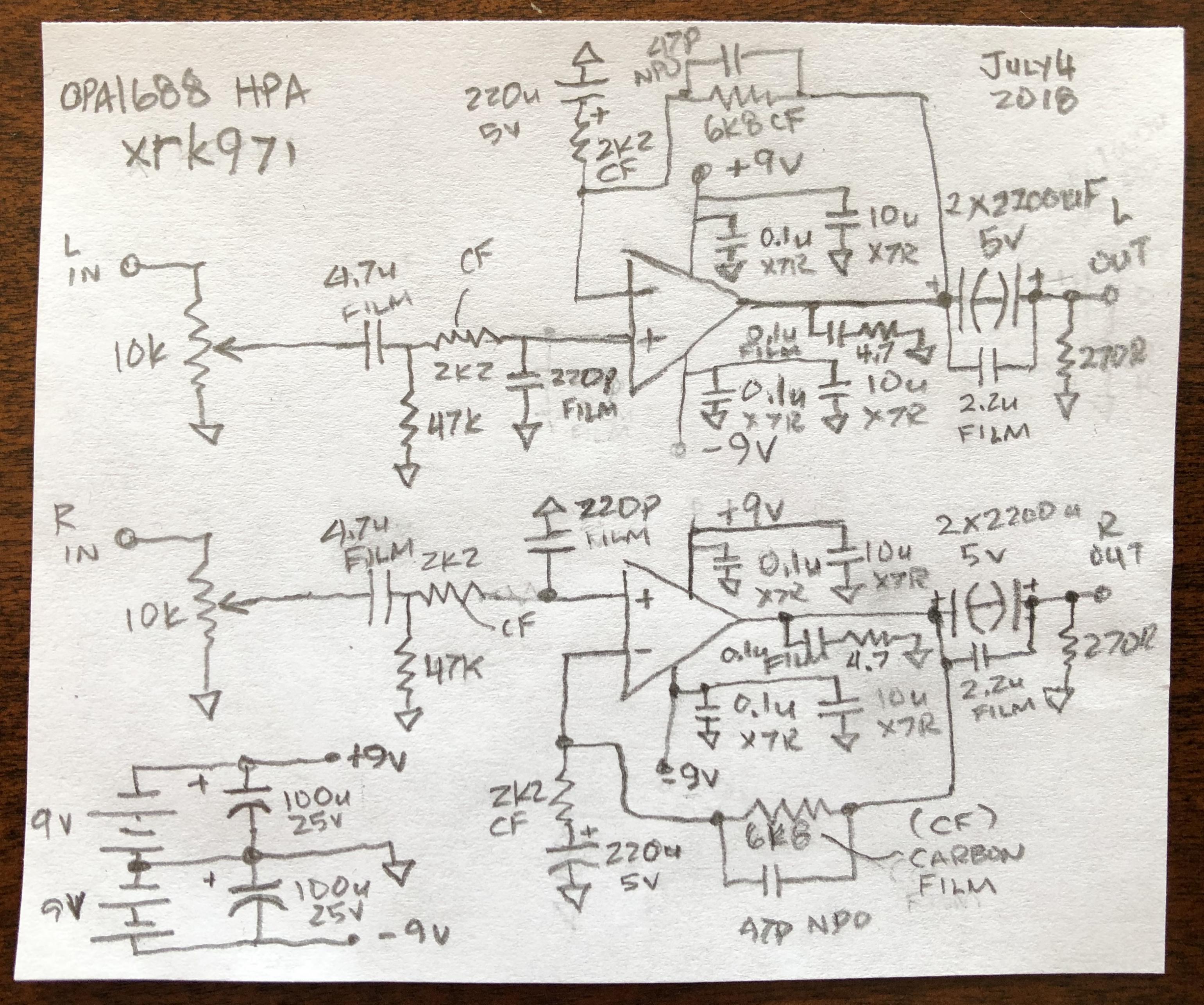

I came back . I want to design something own.

With dual rail voltage you can have headphone DC coupled and with single rail you need output capacitor between amp and headphone. Not a bad thing to protect it from DC. Some of my best amps are SE Class A with output cap coupler and single rail voltage supply.
Skip the voltage regulator and tie midpoint of two batteries to GND. Why are you using inverting amp? Add RFI filter on input, lots of good x7r bypass caps next to legs of opamp. Use two 2200uF 5v caps back to back for 10v bipolar outpt cap bypass with 2.2u MKS. Add 270R load to output to absorb and dissipate turn on DC transient. Add 0.1uF film and 4.7R Zobel to absorb any RF oscillation.
Basically looks like this. Give it a try.
Note that larger value or larger voltage rating input or output caps can be used, I just tried to keep parts as small as possible.
If you don’t have carbon film use metal thin film for now. Feedback cap can be NP0 or MKP/FKP but not X7R.
