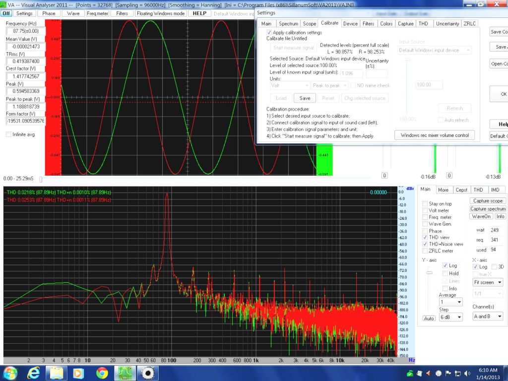

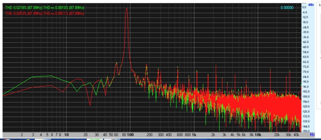

The board is advertised at -108db for noise or at least THX compaiable.
Clearly by this shot the inputs are better than that and there are a few pulses of noise but they never go above -108db.

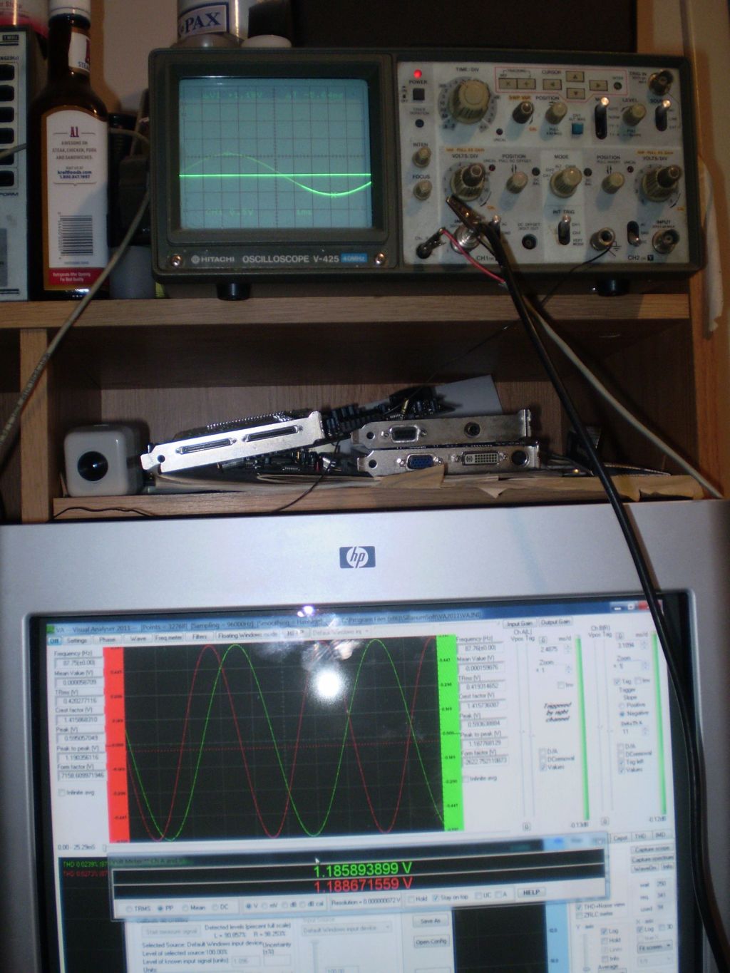

These noise levels are the input noise levels as stock and open and unterminated using the onboard 24 bit A/D's.
I don't have any other means of checking at higher frequency's other that my 60Mhz Hitachi analog scope.
The scope is getting old but I did used to be able to detect signal up into the 100Mhz range with it.
I will try to get some screen shots using it when I do some more testing.

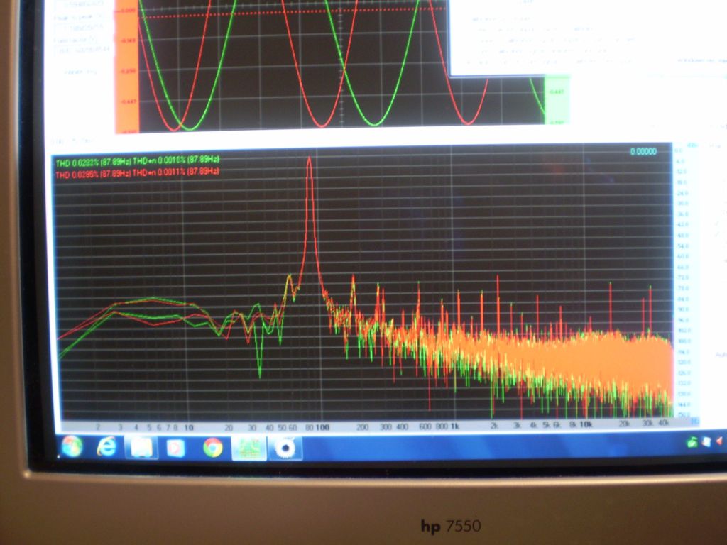

skibum, I haven't been able to find any significant RF noise energies coming out of the system using my scope even with the sensitivity up as far as it would go at 5mv per div.
Even with the scope connect to the case my ambient noise is much greater than any thing coming from the computer.
I did make some pictures of the scope but there really wasn't any thing to show except the noise getting picked up from my CRT monitors being on.

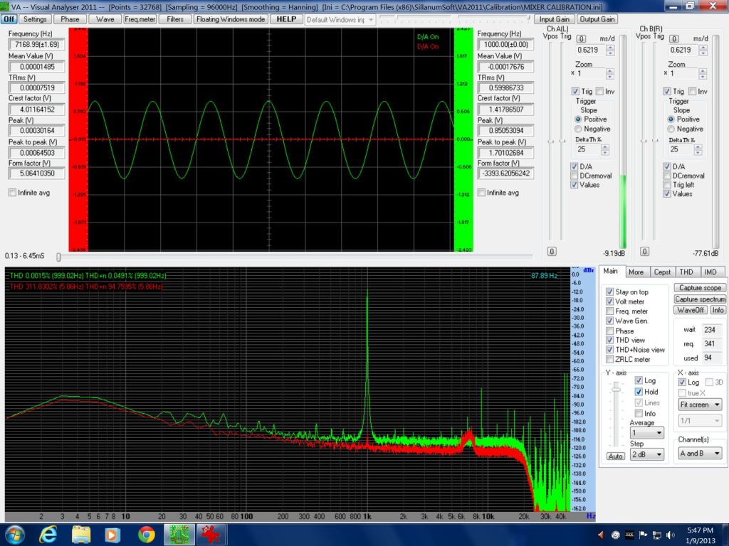

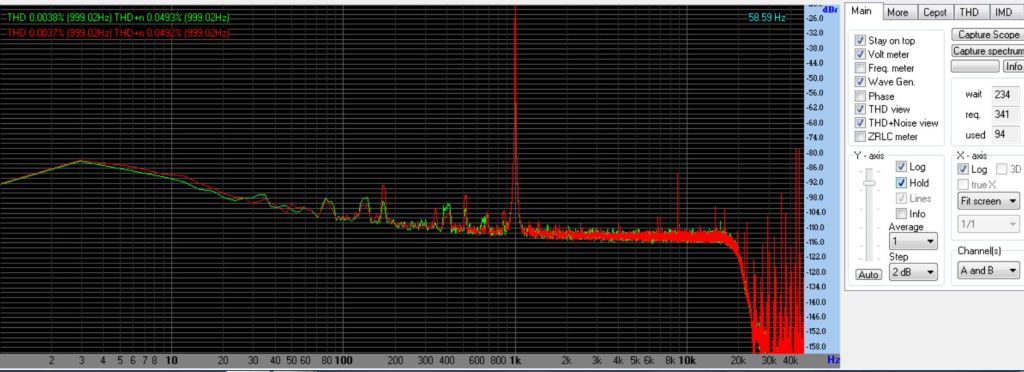

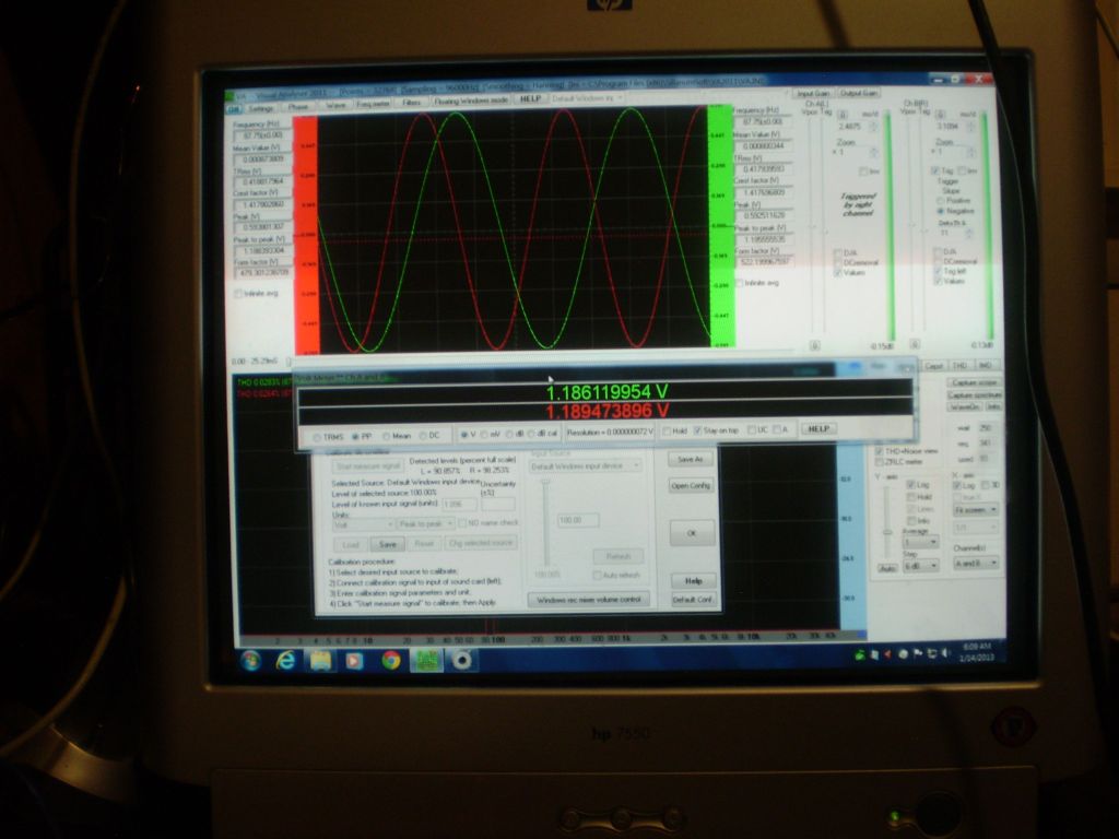

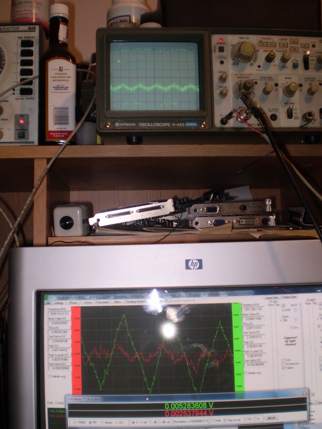

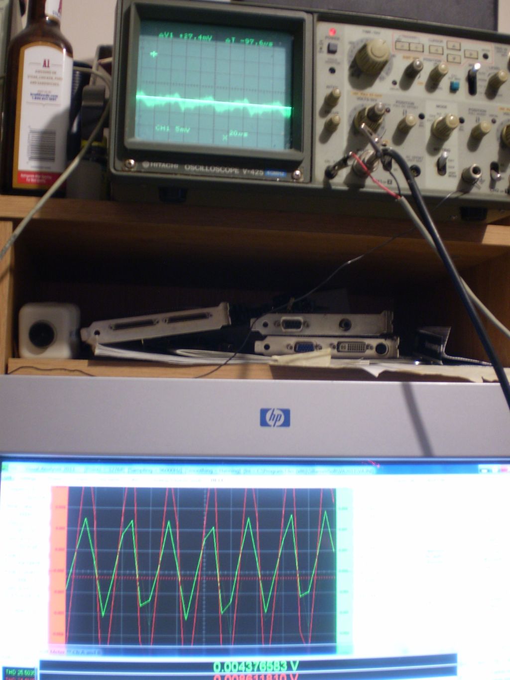

Here are a few more screen shots of some loopback tests through my mixer.
The second picture is of one of the inputs with a 1KHZ signal from the computer, and, the other input is shorted at the computer without the mixer.
Two other test show a 1Khz and 20Khz 5mv Triangle wave that is created from TONE signal generator program the waveform may have been in a 16bit output mode in this test by the looks of the 20KHZ signal.
But the sampling was done in 24bit.
It is buried in the mixers noise and the waveform shown on the scope is the actual signal being sampled by the computer.

I have found that running the Realtek ALC892 at 192Khz can be glitchy on the input side at times.
This is apparent while using Holm Impulse and REW5.0 beta10 and such during some sweep tests.
I would have to repeat several times the test until I got a clean sample and the glitched data was never in the same spot.
Now that I think about it this very well could be be an issue with my mixer as it has been know to do this as well.
I haven't heard these glitches except on playback and I wasn't monitoring the same output that is feeding the computer either, but, my scopes is, and I didn't see any glitches going in, so I suspect it is an issue with the ALC892.
It does not do this at all 96Khz.
Running at 192Khz is very cool and the bandwidth is extended to about 70Khz to 80Khz !!!
I already know that my mixer is good until 100Khz so this was very exciting for me.
