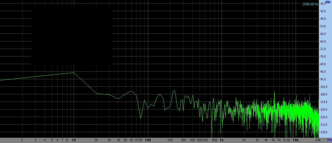

I have yet to try out the onboard sound system of my Gigiabyte 990XA-UD3 board.
I said that I would do this a while back only I haven't the time lately.
I have been thinking about it the last few days before I have to move the thing as it is taking up room for my project space right now.
I will test it with the GINA card as it's noise floor is nearly -120db or so as it has balanced inputs and outputs.
At least it is better than what Gigabyte claims their noise floor is at -108db.

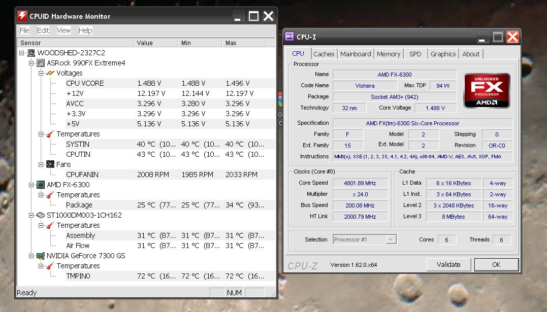

I Just got a new ASrock 990FX Extreme4 yesterday and I have a FX-6300 in it running stable at 4.8Ghz.

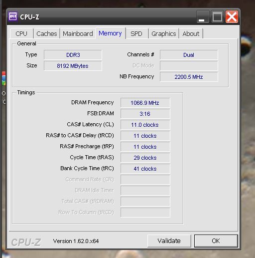

I am using 8GB of some Gskill Ripjaws X series 2133Mhz ram and it is running at full speed as well.

It was very easy to get it up to speed as it being the new Piledriver chip.
I had it at 4.9Ghz and almost 5.0Ghz but but not stable at my current voltage of about 1.488v.
The heat rises quickly beyond this point.
The ram is solid at 2133Mhz as well.
I am using a Coolermaster 212+ air cooler with two fans for now and my temps stay at or below about 64c to 63c on a 100% cpu load.
Not bad for air and this will hold me over until I get a water cooling setup.
The newer FX-6300 is certainly better than the not so old FX-6100 and I got it for the same price as the 4 core version!!
I don't have it hooked to my audio system yet but I did take a screen shot of the noise level input with nothing hooked to it and open as it sits stock using XP64 and Visual Analyzer 2011.
The board is advertised at -108db for noise or at least THX compaiable.
Clearly by this shot the inputs are better than that and there are a few pulses of noise but they never go above -108db.
I will have more on this later and I will do the same tests on the UD3 board for comparison as well.

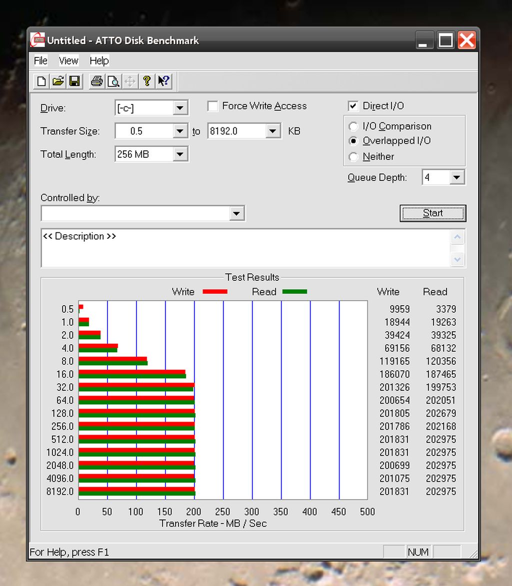

The Hard drive used is a Seagate 1TB ST1000DM003
