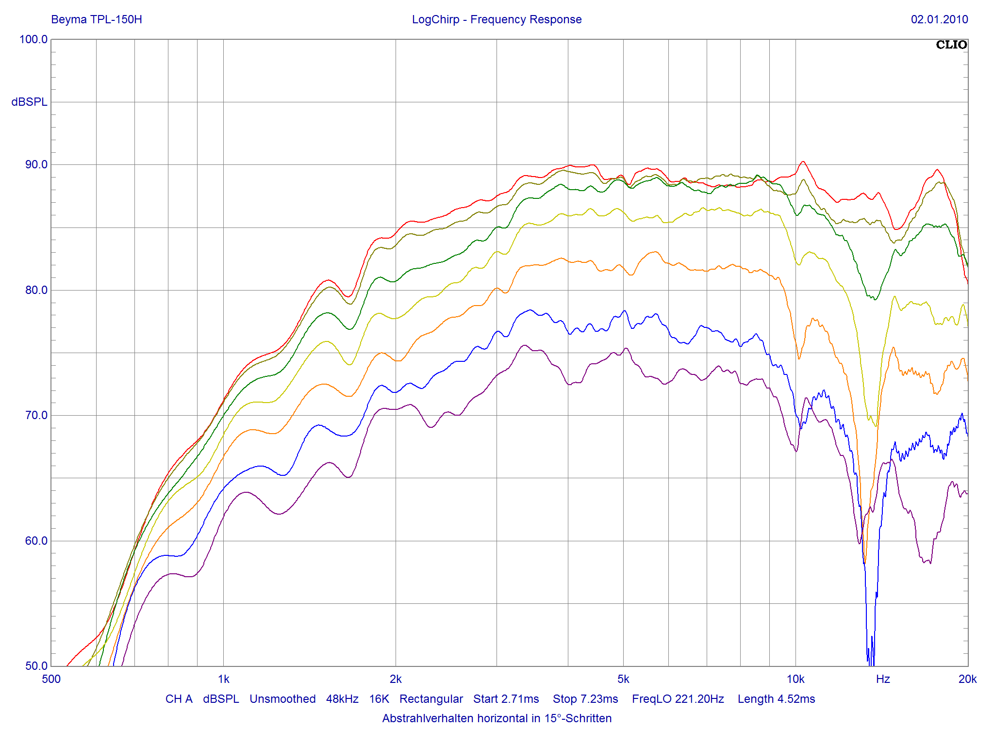

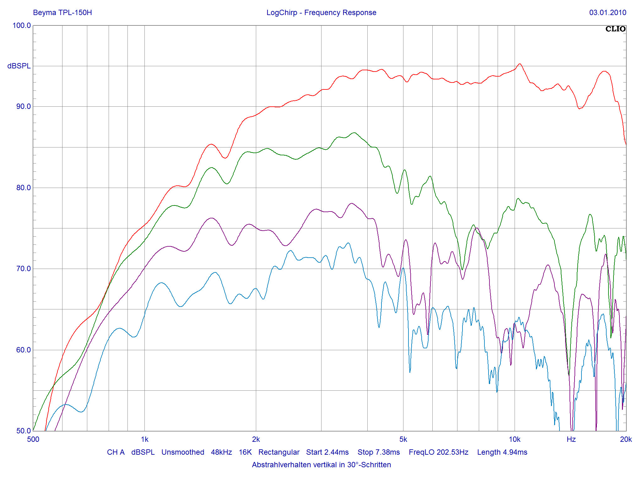

The TPL-150H: (horizontal and then vertical with 15 degree separation-lines for horizontal)
Once you factor-in the correction for a lower freq. crossover, it's not very efficient. At 2 kHz it's around 96-97 db (and much worse lower in freq.).
So it definitely needs a new horn/waveguide. Probably better to just buy the NON-horn-loaded version and make your own. Still, IF you are doing that however, you might consider another driver.
mmm...these look wrong. Very different from Beyma's curves..
It's not a corrected for spl graph.. so disregard that. And don't trust Beyma's measurements..
However after looking over other data, it appears that the average of the Beyma is higher in spl by about 4 db than what I stated (..my mistake was thinking that 4 kHz was 102 db, instead it's about 106 db. This means it's about 100-101 db at 2 kHz, around 95db at 1.5 kHz, and about 89db at 1.2kHz.
-I'd still select the Mundorf and craft a proper waveguide for it..
