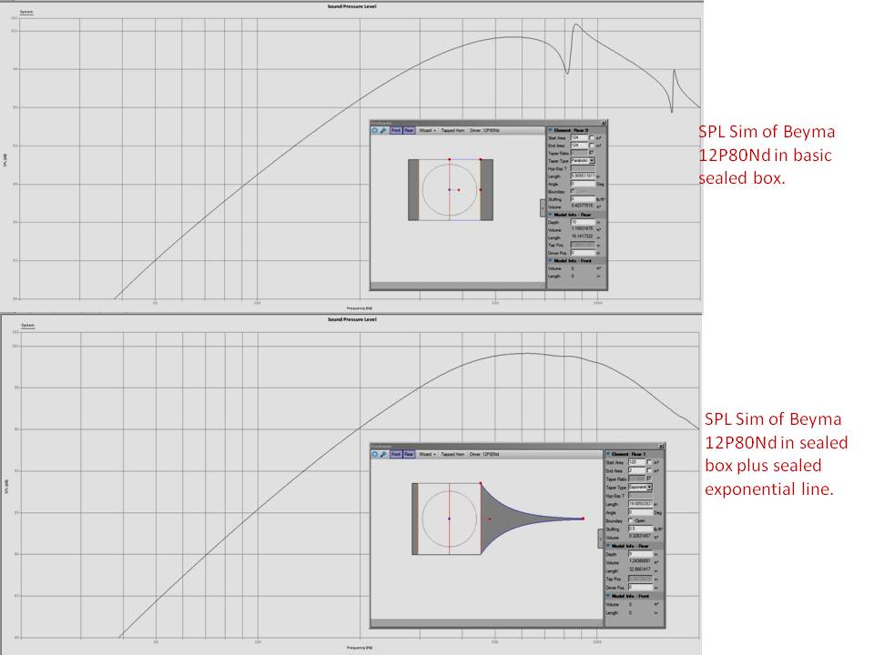

--Constructing a tapered sealed volume (simple triangle top+bottom boards) with rear stuffing behind the 12P80Nd can reduce resonances over the very wide BW.

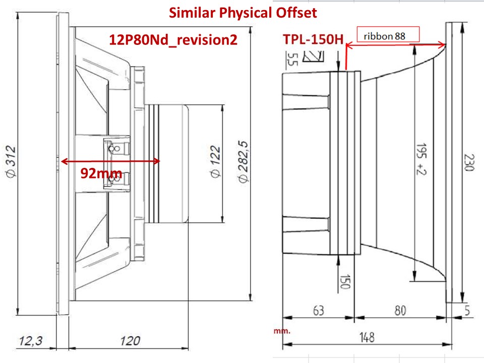

Has anyone accurately measured the time delay difference between the 12P80Nd_v2 and TPL-150H? Physical drawings suggest close time match.
