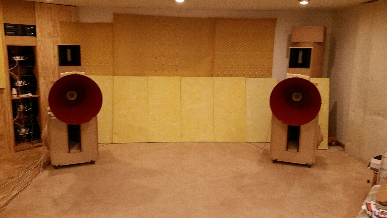

You know, we all have certain "sounds" that bother us. For me, it's nasty room reflections. I could NEVER be happy with a di-pole, or an open baffle set up. I also really hate that "box" sound. I'll be the first to admit, the big red horns you see in my picture do indeed exhibit a slight colouration, but what they give me in return with regard to dynamics and pin point imaging and the vast sound stage the entire system reproduces, I can live with it. :)

I don't use the Audax. I just like it. As you know, I use the tang band w8-1772 in a horn. 250-8k Hz. Magnificent, glorious mid range, and a seamless crossover on both sides. I know it may not look like it sounds great, but you can be assured it does :)

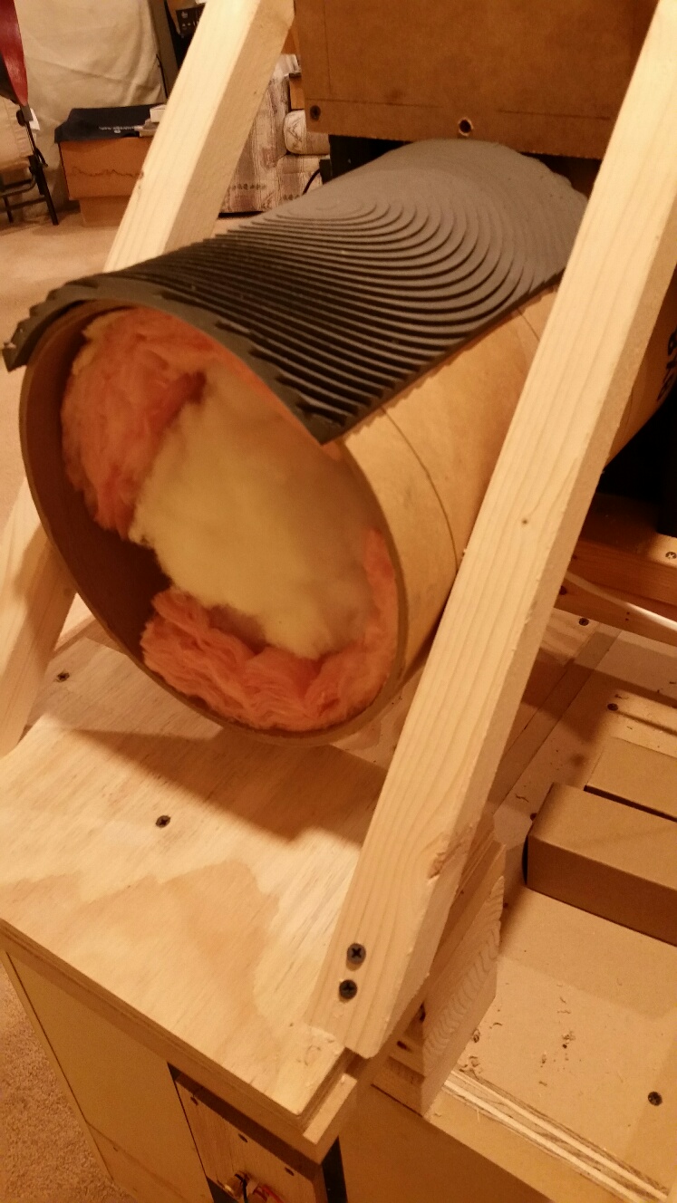

Oh, sure did ! When I very first heard this driver, I knew i wanted it. We were comparing the 1808 vs the 1772 on an open baffle, and the 1772 had a better "tone" to my ears. I owned the 1808 and my friend owned the 1772, but we each liked the other unit, so we did a simple swap. He continues to use multiple 1808's on an open baffle, and I tried the 1772 in various configurations. Further listening revealed to me that the 1772's, left to their own merits, were down about 8db at 200hz, verses 800Hz. Well, that's goes right back to a topic I had just discussed [above] and I really don't care for that "thin analytical mid range sound". This is why TB recommends a back loaded horn, because said back load provides "lift" in the lower octaves. The large round red horns I use (Vintage 1931 Jensens) lift up the lower mid range octave, but, since it has such a large throat, leaves the upper mid range intact, with the penalty being a very focused sweet spot. I have a one listener system. That's only a challenge while hosting audio meetings :)

I don't use a box, but the drivers are somewhat loaded. A short transmission line, I suppose. Short is just fine here because of the 250hz hi-pass. I don't care for open baffle or di-pole sound at all. In my humble opinion, open baffle loading for bass applications is the biggest sham since Tulip Bulb Mania.
