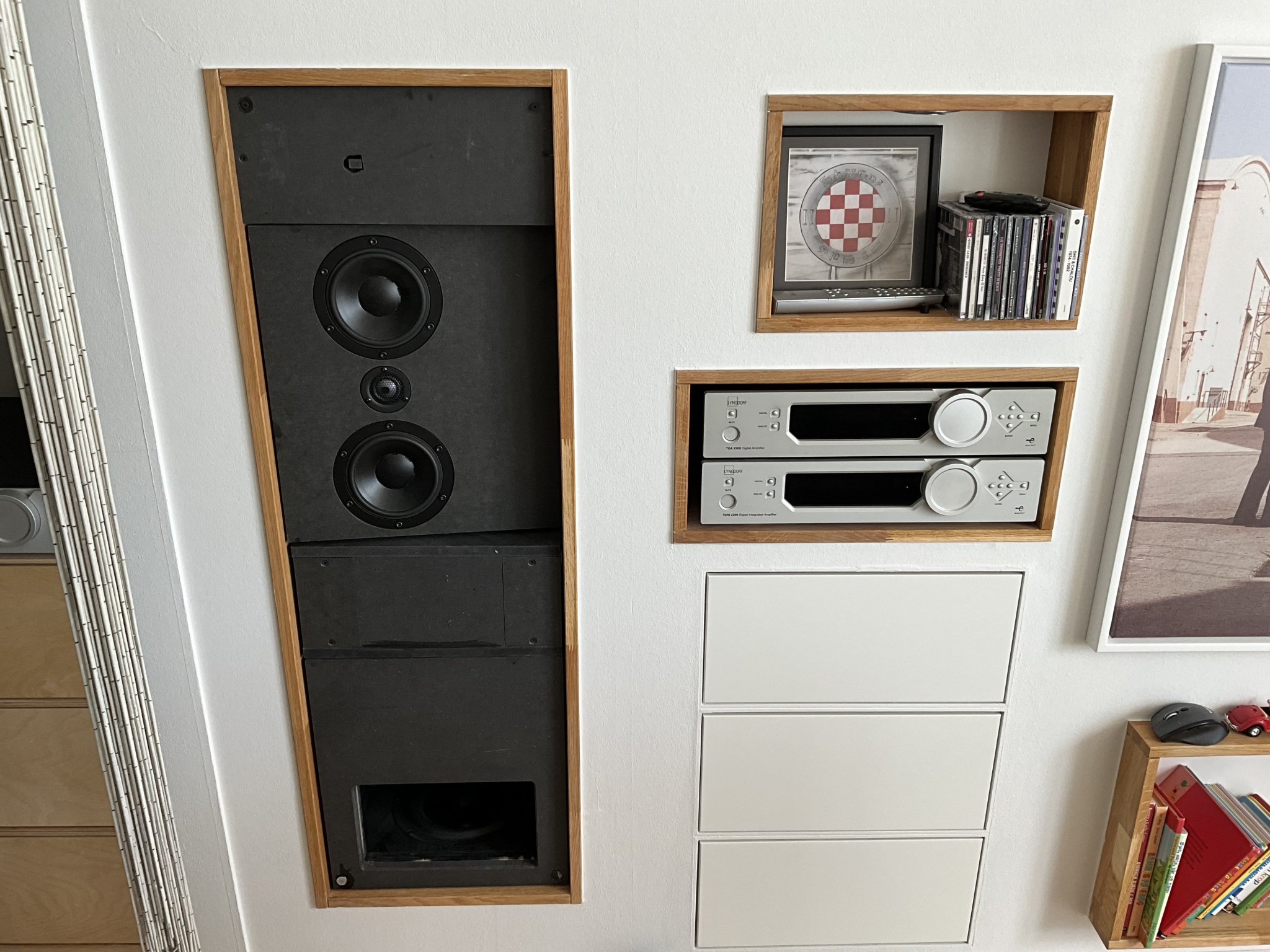

Given you are on Denmark, and are using an active system, what about using the Purify 8" @ 4ohms?
- https://ptt.purifi-audio.com/shop/ptt8-0x04-nab-01-unit-ptt8-0x04-nab-01-1964
Big diference in sensibility, but for a home use does it matter?
You would use the amplifier gain to lower the AMT levels, which will also reduce the AMT hiss.
Its a bit more expensive than the other options, but for the price you can get it in Denmark, it may be worth it.
The AE TD10/12 are great options, but you would pay more than 40% in taxes and shipping.

Sorry for not understanding anything of what you are saying here - but I guess the essence is "does it sound good?" My natural answer must be "Yes, of course". 😎
By the way - four 12" have approximately the same cone area as two 18". Displacement is entirely based on Xmax and cone area, and there is no rule of thumb that larger drivers have larger Xmax. That being said - Xmax of the Eminence Delta 12A is quite low at just 2.4 mm. When I play really loud the drivers hardly move, so a low Xmax figure is not a problem here. An open baffle dipole is also more efficient than a closed box in the frequency range I'm using them.
