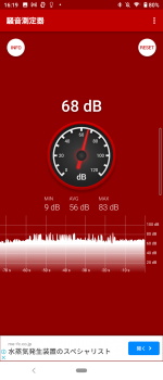

90dB is VERY loud for metal music.
Metal music usually has a limited dynamic range, so 90dB peaks probably means 85-86dB average. At these sort of SPLs you should be enjoying some slam/punch from the music. In my experience, modest sized wide-band drivers do not deliver that slam/punch; you mostly get the mids and the highs. Also due to the resonant nature of a wide-band driver cone, it is possible that the breakup is more audible and it ends up sounding a bit raspy.
In some of his posts I recall GM mentioning that the 50% of the power in music is within 500 Hz, and 50% is over that, and for reproduction of classical music and rock music, the power from 50-500 Hz is required (for classical it might need to go a bit lower).
I measured the sound pressure during air recording with a smartphone app.
MIN: 9dB, AVG: 56dB, MAX: 83dB.
The average sound pressure is not as high as I expected.
