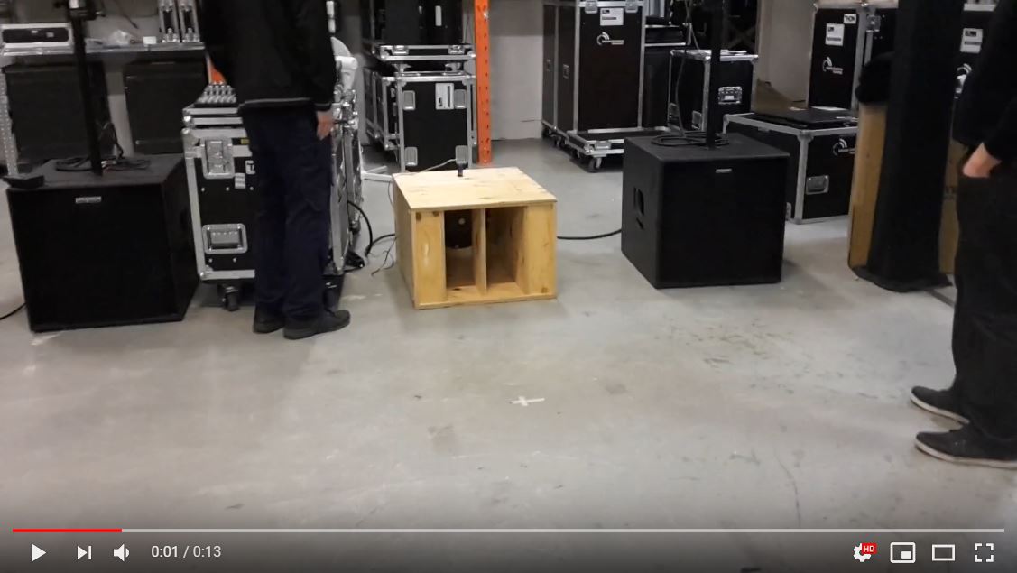

The ROAR15 is tuned to 43 Hz and is crossed over to a pair of Faital Pro 3FE22-based line sources.
This is something very different and much more pronounced then from simple 218 bass reflex boxes or similar otherwise capable systems.
Here is a single B&C 12PS100 in a ROAR12 tuned to 45 Hz sounding much more physical and tactile then a pair of B&C 18NW100 in 25 Hz tuned and DSP-EQed bass reflex boxes. The whole 300 square meter large ware house and all the interior started to buzz and shake at a much lower spl then with the two single 18 BRs.
YouTube
