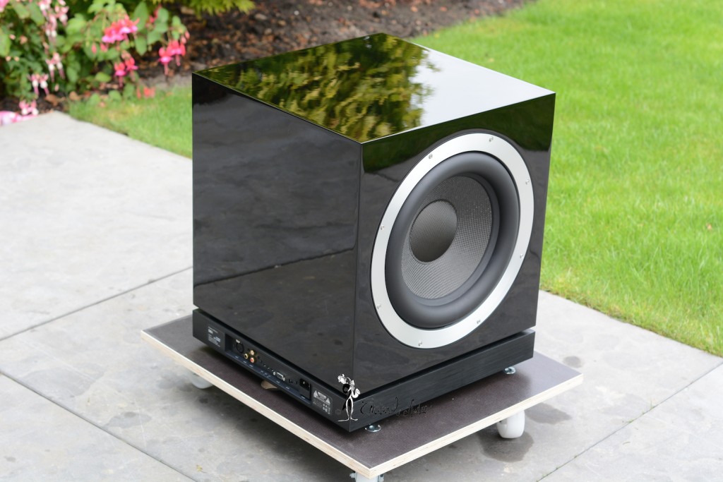

Hi.I am also after selection 2. DB1 Subwoofer have 2 pcs 12inch subwoofer drivers in a relatively small box(I think it is controlled by DSP) And it is expensive.There must be a reason of why they are doing this IMHO.Regards
