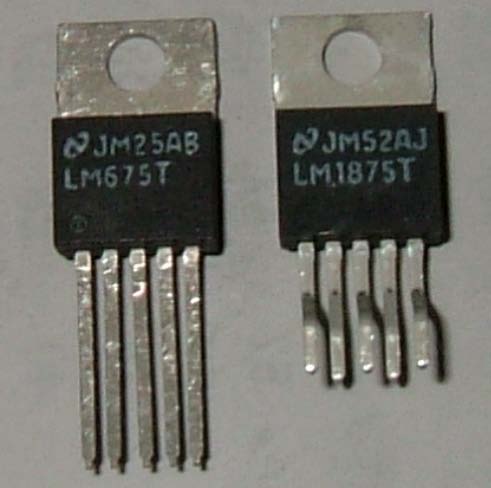

i like lm1875's sound quality, i think it may be the best chip amplifier (including lm3875,lm3886,tda7294...and so on),the only one disadvantage is that its output power is too small, from the internet,i find lm1875 could be direct replace by lm675,and the latter has higher quality in low frequency response and bigger output power, i also find that lm675 is recommended by many senior HI-FI fans abroad. so I'm interesting with it. in China's market, it's difficult to find lm675, it took me several months to get two piece, but i haven't do any esperiment on them.
dear friends:
have you use it? tell me your result, thank you!

This is the industrial version of the LM1875 with a very low quiescent current- 18 versus 70mA for the LM1875. I suspect that it will have crossover distortion.
If you need more power in the same package try the TDA2050 My favourite, hardly mentioned on this forum is the TDA7265 but that is a dual device.

I think lm675 use for instrumentation or servo controller not for audio opamp.😱 😎
