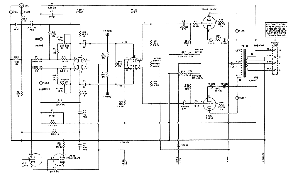

If this is so, how come I heard extended microdynamics in a SET power amp, more than any PP amp I heard?
Because most P-P amps are junk, seriously unmatched for frequency response and accurate phase splitting after the phase splitter - hence providing that great mixer, the output transformer, with two often very different signals.
A typical Audio Research power amp has two different signal paths of very different frequency responses satrting at the phase splitter, one quite direct and the other through a much longer path involving an anode follower inverter, with a large input R. This large R interacts with the tube's Miller capacitance giving a measured bandwidth of less than 20kHz, while the more direct path has three times the bandwidth. Add in the susequent phase shifts and you have a mess.
This of course leads to random cancellations and enhancements of micro signal levels - IN THE OUTPUT TRANSFORMER ITSELF - which is what you are hearing. IMO.
A SE amp doesn't have this problem, although it does often have huge levels of 2nd harmonic, which some people like.
Check out the convoluted signal path in the attached ARC D40 schematic.
