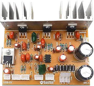

Justt buy a 2.1 amplifier, stereo in, main 2 speakers + woofer out.
They are quite cheap, add power supply and housing as per choice
A vast variety is sold, look around..

Thanks for the head's up on the alternative 2.1 power amp. I found one on Amazon for $23.00, but I would need to also purchase a 24 volt 5 amp power supply, total $41.00. The Dayton Audio amp will cost $78.00. The Dayton has 5 year warranty; good reliability and solid construction. I suppose that I will need to decide whether or not the additional value is worth the extra $37.00.
Thanks again!
Amazon India starts at about $4.00 for the amp.
Market price is about $2.50 here in local shops.
Meanwell or similar 12 / 24V 5A SMPS is within $10.
But peace of mind is also important, particularly as we grow older.
