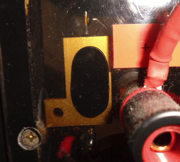

In this regard, I'll tell you about a recent experience of mine.
I wanted to replace a power resistor in the crossover of my loudspeakers from a carbon type to a wirewound type.
Since I had already modified the bases where the binding posts reside by replacing them with 1/2 inch polycarbonate sheets, I attached that not enormous wirewound resistor with "my" acrylic tape to the polycarbonate base.
Listening to the "result" there was something that didn't convince me and it seemed to me that the sound had gotten worse.
So I removed the acrylic tape and fixed the resistor with a modest amount of hot melt glue.
I was satisfied with the result and it is still fixed that way on its polycarbonate base.

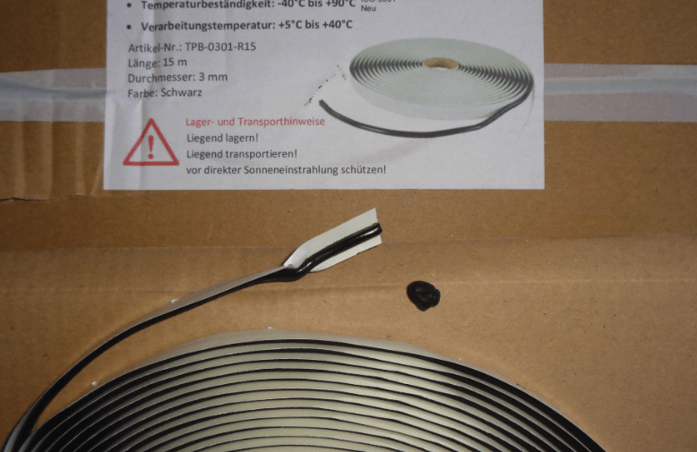

It has been replaced by butylic materials
https://www.secondskinaudio.com/sound-deadening/butyl-sealant-tape
https://www.linkedin.com/pulse/butyl-sealants-vibration-sound-dampening-
