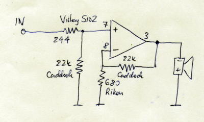

The above schematic is good, but I wouldn't recommend it anymore. My current version looks like this. Note that polarity of the speakers is not mistaken. For some reason the sound is better out of phase😉 Also, 244 Vishay is optional. I chose this value as it can be bought cheap ($3) from a forum member.

Yes but...... this schematic is so different that the other !!
Do you have the complete schematic for this amp ?? Because I don't see the value of the pot on your draw.
And what is 244 Vishay ?????
What is the value of the cap at the input ???
If you have the entire schematic, I will understand more how to do the circuit....

The Caddocks I'm using are MK132. This is the whole schematic I have at the moment.😉
The value of the pot shouldn't be more than 50k and 20k would be better. In this case you wouldn't need shunting resistor.
I'm noy using a cap at the input, but anything more than 4u should be fine. The Vishay is 244ohm, but you can use other value (200-400ohm or so), other resistor, or you might not use it at all.
For complete schematic check the previous posts.
Out of phase connection of the speakers is my current preference. Yours might be different😉

If I have a 20k pot, You say that I don't need the "shunt" resistor..... I don't know what is this resistor ???
It is not necessary to have a 4,7 uf cap ????
The only schematic I see in the previous post is this one...
This schema is complete or not ???
I just have to put a pot of 20k at the input and the power supply and the amp is ok ???

Shunt resistor is the 22k from +input to ground.
If your source produces very low DC offset or has capacitor at the utput, you don't really need the cap at the amp's input. If you not sure about it, better use it.
So the schematic is complete. Just add a pot and a power supply.

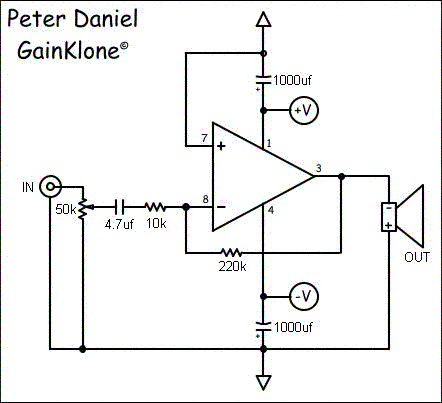

More complete schematic is posted here: http://www.diyaudio.com/forums/showthread.php?s=&postid=301095#post301095 however I don't find it that appealing😉

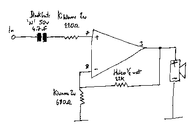

After spending MONTHS reading all the available posts I have nearly got all the parts together to build my 'Patek' clone - special thanks got to Peter Daniel for all the inspiration his amps and design choices have given me.
I would be greatful if someone could clarify for me that what I am about to build is technically correct before I embark on the construction of my amp.
I am using Peter's schematic with a few minor changes:
1) Input cap to protect from DC - 4.7uF 50v Black gate N series cap
2) Kiwame 2w 220 ohm resistor to + input
3) No shunt resistor to ground as my (seperate) pot in a box will be a 20k log Alps Black beauty
4) Kiwame 2w 680 ohm from pin 8 to ground
5) Holco half watt 22k for feedback
As stated, the 20k ALPS volume pot will be housed in a seperate aluminium box. My Gainclones will just be configured as power amps only.
I have attached a scan of my circuit. If anyone can see any obvious faults with what I have done please shout :smash:

John, if you don't use a shunt resistor to ground AND you have the pot on a separate box, I would advise you to put the resistor back.
If you power on the amp and forget to connect the pot you'll have huge DC on the output and you may kill your speakers.
In your case, use a 100k resistor on the RCA inputs of the amp.
