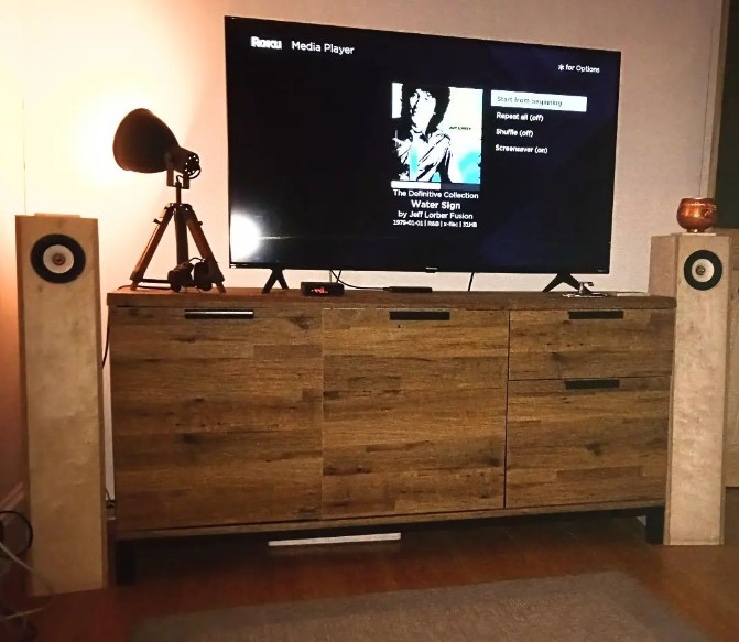

I bought a pair of Chinese full range speaker clones. Namely the Audio Labs DQ40TZF-02 8ohm 4 " drivers. I wasn't expecting much tbh. Build quality was very good and they had a good weight to them., so encouraging stuff. Cone varies in description from Bamboo to paper to mixed fibres so take your pick.
As for sound? well, every other 4" driver I have tried, and I have tried several believe me are not, are not as accomplished and engaging to my ears as these. Especially in the high registers where for whatever reason they shine. Overall, I find them very musical and satisfying in my Frugal Horn Mk 3's.
Subjectively, are they the best I've heard? They are at the minute, so presently these are my choice.

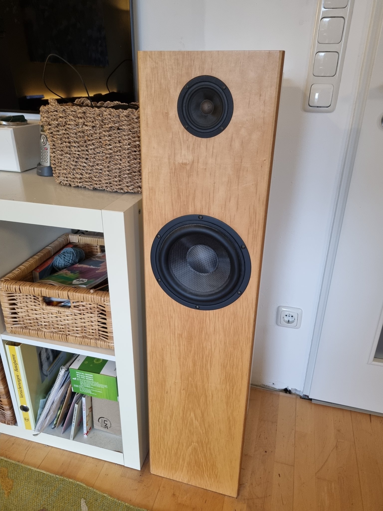

Hello Forum
I built a FAST system 10 years ago using Vifa 10BG120/6 and Visaton TIW 200 XS in two separated closed volumes. Controlled by an DSM-240 with X0 at around 400Hz.
I think I made a mistake with the Vifa because it was always very limited due to only 0,8Xmax if it's getting serious. I want to correct this now by replacing the Vifa.

I wouldn't necessarily say you've made a mistake. Plenty of very good 2-way systems use wideband mid-tweeters with that, or less, rated linear travel. Don't forget, Xmax in itself doesn't have much meaning -there isn't even a single definition for what it even is (I stopped counting definitions at about a dozen, most of which give different values if you apply them to the same drive unit, and none of which really give you much in the way of useful information).
Be that as it may, if you're concerned about power handling, before buying another driver, I suggest you try to raise your crossover frequency to above 500Hz with the existing setup. Most music power demands fall below that point; above 500 or so it falls off a metaphorical cliff (slight exaggeration, but only slight). The pioneers settled on 500Hz or 800Hz for their 2-ways, partly for this reason and the laws of physics and engineering are the same now as they were then. You don't say what the filter order is, but if it's relatively shallow-slope, could also increase the order to take further stress off the mid-tweet. Assuming the Vifa doesn't have severe HD issues, which is unlikely, you'd have to be really pushing it for distortion to be a major problem after that. FWIW, on paper, LR4 acoustic HP gives the highest power-handling of the common flat-summing filters, at least in terms of driver excursion -better in fact in that sense than higher order types.
Sorry, I should have been clearer. HD = harmonic distortion. In this case, I should have written something like 'assuming the Vifa doesn't have severe rising / spiking 3rd or higher order harmonic distortion in this region, which is unlikely'.
It'll be higher, but I doubt it will be excessive. Granted, 'they who do not measure do not know' 😉 but in the absence of that, and balancing probabilities, Vifa usually had decent enough motors. Either way -since it costs nothing other than a bit of time, I'd say it's worth trying before hitting the credit card!

Hello, as Scott moose said I would just put another slope filtering the vifa.
With active filter Beheringer DCX you can choose 24db filters.
Maybe active current drive amps bring distortion further down.
