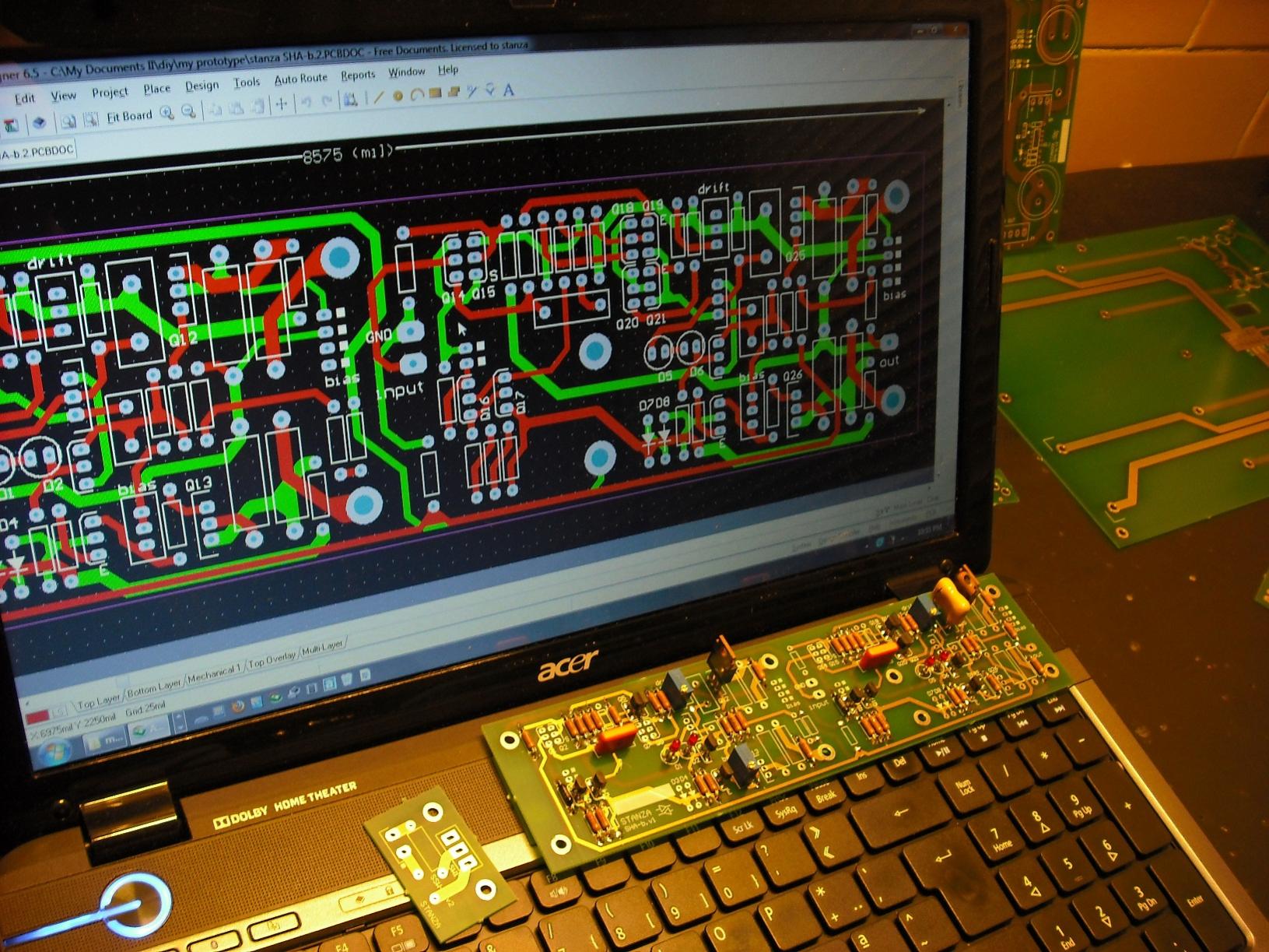

hello dgta
I use Altium Designer. simply the best we had today. All my prototypes are made ​​by this software.
link:
Altium | AD10

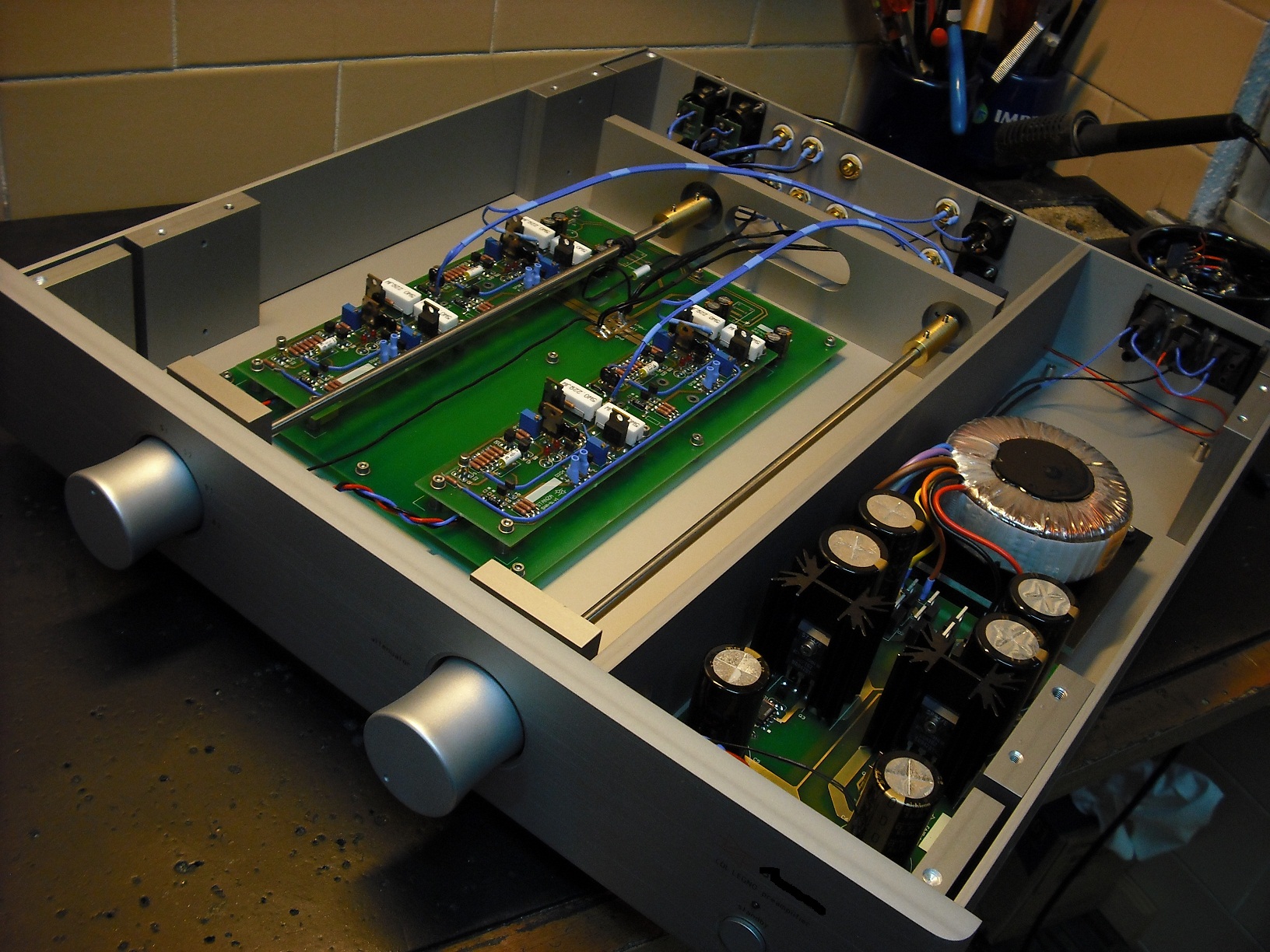

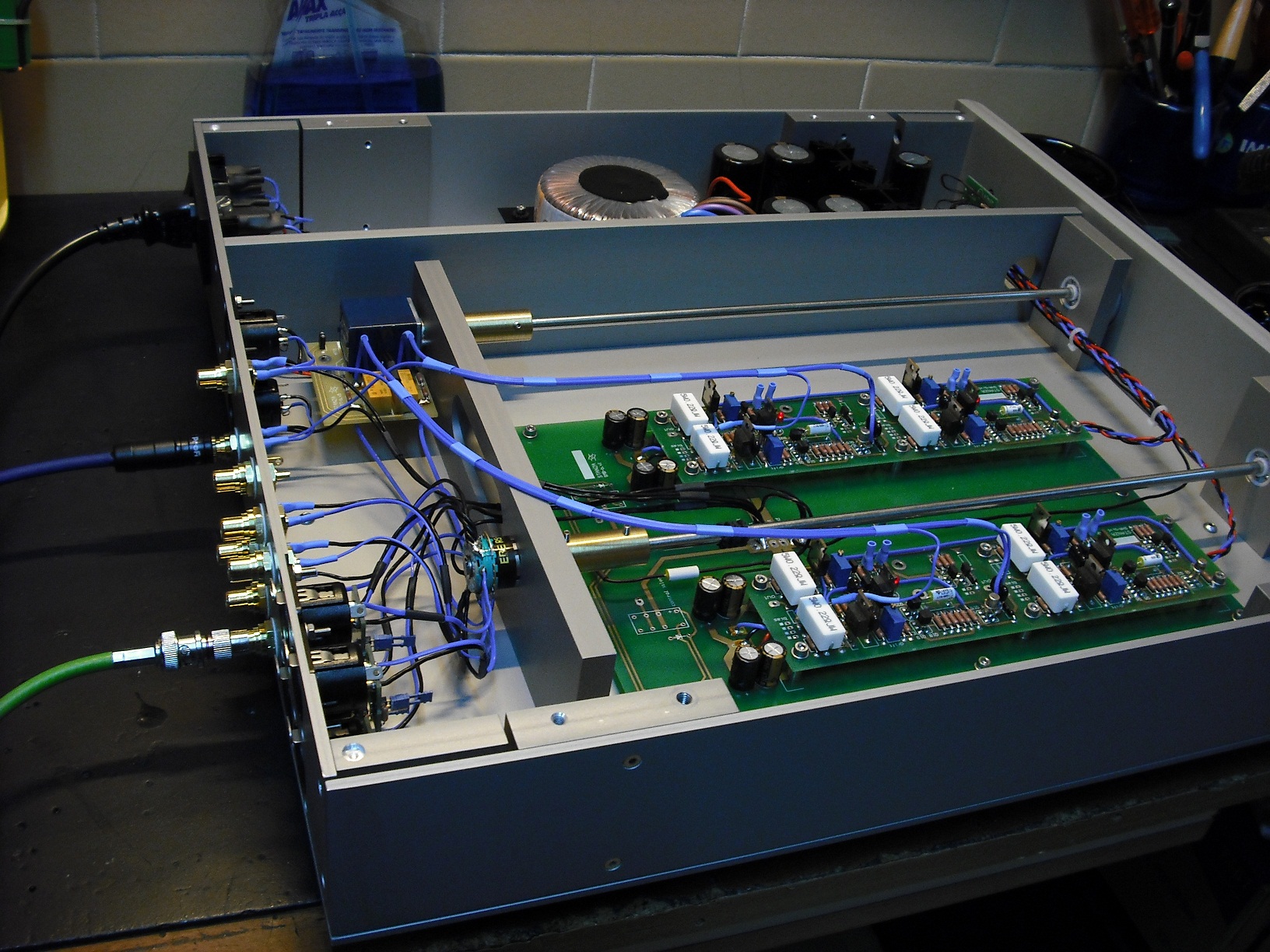

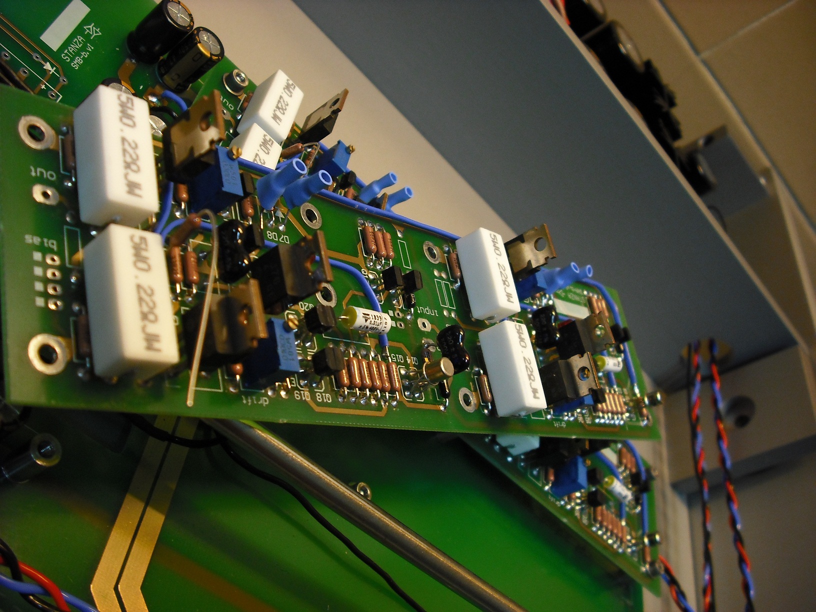

My latest prototype (pre amplifier using a personal topology ) was this pre amp that I attach a photo
