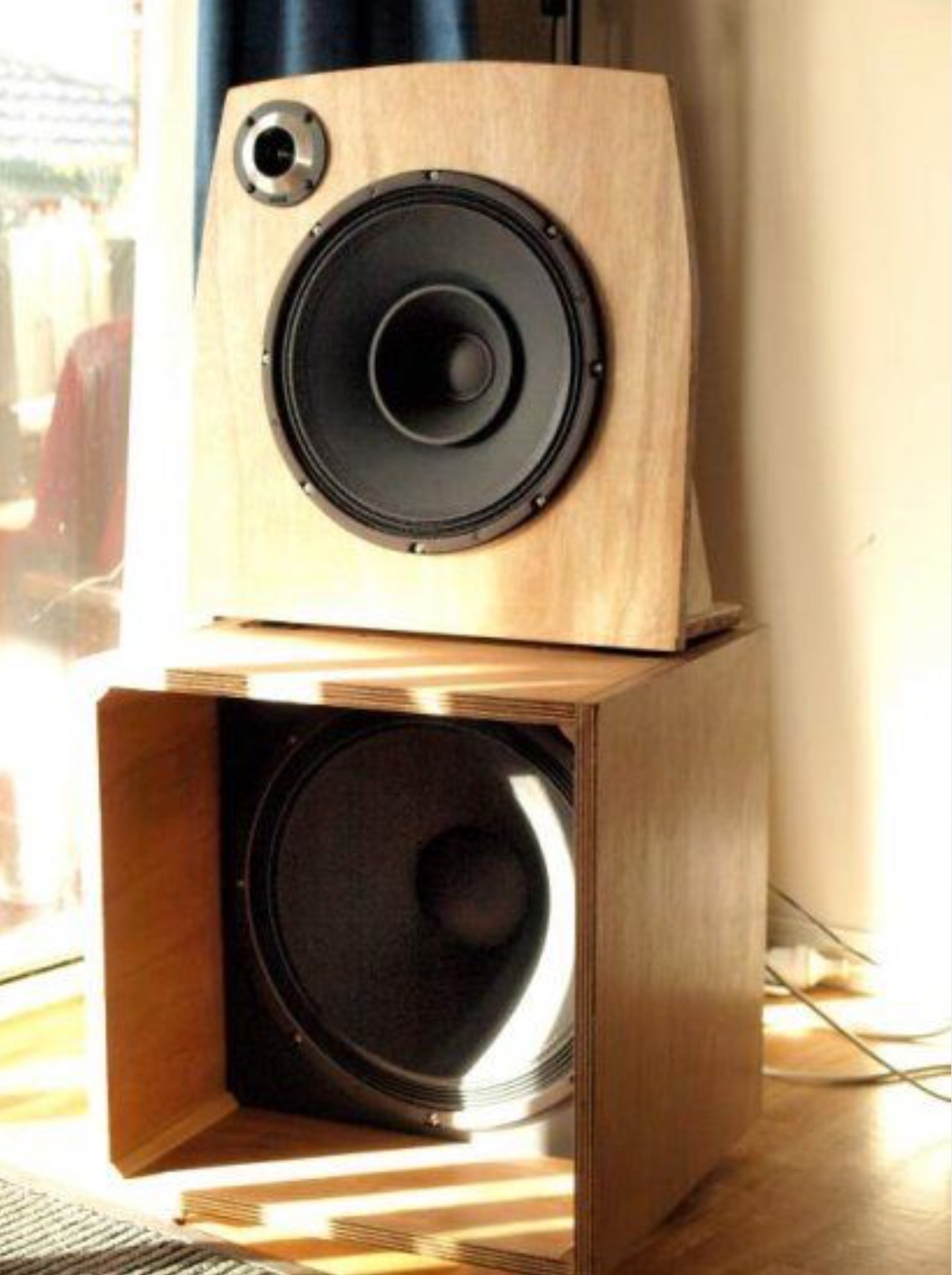

My room is about the same size. My couch is approximately in the middle of the room facing the speakers on the short wall.
In your room, I think the AN15s will work well.
I'd put them on OB on top of H-frames.

I am still looking at everything. My primary goal is to avoid crossovers between, say, m/l 150Hz to 6 or 7 kHz. I was wondering about something like a mid-woofer, like Silver Flute or something, that can cover to that upper limit, and then something like a dipole AMT to cap off the top end, and of course, the sub down below.
Does that sound any better to anyone?

You might want to take a look at the Pi series - particularly the 4 or 8?
Pi Speakers - Product Line and Driver Complements
For those bottom registers you want a system capable surviving below 20Hz, and a pair of separate subs with 12" or larger drivers supporting a high efficiency 2-way with compression driver mid-tweeter could be your best bet.
I've built a couple of systems with the Heil AMTs - one was rebuild of AMT1 into a 3-way with Eminence 6" midrange and the factory woofer/ PR. While IMHO the AMT driver is still one of the better mid-tweeters around, I think it's not at all practical for your intended application.

Well, I guess other than the price (currently $319 USD each before shipping and taxes, direct from ESS Labs) and the dipole radiation pattern that might not be suitable depending on intended location, there may not be any reason not to use them - but I think a compression driver and controlled directivity horn might be a better bet.
Don't get me wrong about the AMT - it's a stellar driver in the right application.
I was looking @ Parts Express that has some from 20 bucks. I appreciate your input on the dipole bit though. Having not heard them personally, I just don't know this kind of stuff, that's why I ask!
~Scott
~Scott
At $20 ea, probably this little guy - a cute little unit suitable for a small 2-way
Since Ocsar's patent expired, there's been lots of folks jumping on this bandwagon, from the likes of Dayton to Mudorf, Beyma, and no doubt others.
The only non ESS AMT I've heard was the larger Dayton AMT PRO4
Not a bad performer, but at approx $150 ea, not in the same class as the Great Heil
Both the Daytons are monopoles
All of which as I said before is probably moot to the application under discussion .
Now, the Beyma TPL-200H and 12BR70 12" woofer, that could make for a stunning system, but now you're at just under $800 per side, before taxes and shipping, for just the drivers.

I hadn't paid attention that this was an organ application. I wouldn't spend the money on the AN 15" for that - it's worth it for hi-fi but I'm not sure it would be justified for an organ unless it was designed to take advantage of the fidelity. I thought organs used relatively simple drivers - there's always a few old ones turning up on eBay.
Many of the organ manufacturers provided speakers along the Bose philosophy, i.e., very little technology with as much fanfare and mark-up as possible.
Organ pipes, especially soft flutes, have a remarkable amount of overtone structure that requires careful attention to reproduce. At the other end of the scale are the loud reeds like the French Trompettes, whose harmonic detail is anything but subtle! Many colleagues utilize separate groups of speakers to reproduce separate stops, or groups of stops, to isolate these timbres. Hauptwerk (the operating system) allows for (I believe) up to 130 separate channels, so some individuals have gone so far as to utilize a separate speaker per stop, thus allowing all the voices to mix in the air as pipes would!
I, myself, would have to win the lottery to afford such a system, and the room to put it in. But the point is, don't knock hi-fidelity, just because it's for an organ! When we say it's pretty, we don't just mean pretty loud!
