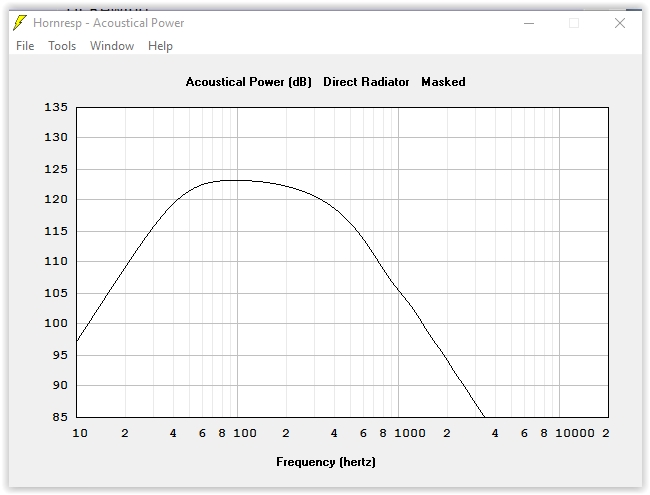

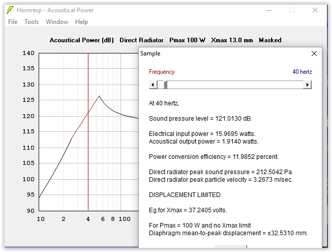

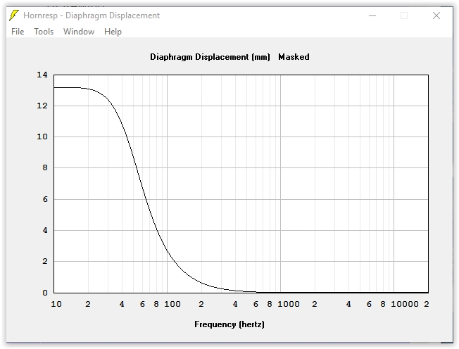

I'll attach a Hornresp simulation (it's a tad larger, but it doesn't matter here):
  • LAB12CB.txt
    LAB12CB.txt

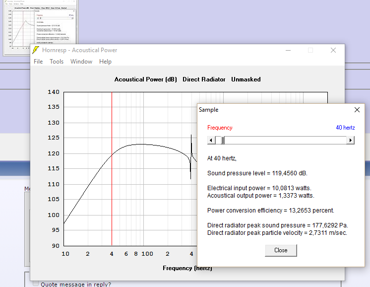

Hornresp can help you to determine what the maximum input voltage to the speaker should be.
Set Eg to a value where Xmax is not exceeded within the desired passband, and take a look at individual sample frequencies in the SPL graph, and see that the rated speaker power is not exceeded.
If you use the 'Filter Tool', e.g.: 30Hz 2nd HP, the displacement will now peak @ 9.5mm/38Hz; then you can see how much more Eg you can dial in to get the displacement back up to Xmax, and if the new power exceeds rated power...
