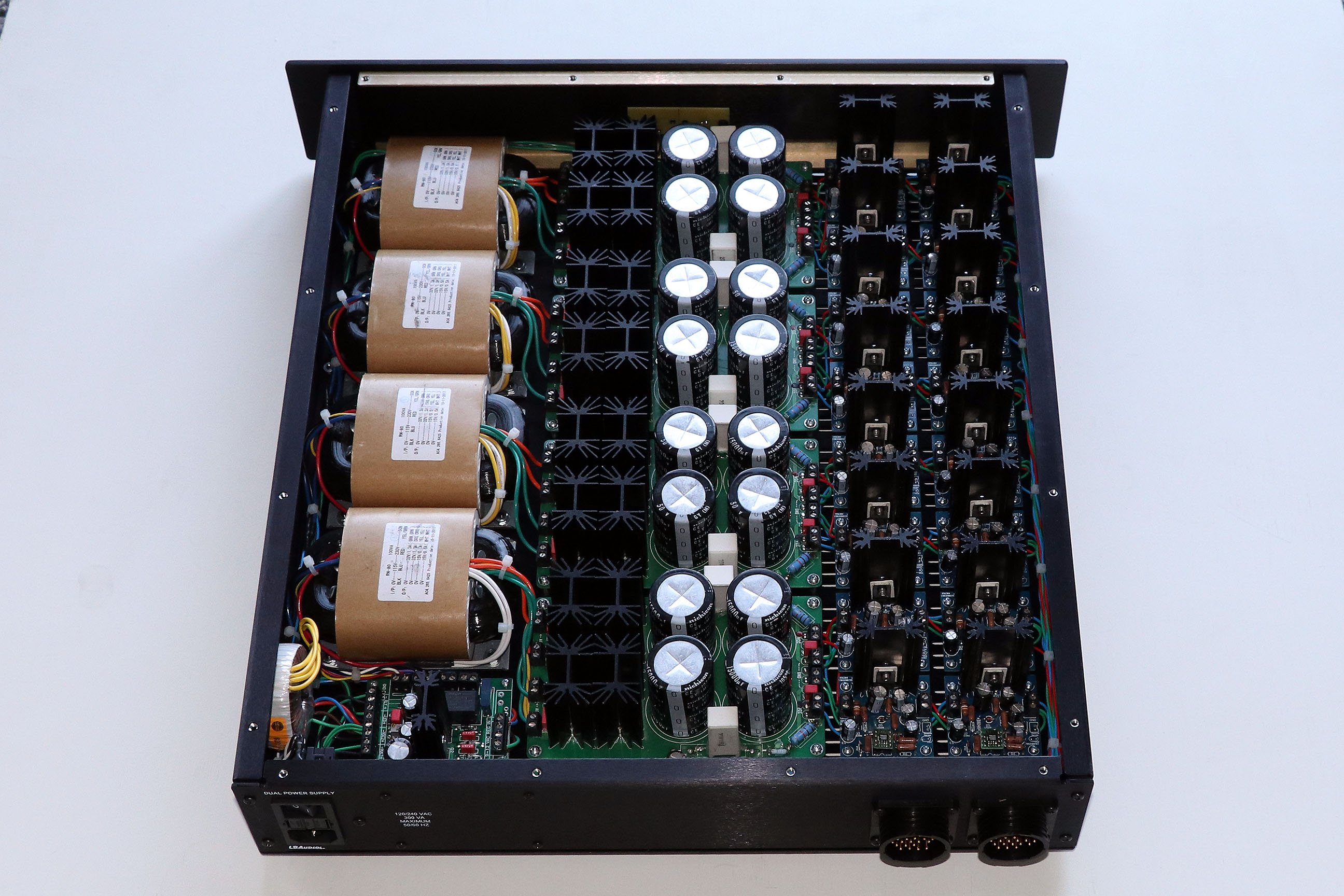

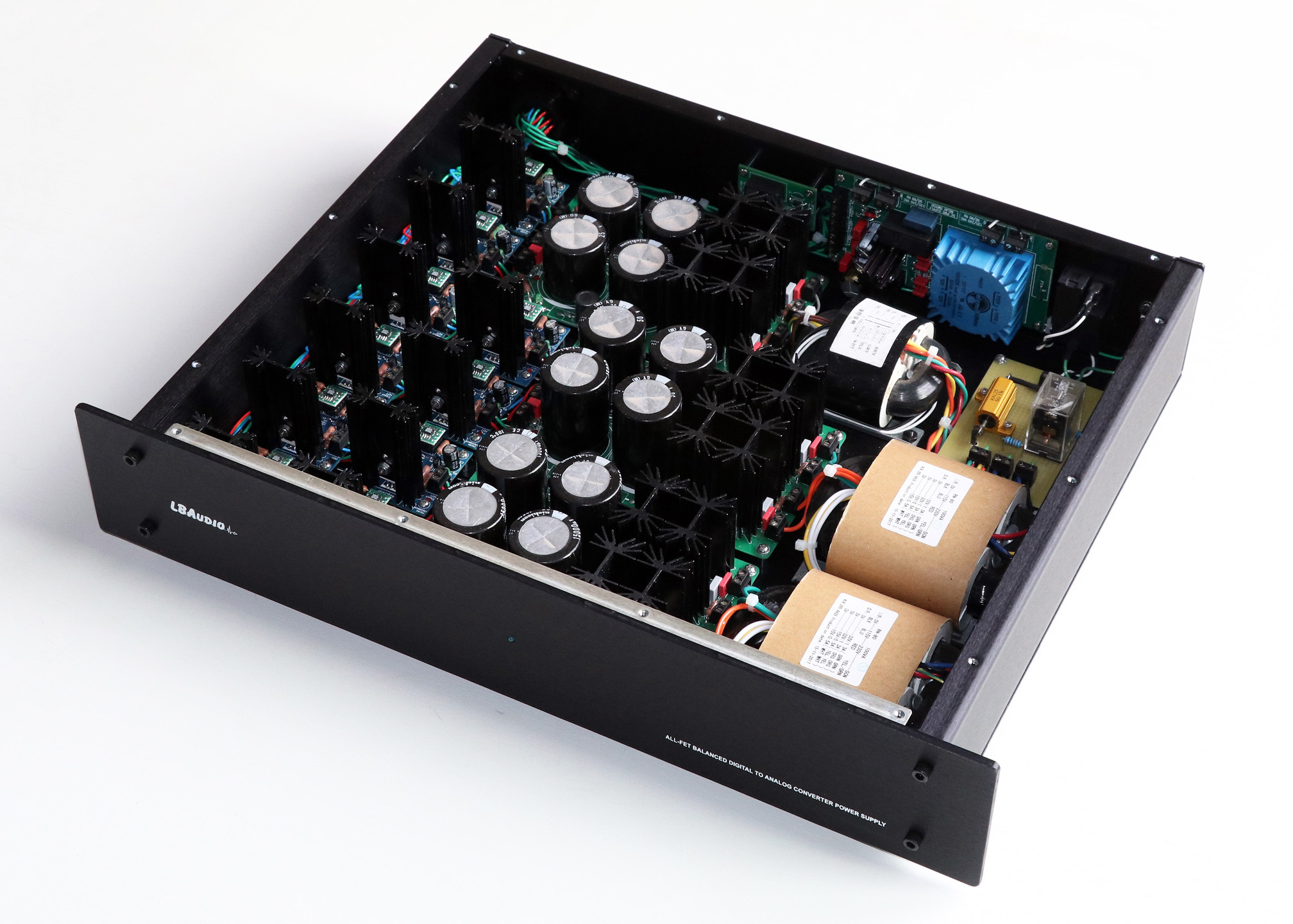

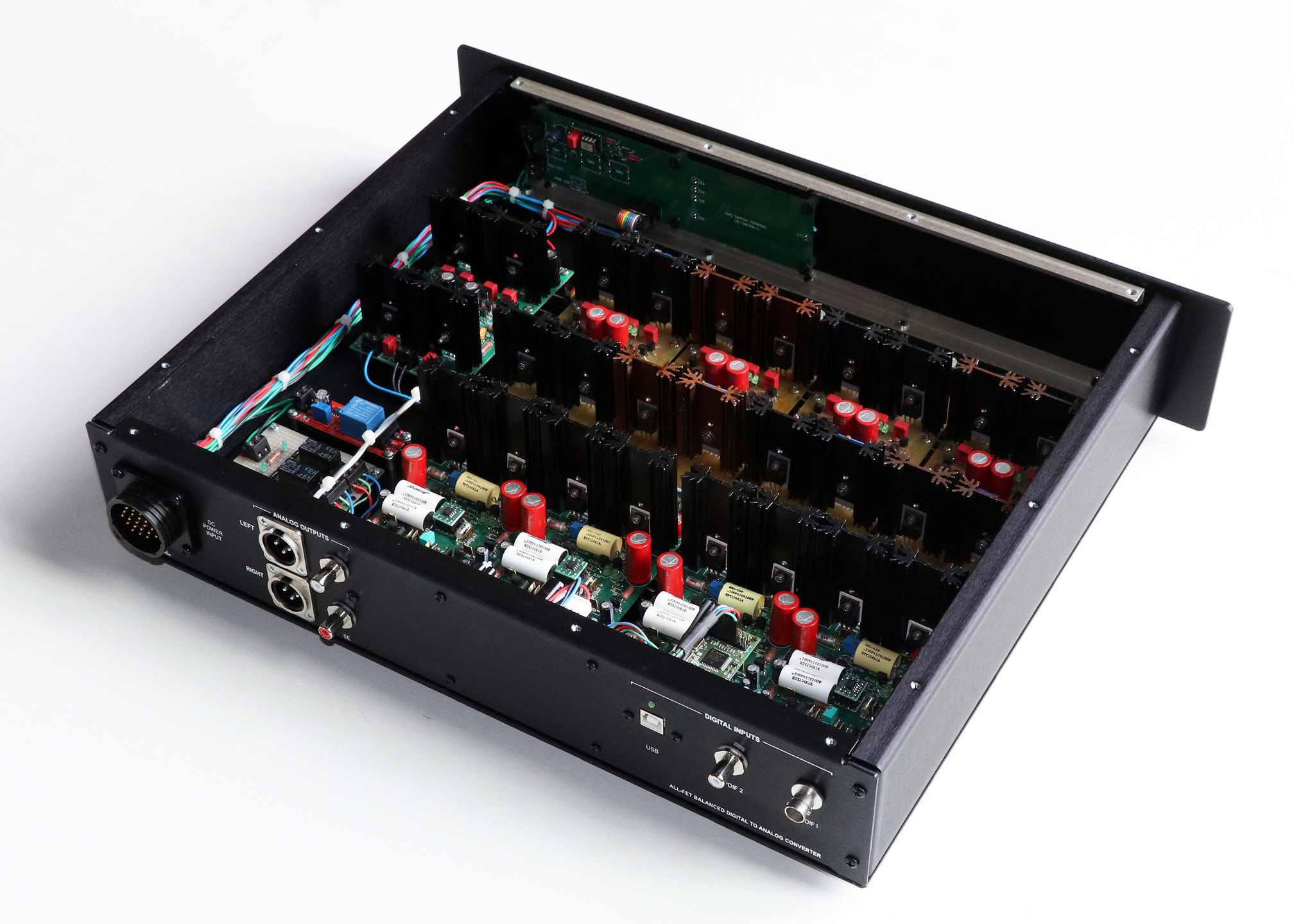

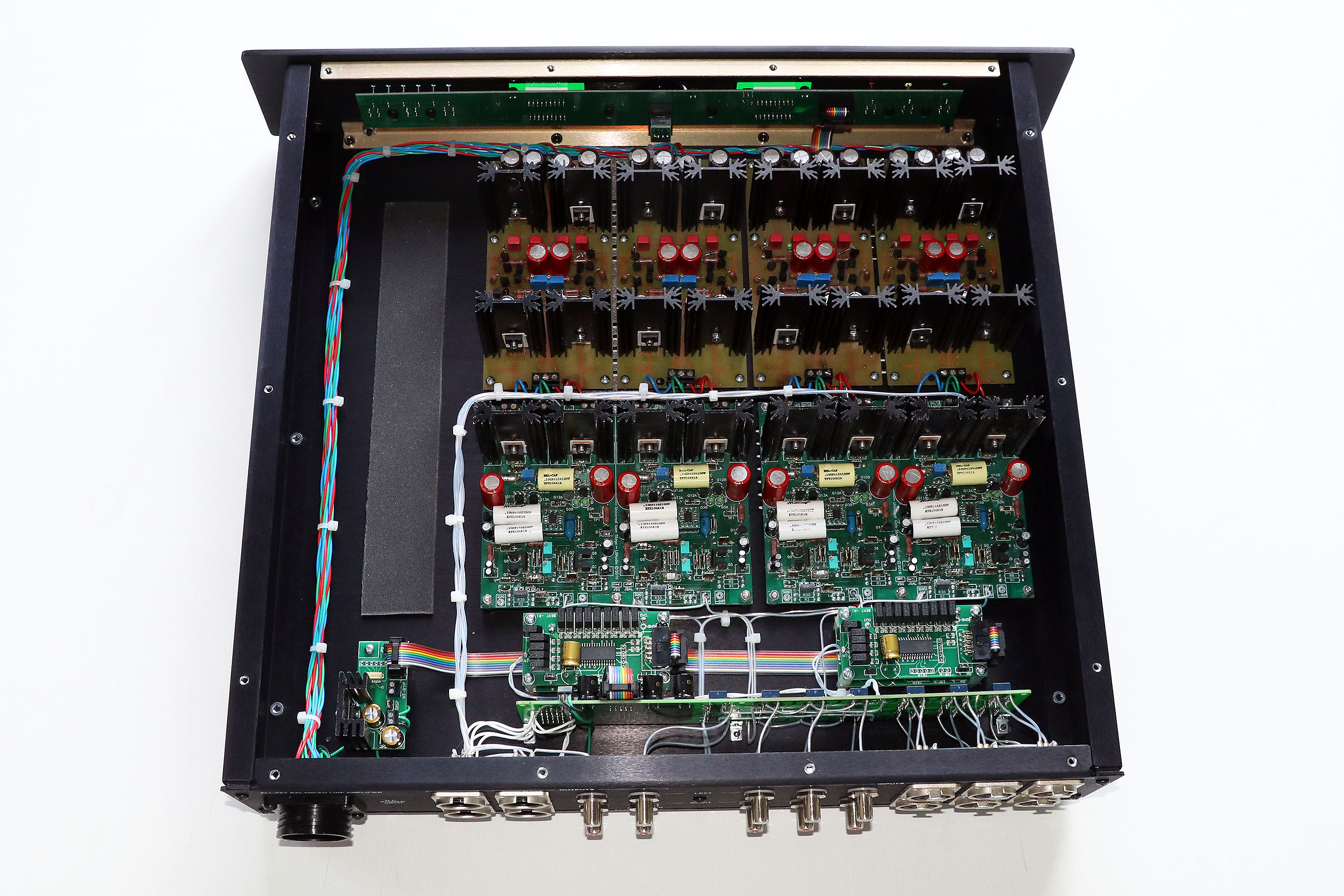

My system is totally direct coupled discrete Class A jfet/fet fully balanced design up to the full range ESL. it does have 16 fet shunt regulators with Jung Super regulators as pre regulators , which use electrolytics. They use Monty McGuire’s suggestion for a servo opamp of very low noise. Heres the dac and line stage and thier power supplies, designed by Erno Borbely, boards by me, and assembly by Les Bordelon. Now show me something you’ve built that would convince me you could hear the difference.
