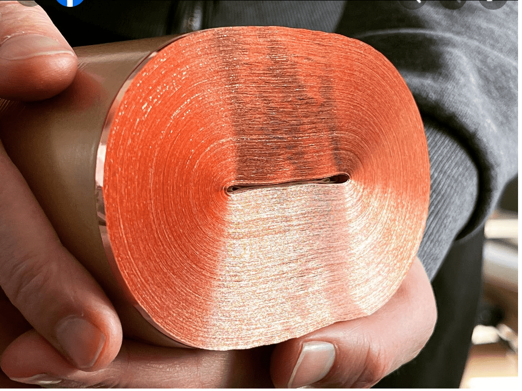

Will never stop diy's ....we try all that we hope will sound better ,box too for avoid eddy current

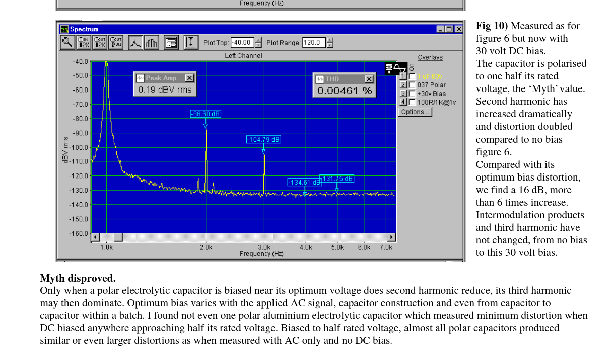

as early as 1980 it is known that, biasing the ecaps with voltage gives good results...i believe it was mentioned in the Audio article, Picking caps....Tony you can have all .... mythView attachment 1207542
