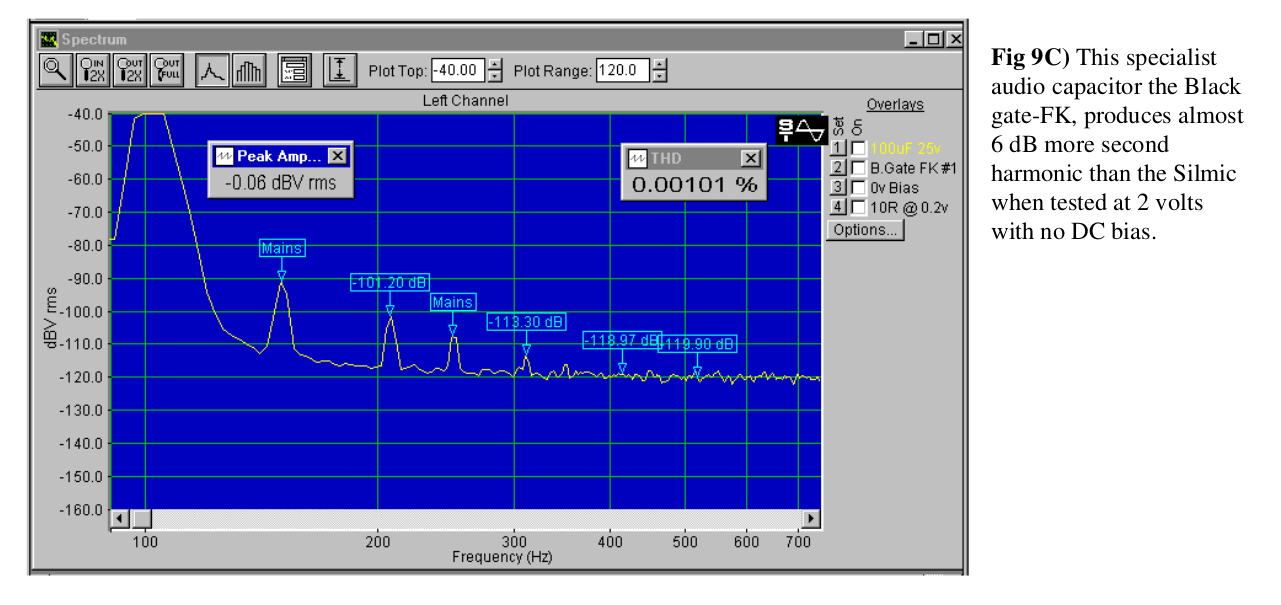

I saw this the other day, buying some Silmic II to decouple Analog +/- pins of a PCM63 design I am working on. Time to buy them in the hundreds and hope I can sell them for 100x original price in 10 years? 🤔
He said, sheepishly.I was really surprised and happy with the Elna silk caps -- tested them out on my AP and the distortion was really de minimus. Happy and surprissed because they really deliver a lot of value per money.
I haven't been able to tell the difference between Mills, Riken's and the Caddocks -- my baaaaaad ears, I guess.
