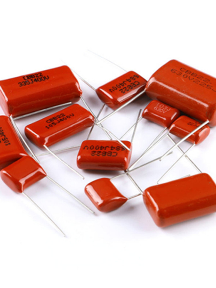

I'm happy with the Panasonic ECW, but I wonder where they're made; they look a lot like the Chinese CBB, and priced about the same too.
Most underrated capacitor probably.I'm happy with the Panasonic ECW, but I wonder where they're made; they look a lot like the Chinese CBB, and priced about the same too.

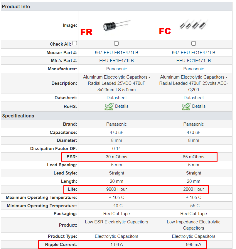

Panasonic FM and FC sound horrible. I use to use them and learned it was all a mistake. Very low ESR doesn't translate to good music necessarily.

The Panasonic FC are excellent but they should not be used alone in a circuitry. FMs are less good to me because their mid highs that often are fatiguing when used at power bank or smoothing...but rare cases.
Esr here is not a good information as FC and FM have very simikar esr but sounds tottaly different.

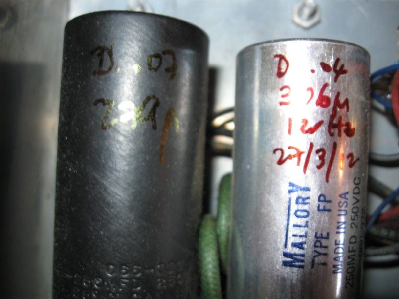

Because this is a 'lytic thread, here's a couple of datapoints: I bought my McIntosh, used, in 1978. Tested the main caps 10 years ago, and check out the "D" (dissipation factor). Everything exceeds specs!
I service Leslie amps that used Mallory FP cans, and there was a period from about 1969-1973 when Mallory appears to have made capacitors that greatly exceed expectations for long-life for reasons I'm sure we'll never know. They may have used chemicals that are now banned. But I have a 1971 Leslie amp of my own that has its original Mallory FP can that still tests perfect on all tests, ESR, impedance bridge, and full-voltage leakage. If you go to ~1968 and older, they will usually have at least one section that is going bad.
What I'm saying is that the early 70s Mallory FP cans are outliers. Mallory was doing something right that even they couldn't maintain. And that's something to keep in mind. Not all product lines are consistent over time.
