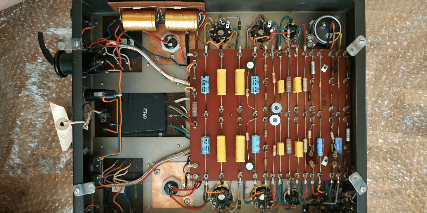

Thanks for the caps suggestions: it's for the cathode bypassing of a Leak ST60 EL34 PP tube amp, and the axial types are preferred. Looks like nobody makes them anymore. The amp itself is not great with a dominant pole at 3KHz, and a blurrily vintage sound to match. I wonder where it got its reputation from? Anyway, this is its last chance if I can't fix it up good, I'll eBay it.

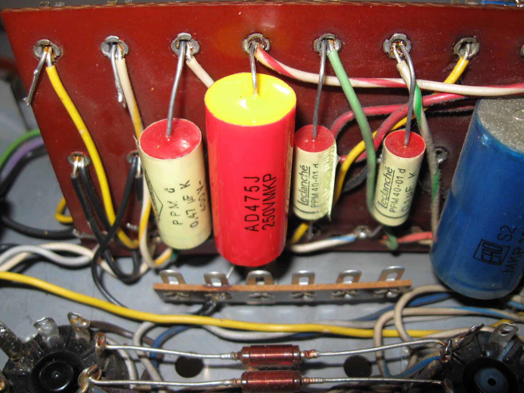

I think F&T of Germany make them. And F&T themself have a genealogy that can be traced back to Leclanché of Switzerland who used to make some pretty good MKP caps. They even made them to order! This is what I have in my McIntosh instead of the original bumble bees:Following up, Zung the Mundorf electrolytic caps look hopeful, but who really makes the cap?

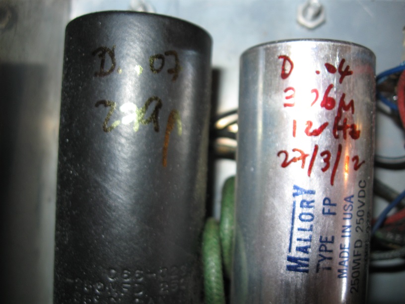

Because this is a 'lytic thread, here's a couple of datapoints: I bought my McIntosh, used, in 1978. Tested the main caps 10 years ago, and check out the "D" (dissipation factor). Everything exceeds specs!
