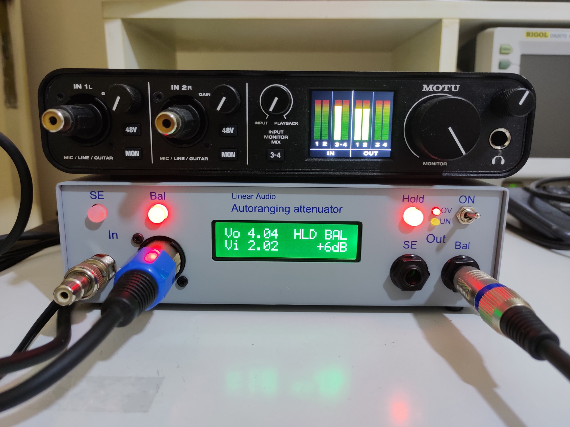

This gear serves my purposes well. The Linear Audio Autoranger is a great tool that overcomes the weaknesses of a sound card measurement system, most importantly their maximum input voltage. Stuart Yaniger measured it in audioXpress using an Audio Precision APx525 and an APx555: https://audioxpress.com/article/fresh-from-the-bench-the-linear-audio-autoranger-mk-ii-interface
"...this product enables users with high-quality sound cards or recording interfaces to perform measurements to the level that is usually reserved for extremely expensive professional-grade audio analyzers. Indeed, its performance required the use of the newest and most elaborate Audio Precision system to characterize, and it greatly exceeded the performance of the APx525 I use day-to-day in my lab."
I pair the Autoranger with a MOTU M4, a budget-friendly audio interface, my loopback measurements here: https://www.audiosciencereview.com/forum/index.php?threads/motu-m4-loopback-measurements.10890/
Greater performance with this setup could be achieved pairing with something like a MOTU UltraLite-mk5 or an RME ADI-2 Pro FS, however I am working with tube-based circuits primarily, so the MOTU M4 is more than satisfactory.
Coincidentally we use the same test gear 🙂

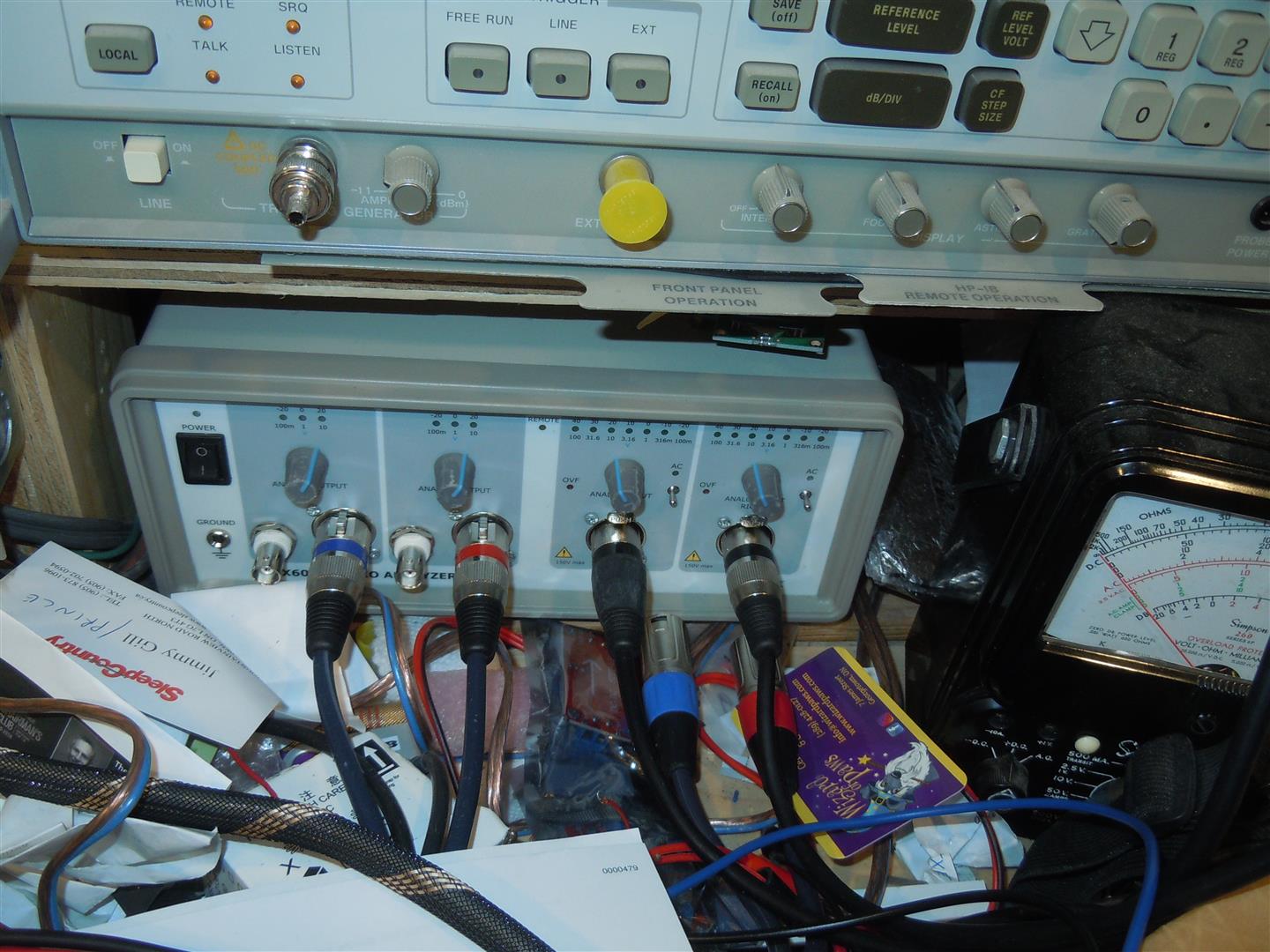

Hi L0rdGwyn,
What you have is more than adequate for tube based equipment. Stuart is a friend of mine and I am more than familiar with his work. He is careful, capable and honest. His AP gear is easier to use than mine by a long shot. What I have is somewhat easier to use than what you are using, but you get excellent results if you are careful. Having said that, you are also aware that interpreting your results takes some experience, but it is all there to see. I'm sure you also know that your test setup for whatever you are measuring is important too.

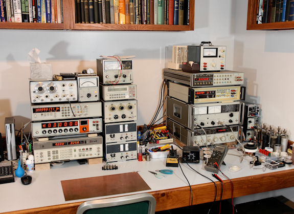

My bench is an embarrassingly massive mess at the moment, but here it is. I have other equipment I bring out as needed and you can't see the GPS receiver for the 10 MHz frequency reference. Lower right is a Keysight AC power source (6812C) I can use to inject specific noise on the AC line, or very precise voltage and energy readings. The last shot is an RTX 6001 Audio Analyser. I use it with M.I., or Arta (paid) for quickie stuff. Some equipment is used in conjunction with other pieces which gives greater insight as to what is going on.
Hi Salas,
I only wish I could keep my work area as neat as yours is.

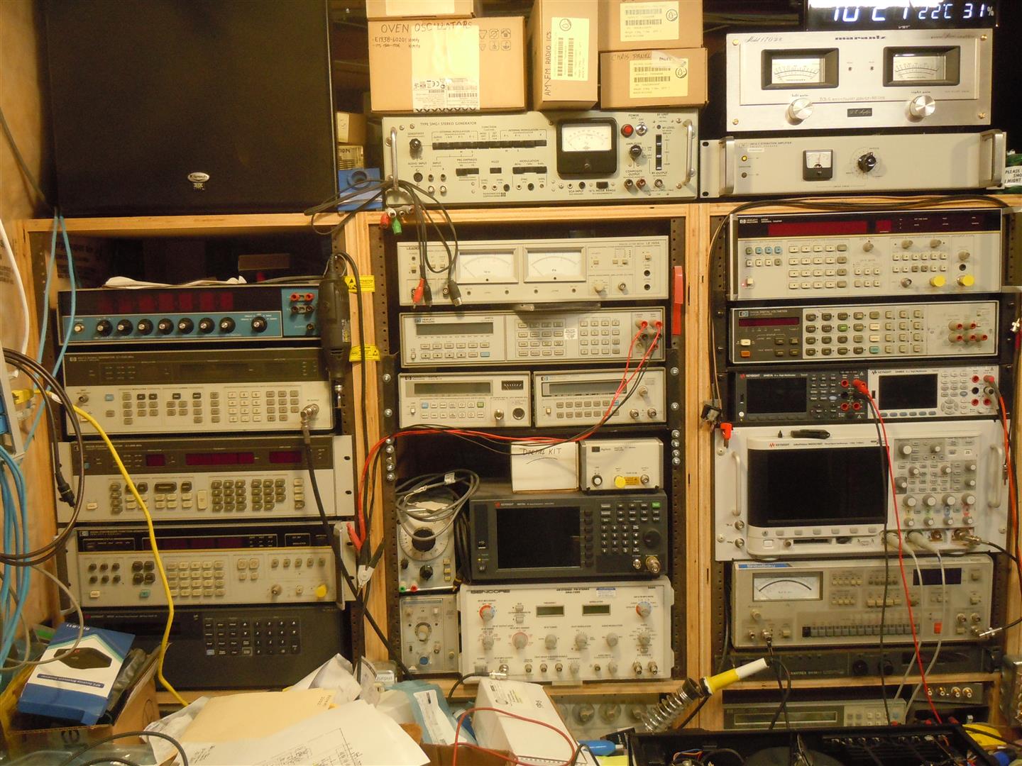

Well, you can't talk about capacitors without talking about test equipment!
On test equipment, I tend to look at it in terms of what can I measure and over what frequency range, and then try to plug the holes. Almost all of my equipment is old, but solid and reliable. I've yet to stumble onto a decent spectrum analyzer, so use the computer for that. Many years ago my bench was clean and looked like this-
There's a ton more stuff you can't see, mostly for component measurements.

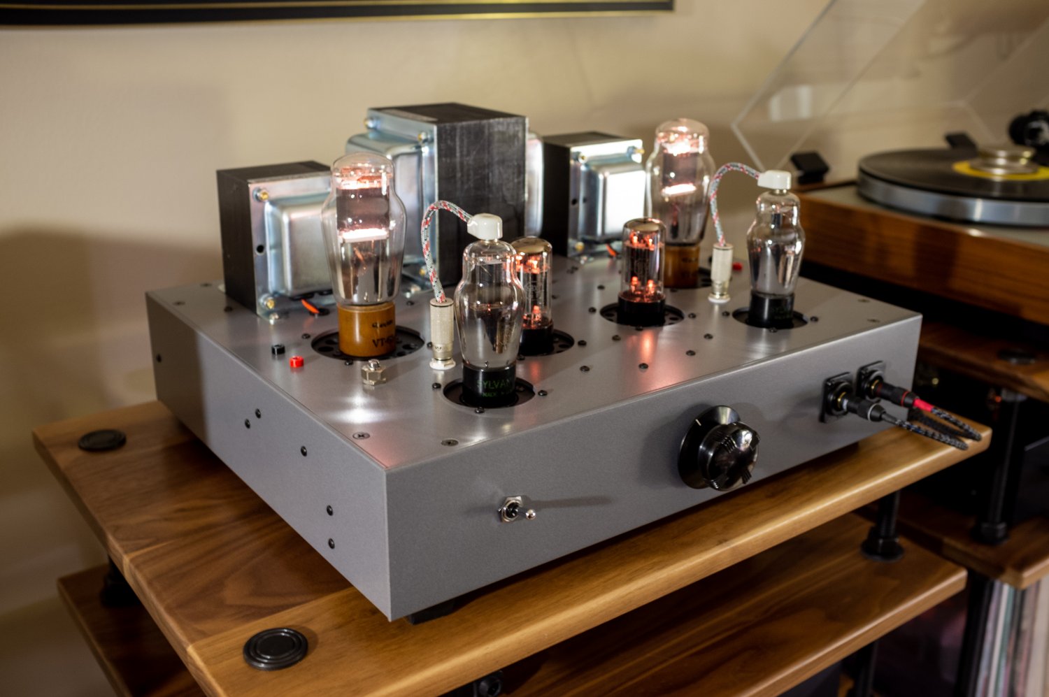

@iplayforme I started in this hobby in earnest at the end of 2019 and finished my first from-scratch design Q1 2020. I have no formal EE training, although some of my undergraduate coursework helps (math, physics, chemistry). Regardless, I think you can accomplish a lot as a hobbyist in a short period of time with the motivation and a singular goal in mind. Getting started, one needs to learn the hands-on skills to build, then the theory to design. For the former, a good DIY kit might be the way to break the ice. For the latter, books tailored toward the goal you hope to achieve in your first project along with asking questions to those with experience and are willing to share. I think you have plenty of time to learn and build something great!
I have now designed and built several tube amplifiers, a tube phono stage, a NOS DAC, along with a number of smaller projects along the way. Of the things I've made, this might be my favorite, an 801A single-ended triode design running in class A2, Sowter transformers. If someone had showed this to my 2019 self and told me I was going to build it, I would have laughed in their face.
Keeping things semi-relevant, it uses Jupiter copper foil coupling caps on its input (due to a mixed battery / cathode bias) as well as between the 6F5 input stage and the parallel-section 6BX7 cathode follower which drives the 801A grid positive. I've had good experiences with these caps, I use them when I'm feeling like something fancy as they are somewhat pricey.

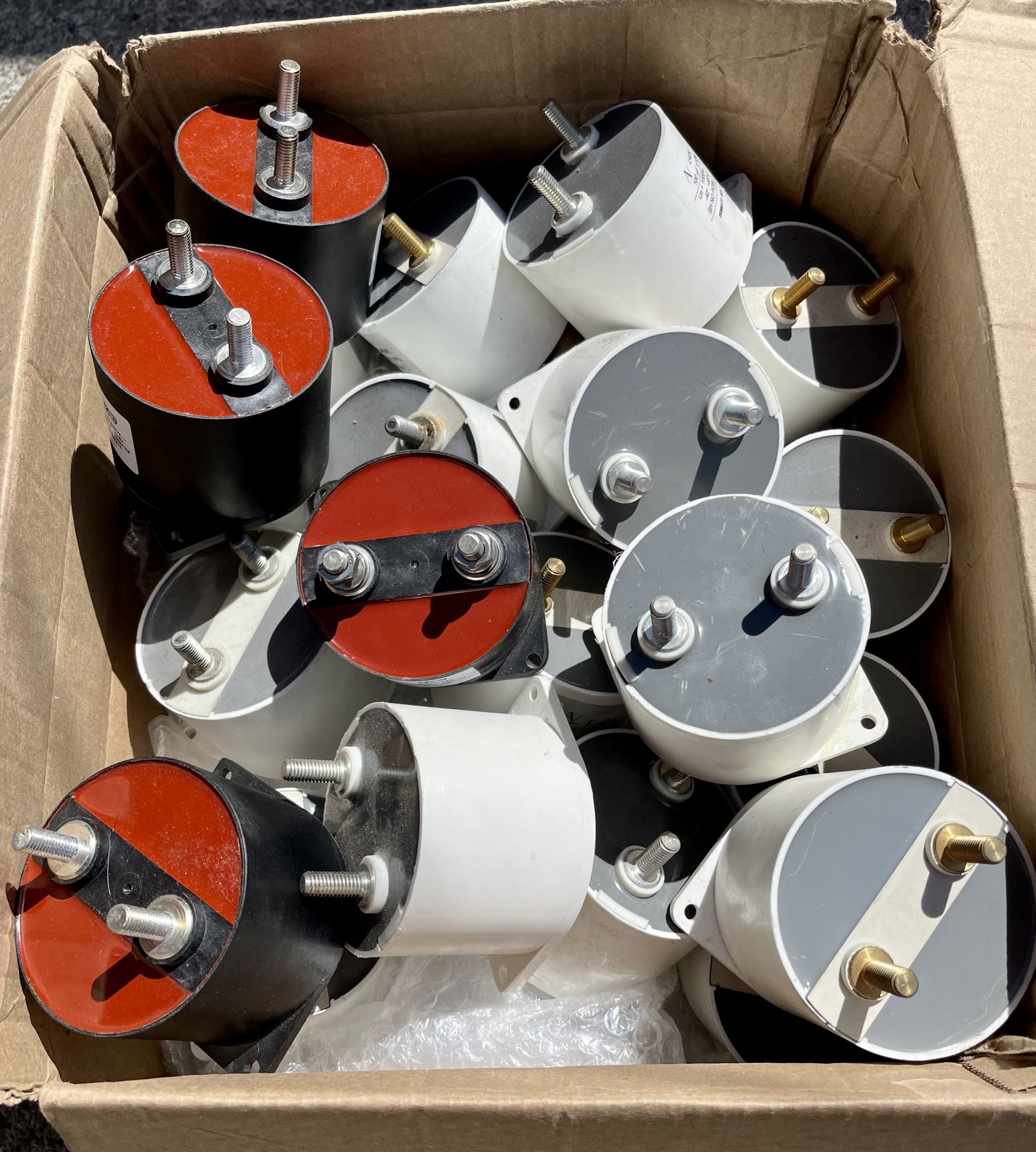

An assortment of HV 100 & 220uf film capacitors:
Mostly because film caps are very susceptible to the peak currents found in a power supply, you need foil caps rated for far higher currents than you would expect. Electrolytic capacitors are actually perfect for that application. You can (and should) use local bypass caps if you are worried about HF impedance.

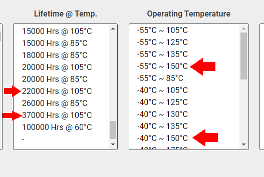

Mouser's parametric search tables will tell you which capacitors are rated for the longest life, at the widest possible temperature excursions. Copy down the part numbers and search all your favorite suppliers for the lowest price / best availability. Or let octopart.com do this for you.

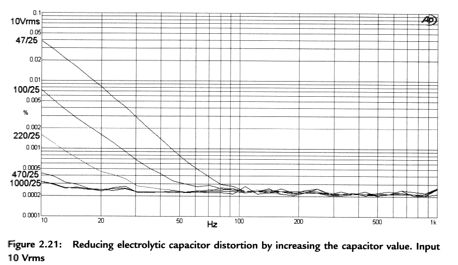

Douglas Self's book Small Signal Audio Design, 2nd edition covers that topic pretty extensively, pp. 63-75. Including lots of distortion measurements. One of his figures is below; it tells you that when a polarized electrolytic capacitor is used in an AC coupling application, distortion is unmeasurably low, if the capacitance is at least 100 microfarads per RMS volt of signal amplitude. So when the signal amplitude is 10VRMS or less, a 1000uF electrolytic has unmeasurable total harmonic distortion.
There are other curves for other capacitors, and I found it a delightful read.

Thanks! I did not know that. I have heard, and perhaps read on these forums, that the flaws of electrolytic caps reduce with increasing voltage ratings. That certainly seems to agree with my experience. Will have to test the “increase the capacitance” theory.
