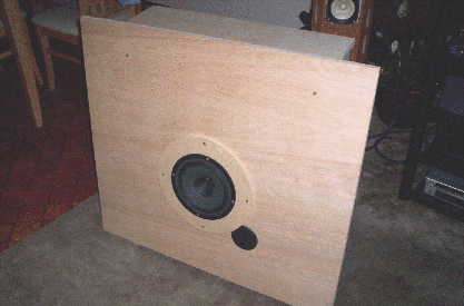

Start with the tweeter, I advice getting a pair of the Isophon HM10's which can be had for about $35 off ebay. I am using a series cap of 0.8uf for crossover - no padding necessary and they will be rolled in at around 10khz. Try different cap values until it sounds right. You may need to experiment with series padding resistors (1-4ohm to start with) but this will alter the crossover frequency so its a matter of trial and error till you get it right.
The bass is a little more complex since you need an inductor to do the crossover and it difficult to know the appropriate value until you start experimenting - and they are expensive. I advice looking into aperiodic loading (leaking sealed box) for the bass bin as it avoids the need for a pair of 12-15 inch bass drivers per baffle which is what it takes to run them open baffle.

Shoog thanx so much . My First question is how to cut off the bass just for now so i can listen as i build... and just one more question I saw some place that the baffle should be a little less than twice the diameter of the given driver ? I first had these in a 48"x48" baffle and thought they sounded nice Then I ripped the plywood and made "folded baffles" for better imaging but i guess the loss of bass over came that idea. Scott

One OB design that people seem to like is the Eminence Alpha 15A mated with a Fostex FE-87E. The crososver should be at about 200 Hz and the baffle size should be 20" wide and 38" tall. Total cost is below $400.
Try starting with a pair of recovered inductors from a sealed box speaker. Simply place it in series with the woofer and then this speaker inductor combination in parallel with the main driver. Should get you started.Shoog thanx so much . My First question is how to cut off the bass just for now so i can listen as i build... and just one more question I saw some place that the baffle should be a little less than twice the diameter of the given driver ? I first had these in a 48"x48" baffle and thought they sounded nice Then I ripped the plywood and made "folded baffles" for better imaging but i guess the loss of bass over came that idea. Scott
My baffles are about just less than twice the driver width. There is an exact calculation to work out the cut off frequency of the baffle depends on the baffle width. Do a search for an OB calculator in google, 18" works out at about 400hz, which means the woofer should be rolled in at about 300hz to avoid a bass hump where the main driver and woofer meet.
