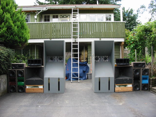

These did a fine job with rock - scary actually - compression drivers from 100 cycles up , three 18" horn loaded subs below - quadamped
Magnetar said:These did a fine job with rock - scary actually - compression drivers from 100 cycles up , three 18" horn loaded subs below - quadamped
With all the respect - I don't see myself putting those boxes in my living room.. So, can we stick to something that is reasonable?
Something, that doesn't ruin living space, as well sounds decent?
BTW - I kind of decided to try my luck building Eton 11.2 kit. If you know I'm making mistake - "speak now or forever hold your peace"
tamosius said:So, can we stick to something that is reasonable?
Do you have room for something like the 825 boxes with the horn on top? I can hardly think of a better speaker for rock, especially with the updated gear in them.
LOL..
I feel so lucky I'm not your neighbour..
BTW - their size probably is the reason why they are outside, isn't it?
