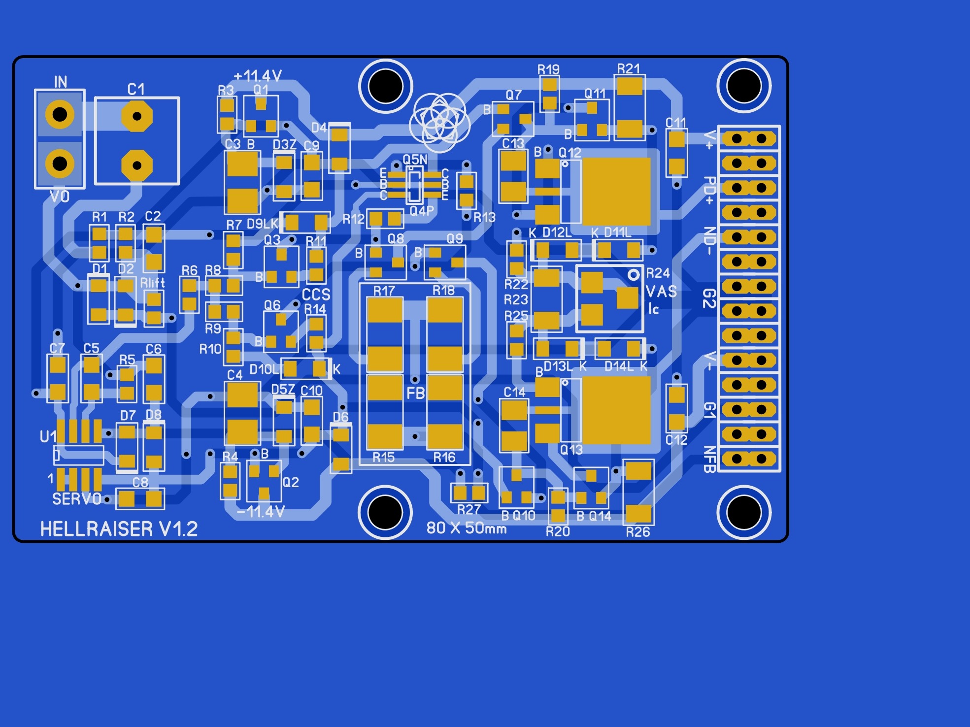

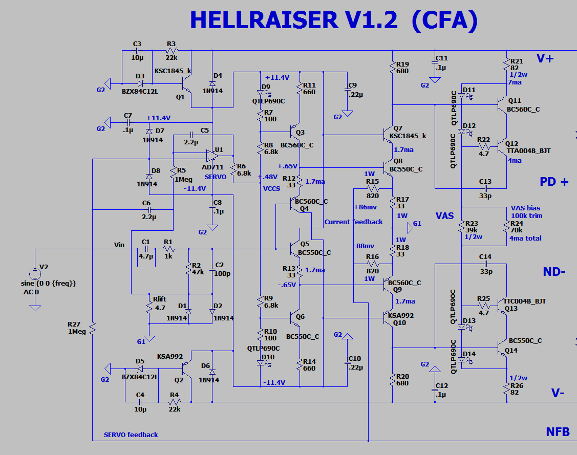

Did you ever try amplifier with basic current drive / cfa amp?
That's going to be my new amps. I have the case ,PS's, softstart , and protection. Like the wolverine , but I wanna try the "Hellraiser" CFA/servo/Hawksford
(soft valve like clip) design. I built the similar circuit back in "slewmaster days" - so , I know it works (well).
BTW , it fits Wolverine output boards and "arcwelder mini) EF3's. Real cool circuit... 5pom - won't beat a wolverine in thd , but might sound better in a mid sized party amp. "Spookyamp' is the same symmetric "Leach type" amp - same Hawksford and servo.

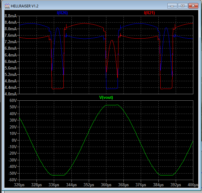

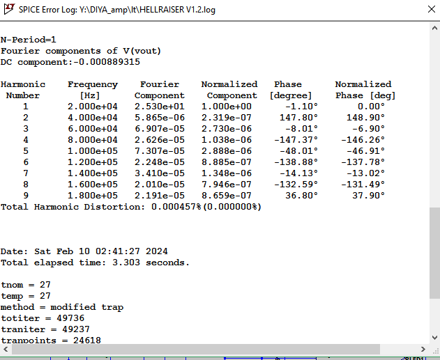

Here is the Hawksford VAS , no design is like it besides "ye olde Nikko" 70's integrated amp. I hammered subwoofers with it 10 years
ago .... red leds flashed at overload. All forum designs are either bootstrapped/current sourced VFA's - NOT like this.
Edit - It "acts different , as well. THD slowly rises from 4 to 10PPM right up to clip. 4R and 8R are the same ... and the CFA is SO fast that
NFB can correct the class AB output crossover "glitch". 20mA AB bias gives the same THD as the optimal 70-100mA setting.
