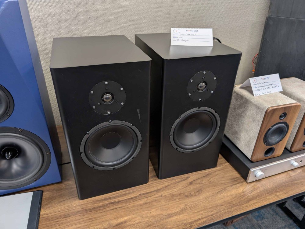

If I were to pick a couple of my recent designs that are inexpensive and that sounded fantastic; they'd have to be my Zingers and Pangolins. Zingers are more fun, and the Pangolins are definitely more detailed and sensitive.
If we would look at recent designs with a little higher pricing;
Drottnar was great too but really needed a woofer to help the bottom end. Very clean.
Purveyor (I hear the Peerless woofers will again be available soon) was pretty good alone and easy to build.
Bottleships stomp outside their size class. Don't know on the woofers on this one.
We'll see what and how my Hancocks do in the near future, as the drivers are not ubers and should be good.

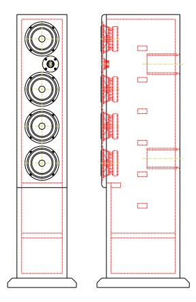

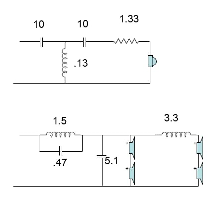

Here's a MTMMM 830656, "I don't Like Candles" by MattK PE Forum (no graphs, no measurements)
Build this with the (4) 830656 & ND20FB
http://www.zaphaudio.com/ZA5/ZA5.5t.pdf
-looks like a small Elsinore
Madisound Peerless 830656 sale $15 usd x8= $120 usd
https://www.madisoundspeakerstore.com/approx-5-woofers/peerless-830656-5.25-woofer/
Interesting, this speaker uses four Peerless 830656 & Dayton ND20FB-4 , simple crossover, you don't need a router.
https://techtalk.parts-express.com/forum/speaker-project-gallery/38135-i-don-t-like-candles
https://techtalk.parts-express.com/...rless-mtmmm-and-mmtmmmm-2-5-way-designs/page2
post#18
mattk, "I used Zaph's ZA5.5tt crossover topology (see http://zaphaudio.com/ZA5/ ) as a starting point in PCD, since he knows what he is doing, and adjusted values to get a reasonably flat response with a good reverse null."

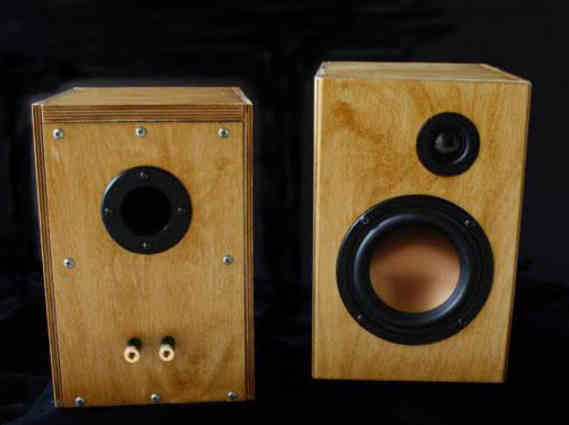

The "Armadillo TM" A.K.A. "Lil' Dillo's" 830656
I decided to do the first ones in a 10 liter (.35 cu ft) ported cab, lined and fairly well stuffed, with a tuning around 55hz.
The overall dimensions are 8" W x 12" H x 10.5" D with a 2" dia. x 5" long port (15.707963 in3). The sealed version Would be about 6-7" deep and heavily stuffed. A single dowel brace to tie the sides together seems adequate with 3/4" panels. The woofer and tweeter are 6" and 2" from the top edge of the cabinet, with the tweeter flush mounted and the woofer surface mounted. The port is recessed into the back panel 1/4" and glued in, with a 1/2" round-over on the outside end.

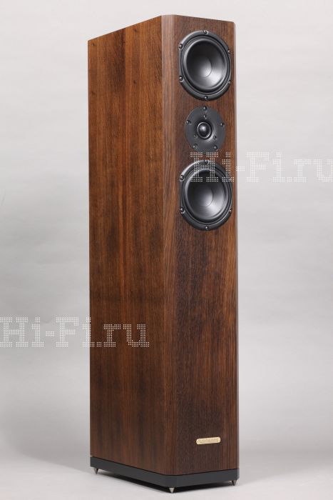

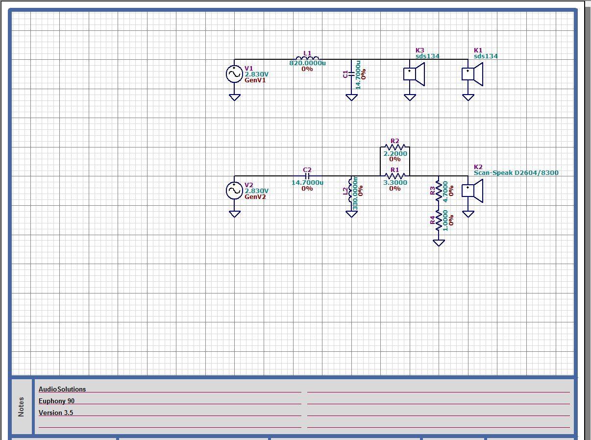

830656 & ScanSpeak D2604 MTM Commercial Speaker Audio Solutions Euphony 90-Russia
https://www.hi-fi.ru/magazine/audio...sticheskie-sistemy-audiosolutions-euphony-90/
-Poland
https://diyaudio.pl/forum/praktyczn...-audio/22745-audio-solutions-euphony-90-clone
https://diyaudio.pl/forum/praktyczn...e/home-audio/23246-kopia-euphony-90-by-daniel

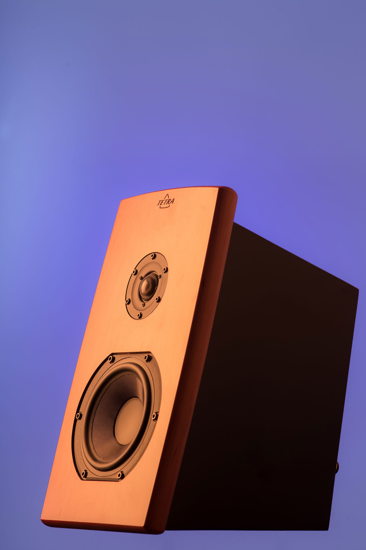

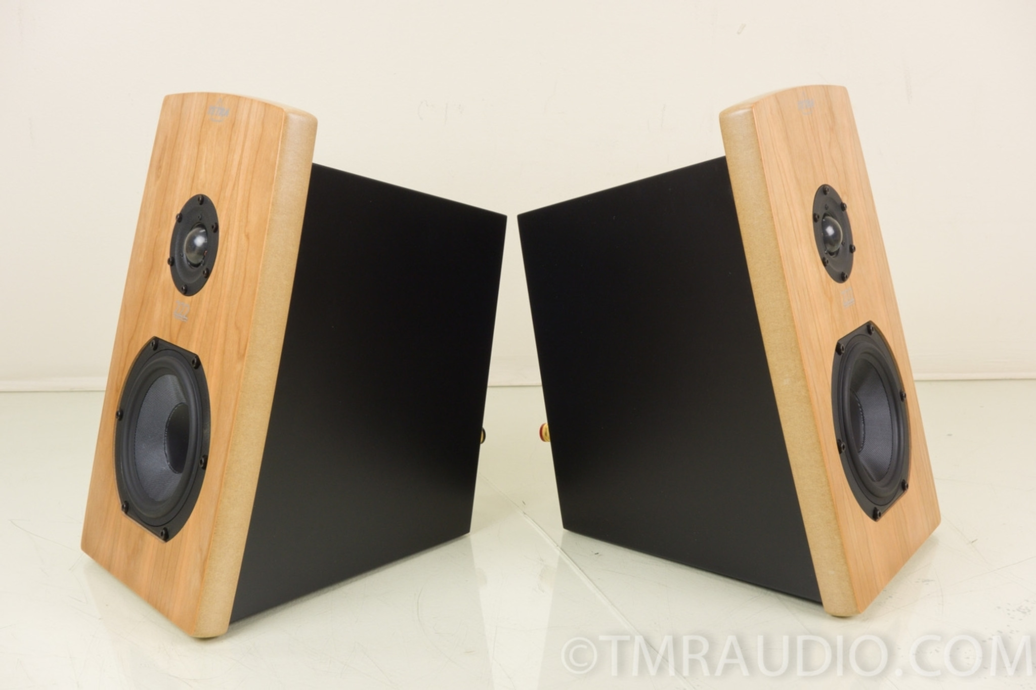

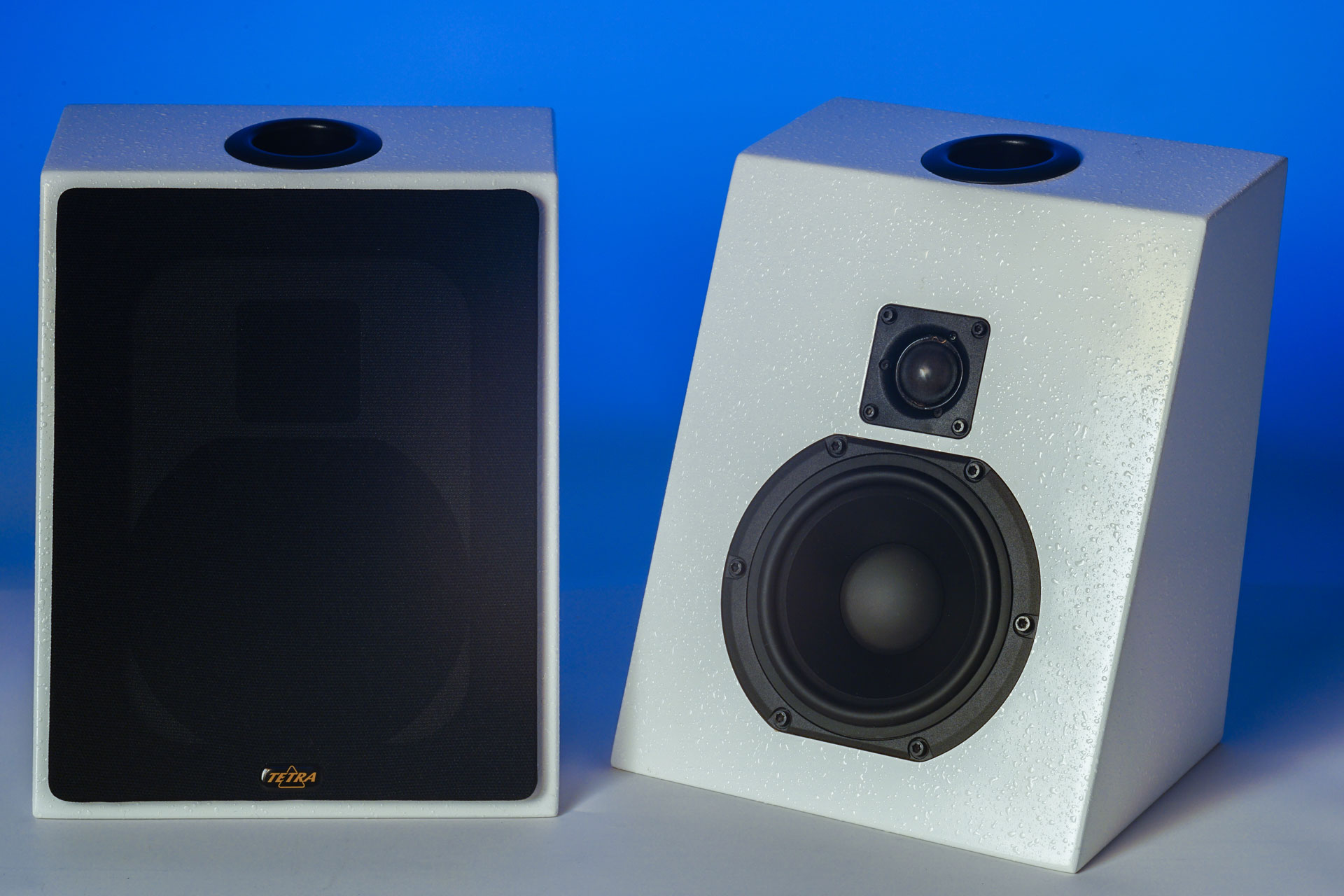

Tetra Speakers 222 & 120u (I've never heard them or heard of them)
Tetra 222
from Tetra:
"With our patented single-cap Artet wiring, our innovative air-scoop baffle and our tried and true plane alignment, we have left no sonic stone unturned in the 222 design.
Crossover frequency 3 kHz
Woofer 5" Peerless Glass Fiber Cone, Rubber Surround
Tweeter 1" Morel, Textile Dome Diaphragm
Looks like: 1 cap, Morel ET448 , Peerless GFC 830991, angled cabinet (extend the baffle bottom or put spikes on the front bottom on a regular box)

Tetra 120U
from Tetra,
"utilizing only a single proprietary capacitor on the tweeter ensures that every musical nuance and explosive detail gets through and provides you, the listener, with a 'Tetra moment.' (Sales Pitch,ooo ahh)
Woofer 5" Peerless Polypropylene Cone, Rubber Surround
Power handling 200 watts per channel
Weight 8.5 lbs (4 kg)
Dimensions 10.5" H x 9" W x 7.5" D (27 cm x 23 cm x 19 cm)
Looks like: 1 cap, Peerless 830860 poly cone , Morel MDT12

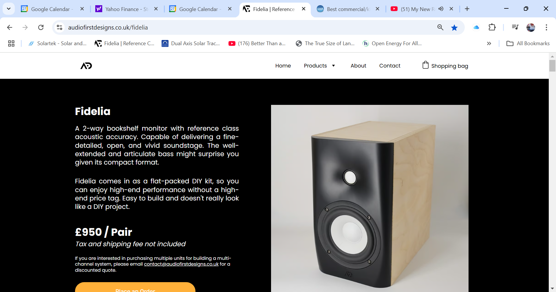

I know I may be reading too much into it but even though Erin calls it his "new reference", I don't see him talking about enjoying listening to them the way he has other speakers like the Lintons.
With the Lintons he talks about listening to song after song and that the more he listened to them the more he enjoyed them.
With the Fidelias he says they are 'tonally accurate' and 'linear', he never says they are better to listen to than speakers three times their price he just says they are more tonally accurate than ones three times the price. He does say they 'sound fantastic' and maybe the fact that they can't get that loud is the only thing that rules them out as his speakers for pure listening enjoyment.
Even his subjective praise was mostly about how technically impressive they are, rather than listening pleasure. I guess technical performance should equal enjoyment but I'd like to hear that in the subjective part of the review.

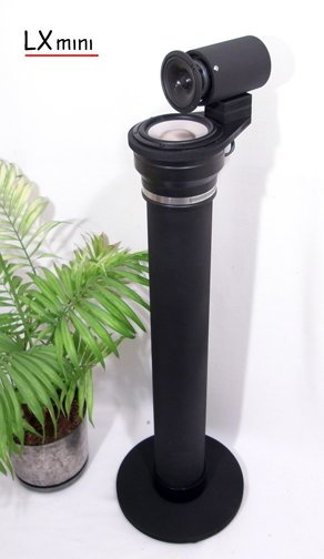

For something completely different there is the LX Mini.
