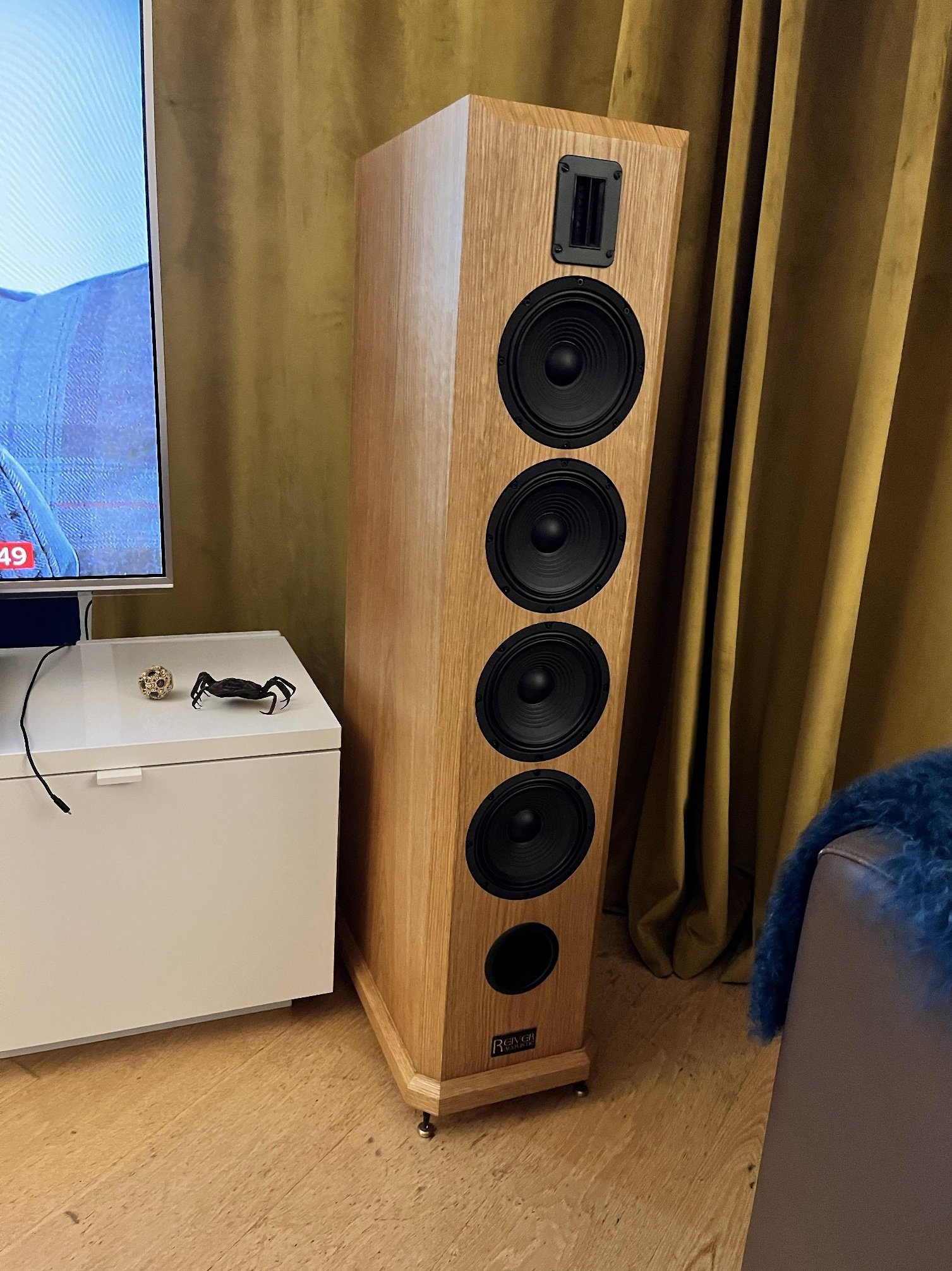

Avalon DIY , Dayton Audio drivers
FYI-
Google Translate
https://translate.google.com/
Drivers: Dayton Audio RST28F-4, RS52FN-8, RS270-8
https://linhkienloadai.vn/products/loa-davalon-boi-maybelle-audio
https://linhkienloadai-vn.translate...uto&_x_tr_tl=en&_x_tr_hl=en-US&_x_tr_pto=wapp
https://linhkienloadai.vn/collections/mau-thung-1
Crossover @ 10:30-11:00 first video
https://maybelle.com.vn/diy-loa-ava...-su-dung-cu-loa-cua-dayton-audio-nd80938.html
Crossover. Cabinet?
