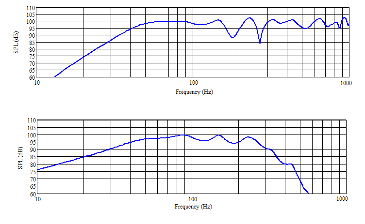

I get the impression that these Double back loaded horns have a small mouth area.
The top mouth is effectively operating into open air, whereas the bottom mouth is coupled quite effectively to the floor giving a mixed 4Pi and 2Pi loading.
Is this effectively a truncated horn?
What will that do to the LF response?
Termini rather than mouth. Which in particular, and compared to what? If you're saying that sans room boundary loading they're not impedance matched down to the 1/4 wave cutoff frequency, then of course they aren't, and nobody ever pretended otherwise. We are all of us are constrained by the laws of physics. 😉
For the free (forward-firing) ones on the FH site, mostly correct, albeit somewhat dependent upon the height of the ceiling. For a typical 8ft UK ceiling for example, the upper terminus does pick up some assistance, albeit less than the lower, naturally. The main objective of such designs is to achieve a relatively large total terminus area compared to shorter enclosures of the same footprint and basic configuration. They do offer some other interesting characteristics that some people like, and partly fall into the subjective catagory. As may be expected, the creation of the 'soundstage' (I don't like the term, but it suffices) is somewhat different -most people seem to find an increase in the height and depth perception, as might be expected given the configuration. Whether that is thought 'real' or partially a contrivance (although as all home audio is technically a contrivance, we're in the realms of how long is a piece of string) is a matter for the individual. We all react and percieve things differently, so I leave people to make their own minds up. What I can say is that while they are not to all tastes, the various designs on the FH site have proved quite popular over the last decade or so, and the small number of people who have built enclosures from my Woden site have all liked them to date, which is the important thing as far as I'm concerned. If you haven't heard a back-horn using one of these configurations, it's worth it, if only for the sake of interest
Depends which you're talking about. There are quite a few. The ones on the FH site, yes, obviously.
As above: that depends which you're talking about. For the FH-site designs, they do not have a perfectly flat response, although since < c. 300Hz the room dominates system response for all speakers (notwithstanding heavily EQ'd nearfield line arrays with large amounts of DSP, which have their own issues like all loudspeakers) they've plenty of company on that score, and better off than most shorter back-horn designs of the same configuration & footprint. I can live with that. That was the main object behind them. For my Woden site models, which are specifically intended for boundary loading -the attached. They are impedance matched down to a much lower frequency -how much lower depending on the specific positioning &c. Under optimal conditions, almost down to the 1/4 wave cutoff frequency.
